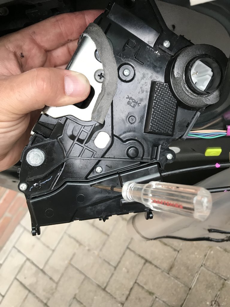

    I finally got around to checking the driver side door lock out. I ended up fixing it but some of you might think its not the most professional :) I don't think there is any other way to fix it without spending some money. I will not go into detail about removing the interior door panel because there are some pretty good videos on youtube that can do a better job than me.
    I removed the door handle, then pulled back the plastic liner and removed a metal plate that I did not take a picture of but is easy to figure out. It is the plate that covers the bottom hole in the second picture.
    I then removed the three torx screws that hold the door latch in place (they are size T30) and unplugged the connector to the door latch.
    It takes some twisting to remove the door lock assembly from around the window rails but is not too complicated.
    The linkage that goes from the door lock toggle to the lock assembly was all intact so I figured there was a problem on the inside.
    As you can see the bottom linkage is the one that connects to the lock toggle on the door handle and it is not attached. From what I can tell it was supposed to snap into the plastic piece but I think this is a very bad design. My fix for this is pretty simple, I used some small wire to wrap around the linkage and the plastic lever.
    Reinstalling the door lock assembly was a little more complicated because you have to align the rod that connects to the outside door handle and the rod that connects to the outside key lock before inserting the three torx screws but I found wrapping the wire around the linkage to be the hardest part and it went pretty smoothly.
