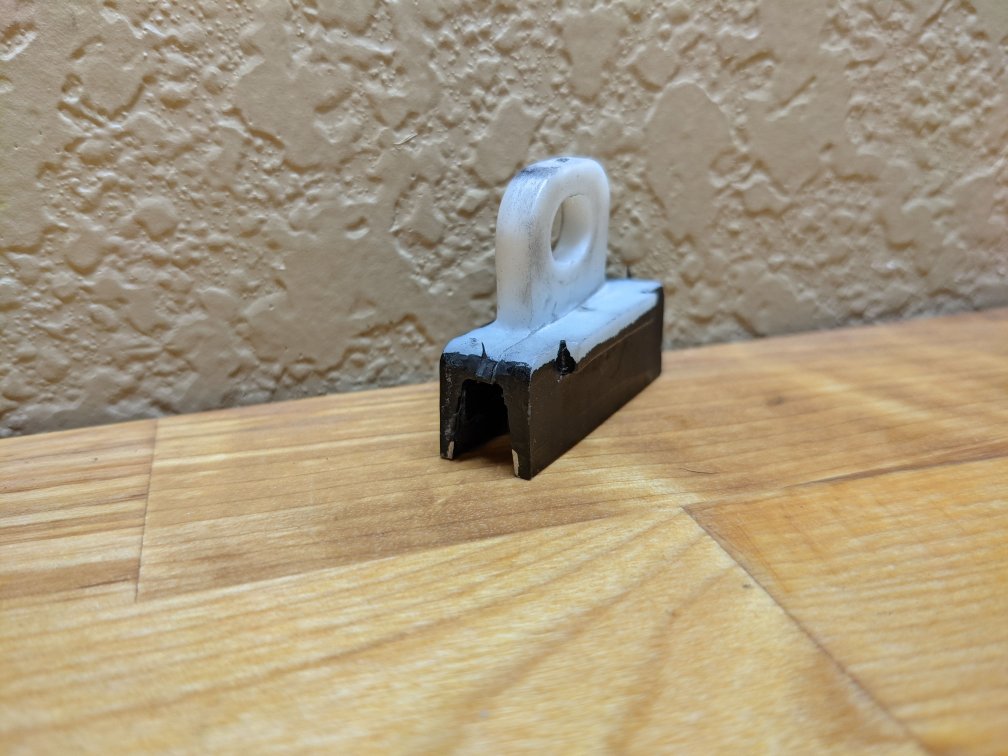

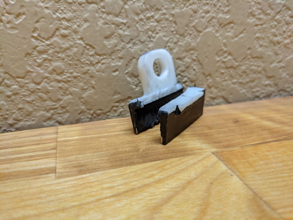

    Finally found some time to dive into this. Sure enough the plastic piece that holds the glass to the actuator was broken. Got the new one epoxied in and is functioning normally again.
    What it is supposed to look like:
    Where it broke:
