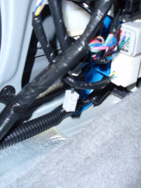

    I've got a 2011 access cab PreRunner TRD Off-Road and I installed the Toyota Sirius tuner today. The factory radio has the AM/SAT button and is the single CD model (model A by the owner's manual). I picked up the tuner (PT545-00080) and the Sequoia fit kit (PT545-0C081) for a good price from the TW marketplace. I decided to go with the Sequoia fit kit after I read some posts saying 2011s don't have the satellite harness prewired. I also sprang for the Eastwood master installer nylon pry tool kit and it was worth every cent. The first thing I did was to pull the driver's kick panel to check if there was a harness, which there wasn't.

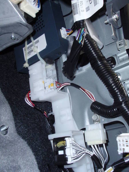

    The next step was to pull the glove box and passenger kick panel to figure where I could place the tuner. I ultimately settled on zip tying it to the plastic connector frame that is right behind the kick panel. I used some pipe insulation to pad the bottom and back of the tuner to prevent rattles.

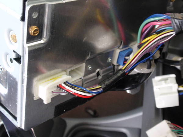

    I pulled the radio and routed the harness from the tuner along the wire bundle that runs the length of the dash. There was only one place on the back of the radio for the harness to connect, and I taped down the spare connector on the harness.
