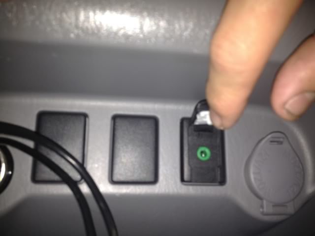

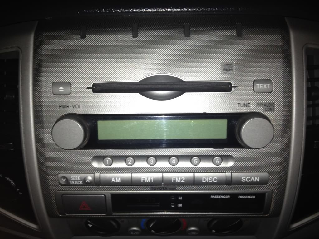

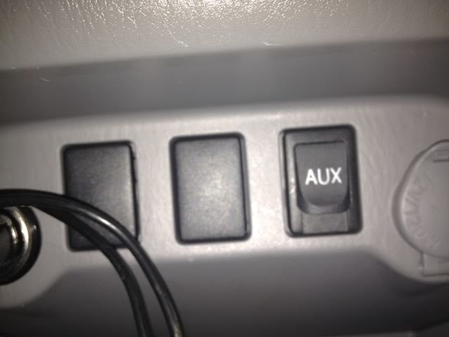

    Just picked up a 2011 4x4 TRD sport with the built in audio aux input jack under the stock radio. Problem is that on the stock radio it is supposed to say "Disc AUX" (according to the manual.) But it just says "Disc".
    As a 2011, was it supposed to come standard with a functional aux audio input? What do you guys think?
    I've tried plugging in a good AUX cable and it does not automatically switch to the mode. I've also tried pressing the DISC button multiple times with no results.
    I'll be taking it to the dealer tomorrow to see whats up and if I can get a warrantied replacement. Unless this is normal for a 2011....

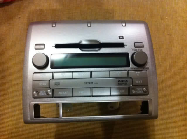

    I have the trd off road 4x4 so pretty much the same but heres mine

    just tried it... pressing mode on the steering wheel just cycles through AM, FM1, FM2

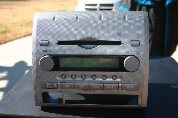

    looks like you have the 05-08 factory headunit. I think previous owner switched it out. 09-11 have the aux button.

    oh and its not normal you have a 2011 so its suppose the have the aux button on the stereo also wma/mp3 playback.
    05-08
    09-11
