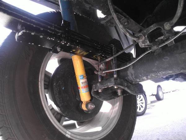

    Got mine done too. No problems from the dealership. Just told them its "harsh" under load. They looked at it last Friday. Parts came in Monday. Put em on today:
    Felt fine on the freeway.
