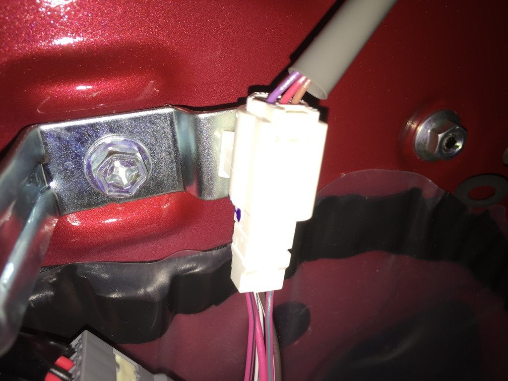

  2. Jan 2, 2015 at 10:55 PM
    #22
    tacomaep

    Im bringing up this old post because I am at a stand still with this mod. Please, if anyone can chime in, I would appreciate it. I've read all the posts on this mod and I am stuck with how to wire up the turn signal lamps. I added sport mirrors on my 2015 SR5 Tacoma because I wanted to have the cool signal lamps on them. The above wiring diagram confuses me. I know that one of the wires will be the ground wire which I can easily ground onto a screw or something on the door, but the other wire or (power wire) I am unsure where to wire it to. I know that it will be on the fuse panel somewhere. Does anyone have pictures or clear instructions on how to do it? There has got to be someone on here that has just recently done it. Thanks for your help!

    If you have the sr5 it should be prewired for the sport mirrors , Just plug and play. I put the sport mirrors on my 2012 sr5 and no add wiring.

    On my '14, I took off the door skin and tested the factory harness with a test light. It does blink when blinker is on.
    Just installed. Was plug and play on mine.

    This is the wiring in my '15 SR5 DC, am I pre-wired?

    Looks like it. As long there is five wires on the bottom connector

    Hey guys, older thread bump. I have a 2013 Prerunner SR5 and based on the old posts, I should have everything needed. I bought all the parts and took apart my door panel. I have the same photo as in post #32 with 5 wires coming into a connector and then going to three wires up into my mirror housing. This is the part I am completely lost on.
    Do I just need to remove my entire mirror assembly and I should have the connection, or do I need to do something else? Sorry for the dumb question.
