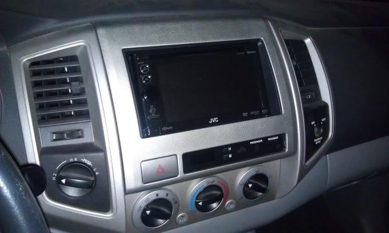

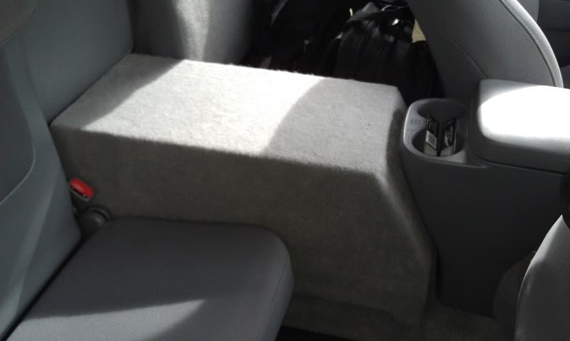

    I've got the KW-NT30HD head unit, Kicker solo-baric L7 (in a subthump.com box) powered by an Alpine PDX-M6 amp. For the doors, I threw in some JL Audio C5-650 components powered by an Alpine MRP-F300.
    I originally got intrigued by adding speakers to the rear. So much so, that I started looking for earlier door panels so I wasn't cutting up the stock, '09+ panels in my truck. After hearing my buddy's system in his '05, the rear speakers became moot. Most of my recovery gear and extra tools and shit for work reside in the rear, and very seldom do I ever have passengers that would be able to enjoy the speakers back there. I said screw it.
    I should note, i'm deaf in my right ear, so even having a decent stereo is a waste for me.
    Sorry for cell phone pics. Never got around to taking some decent shots.

    I appreciate the pics, I think it looks great.
    The box I'm planning on getting is made by the shop where I'm have the install done (10 inch Image Dynamics, downfire box).
    It's not terribly big, but with the storage bins in you can't really move the passenger seat back at all.
    But the guy at the shop said they could take the storage boxes out, which they've done before, but I have a feeling that previous years may have been different. I read a post on here where someone said you'd have a hole in the cab if you just removed the storage boxes without doing anything else.

    ninja what kinda dash kit is that?

    Can't speak for him, but the dash kit looks like a silver Metra to me...
