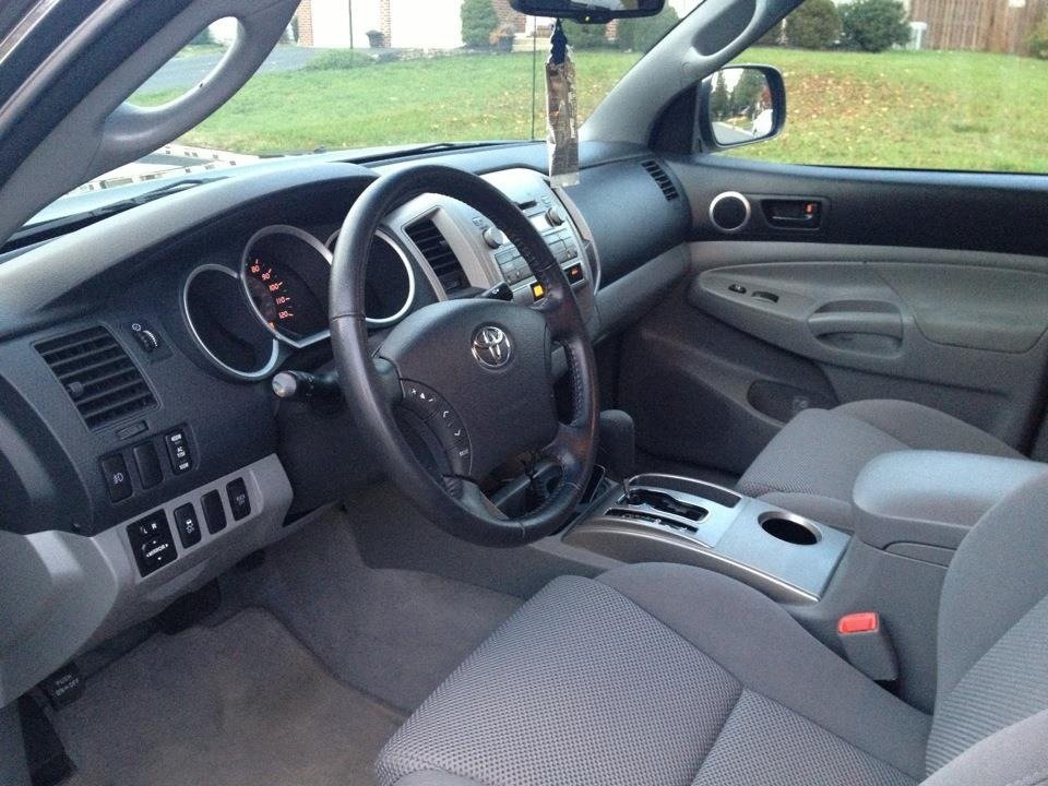

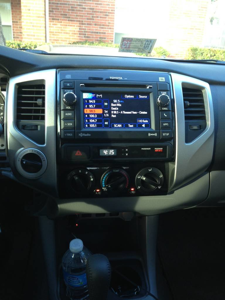

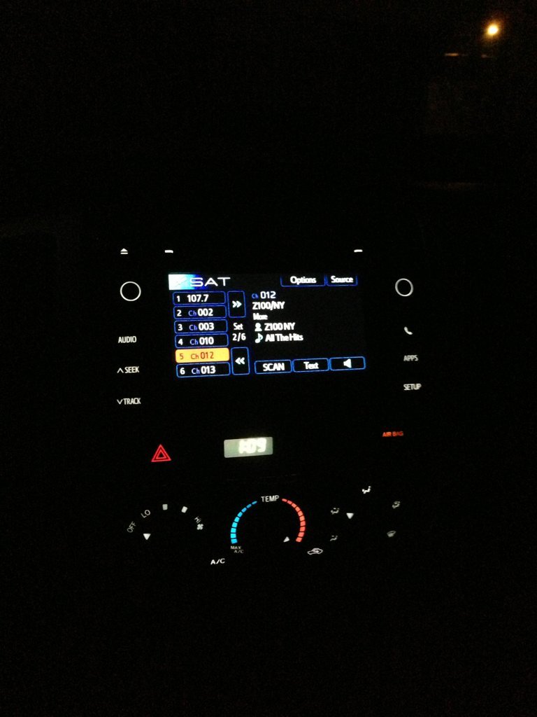

    For those curious, the 2012 climate control is plug and play in previous years, with the exception of one plug. See info below. I found a panel out of a wrecked Tacoma and installed it along with my entune project.
    WRITE-UP
    From this:
    To this:
    No more amber:

    Both. The silver face with amber lighting stuck out with the 2012 head unit and surround. The 2012 control has LED illumination vs the 2011 and below has amber colored plastic illuminated by bulbs. It's possible to change the illumination color with LEDs while the older unit you can't.

    leds are the plcc-2 just like the clusters about 5 of them for the background
    and 1 of the 0602 leds for each button
    but if you change the background, the blue and red of the temperature dial wont look good fyi
