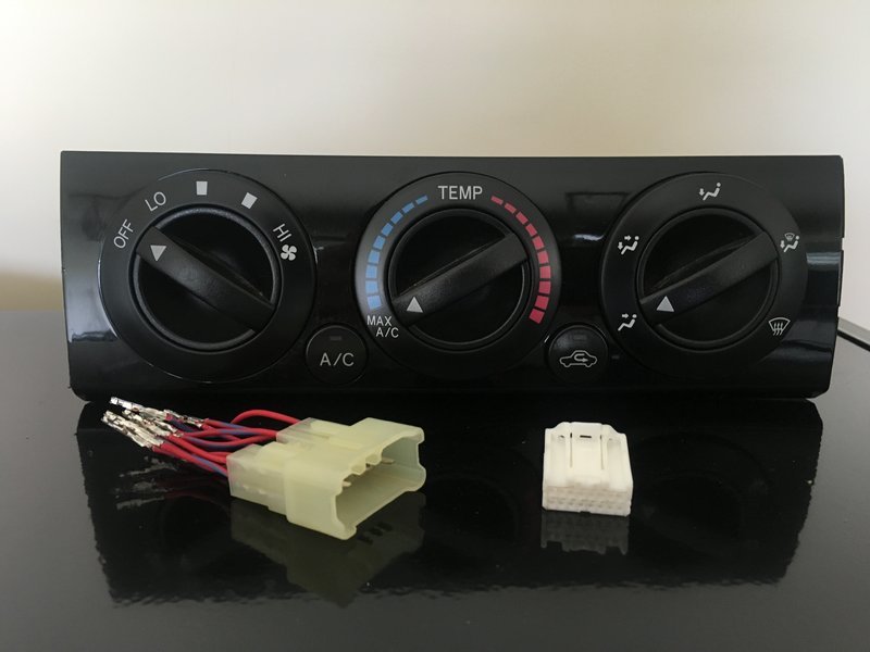

    So I bought the 2012+ climate controls and connectors needed to perform this mod but decided to just paint my original controls and was happy with it.
    Would anyone be interested in buying the controls and connectors from Eastern beaver?

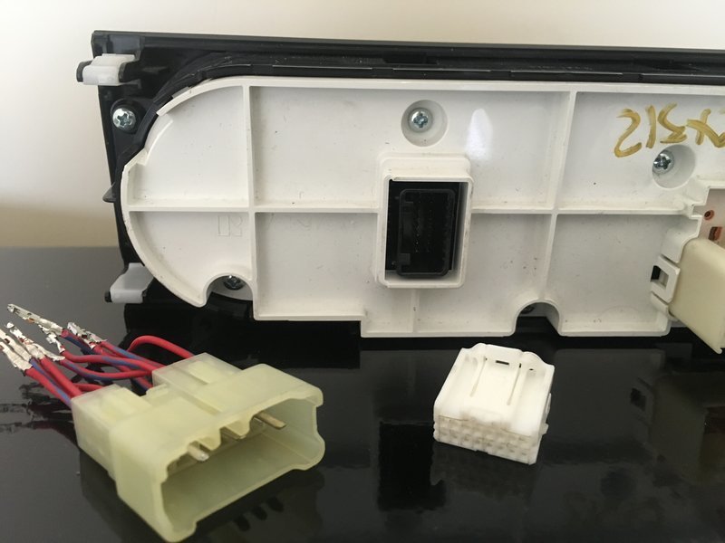

    These are the parts described:

    Thanks Steveh for the images. How would the wires connected? Do you have a copy of the wiring conversion diagram that can share? How much for the parts you have?

    Yes, PM me your email and I can send the actual diagram doc if the below link doesn't work...
    Well I paid $100 for the climate controls on eBay and $7 for the 2 connectors from Eastern Beaver.
    I'll do $80 shipped.
