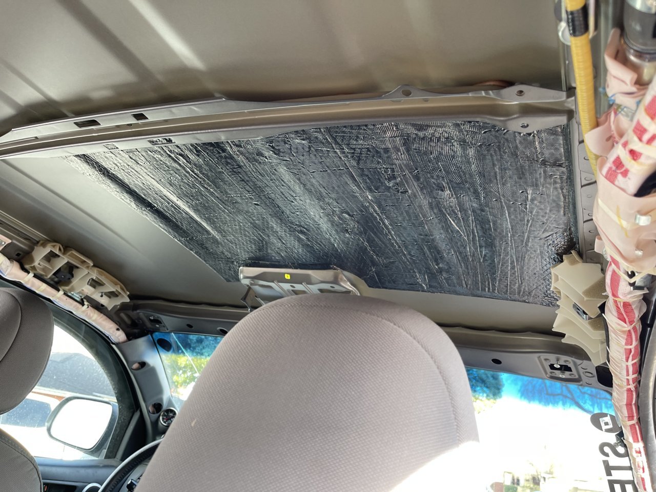

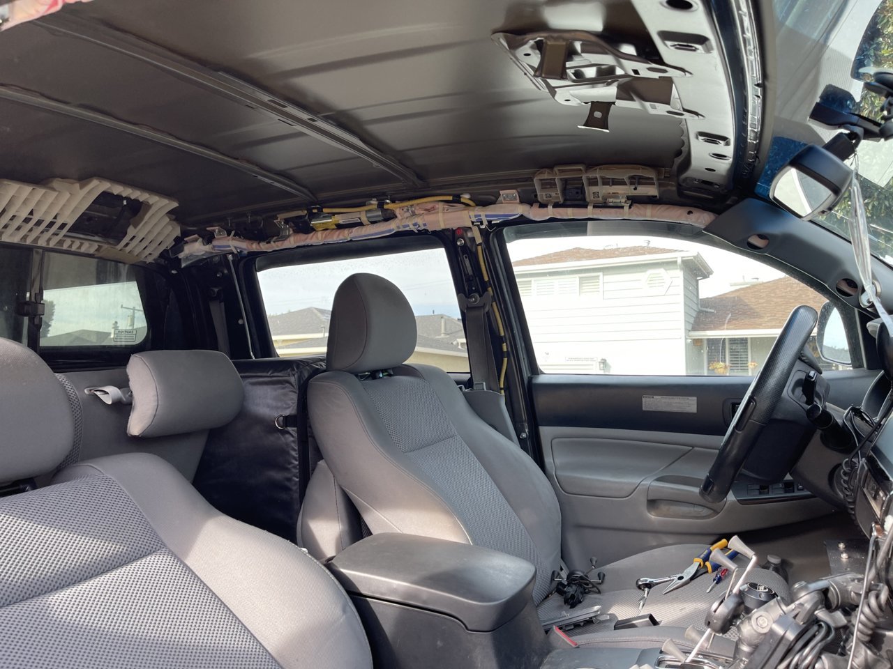

    Anyone wanting to pull it. Lay front seats down and it’s decently pliable. Came out fairly easy and good as new. No creases.

    What do you have going on in the headliner?

    Sound deadening for one. Contemplating changing the color to black as well.
    last I’ll be seeing what wiring I need to run for switches, camera etc so I don’t have wires everywhere in the cab.
    Tossing in some 80mm Noico and a layer of 150mm red on top.

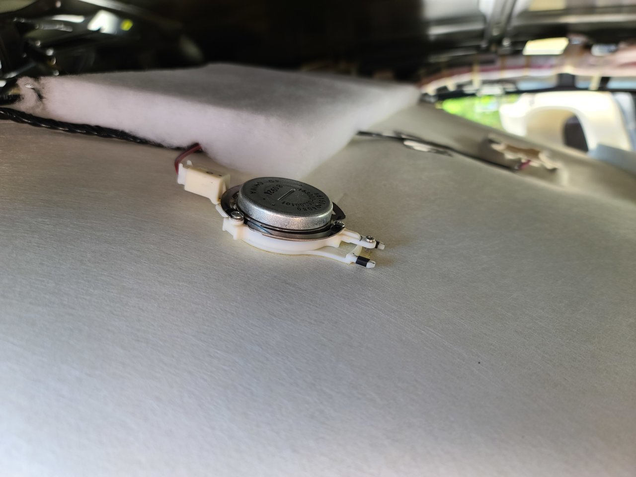

    Great write-up/thread. I've got a 2009 Access Cab which apparently has small cheap speakers behind the headliner. Just wondering if there's anything preventing me from getting some upgraded speakers to swap out. Any ideas on what speakers fit so I could have them before pulling the headliner down?

    If there is a speaker for the stereo or possibly it was for a CB or other com?

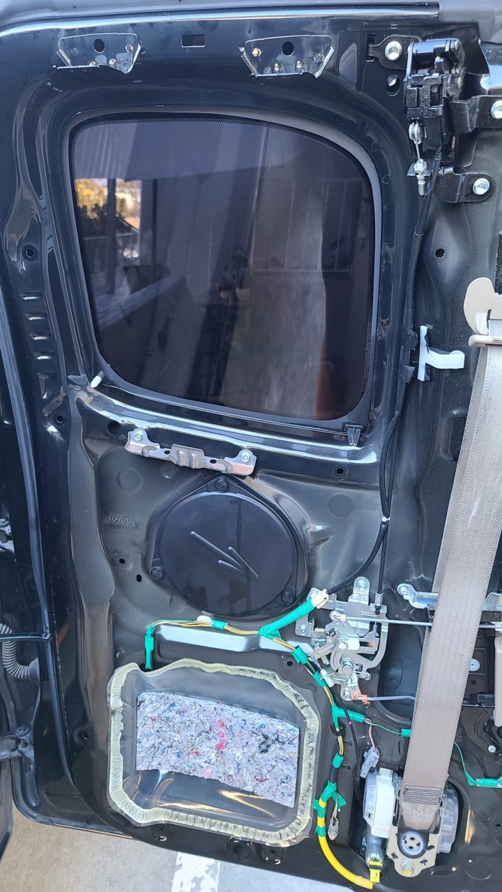

    IMO, you're better off throwing those in the trash and running longer wire to the access cab doors.
    There is two empty spots in each access cab door where Toyota use to put rear speakers, then cheaped out.

    Yeah, I know the rear doors are a much better location. Don't really want to fool with wiring and then having to deal with cutting the plastic trim since my 09 doesn't have speaker cutouts. Thought maybe there was a real speaker above the headliner that would allow you to put a 3-4" mid-high range speaker up there but after seeing the stock headliner "speakers" maybe I'll reconsider.

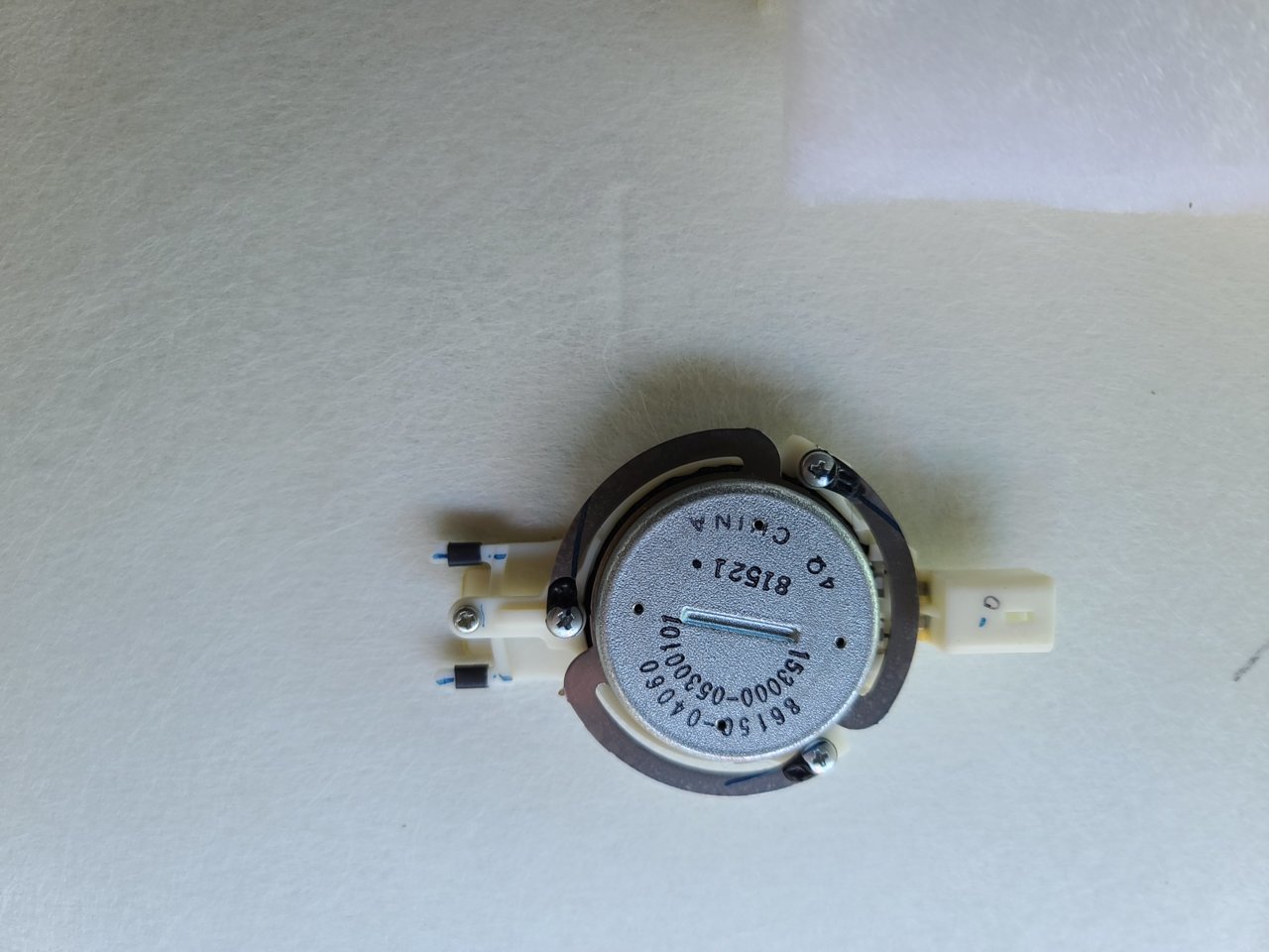

    I wonder if the speaker wire is there too. They tend to run stuff then never install.

    Those turds are trash. They stopped working 4 years into ownership lol. I'm guessing the wiring to it is just as bad.
    You know, I looked while I was in there and couldn't find a unused connector. If there is it's hidden extremely well.

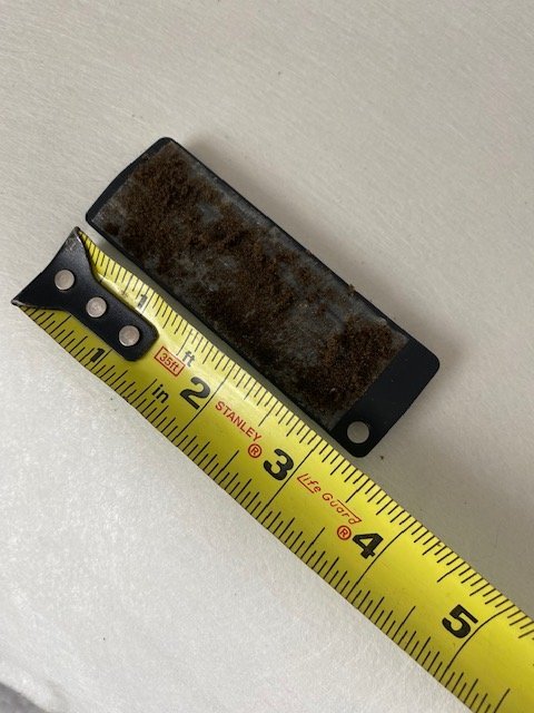

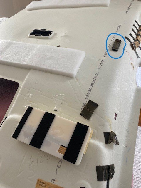

    Thank you for the detailed write-up on the headliner removal. I recently removed the headliner to determine where a water leak was coming from...found to be leaking from the top p/s of the rear window. When I dropped the headliner, I noticed a small black plastic piece had fallen from the p/s of the headliner. The d/s piece was still attached to the headliner (circled in photo). Before I reattach the p/s I wanted to ask what the correction orientation would be when installing and if anyone knows what it is. Thanks!

    these are just spacers pads for the headliner. So as long as it goes in and lays fine your good. Seems correct or you may be able to tell. I had mine out and some fell off i just taped them back on and putit back on. I wouldn't think too hard about it as its there to just give it space.

    That's what I was hoping for...thank you!
