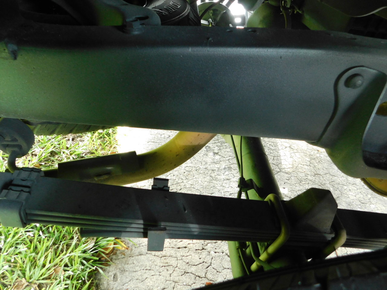

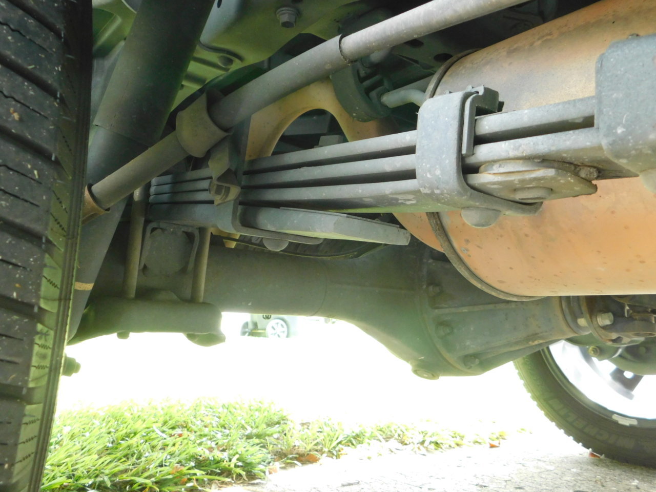

    But was not sure about the short leaf being an add on leaf or a factory setup. It looked like part of the factory tow package to me.
    I do know the OEM transmission cooler looks a bit wimpy. Others have said it won't keep up.
    So I have been looking at the ones that are outfitted with the temp sensor control valves. I don't have a known gvw yet
    but a little overkill on the cooling of the transmission won't hurt if it can keep the fluid happy in all manner of use.
    Anyway here are some photos of the spring pack...

    Your leaf springs look exactly like mine that Toyota replaced the originals with. Unless you are towing heavy those leaf springs should be fine.
