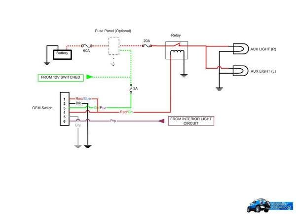

    Rich,
    Does the FJ wiring and harness come complete so after I get the Ebay Camry housings I could throw out the rest and just install the FJ package and modify the end connector?
    I'm not prewired but the luminated switch sound good, but what's the extra two contacts on the switch for?
    2012 SR5's are not prewired if you get the 4 cylinder at least on the East coast
    Thanks

    The FJ switch and harness is only the underdash portion and will not interface directly with the Tacoma harness.
    You'll have to cut the connector off of the opposite end of the harness from the switch and then wire it as you would any aftermarket illuminated switch.
    Nice thing about the FJ switch is it not only has the dash illumination but also an indicator light. Stock Tacoma doesn't have the indicator.

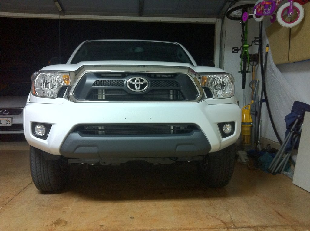

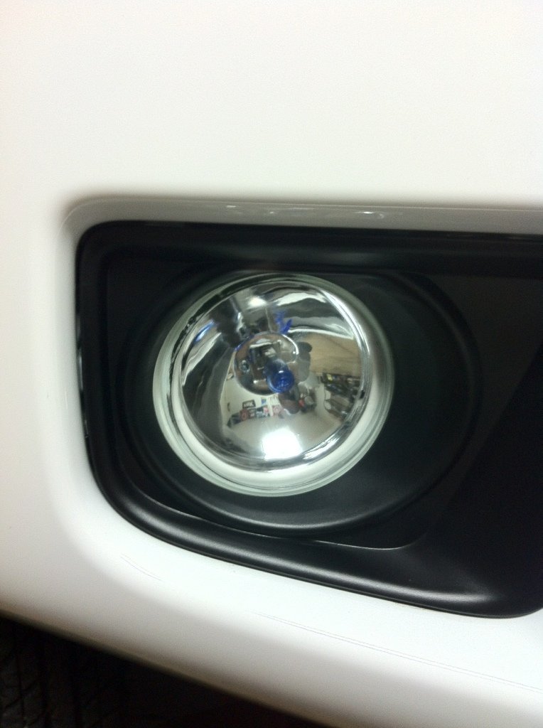

    Just finished the installation myself. Lights for 07-09 Camry went in without a problem. No mods needed to them. Was lucky enough that the relay and lights all arrived this morning so It took me all of 30 minutes to pop everything in once I got the light orientation correct. :D
    They look awesome, thanks OP and other contributors to turning me on to this relatively easy mod for those of us with the Factory installed Trailer package. It's nice having all the wiring already in place.

    Rich
    Can you tell me how you wired your FJ switch for your fogs I got a wiring diagram off the FJ forum. I'm not prewired just going to use an add a circuit off the radio fuse to power the switch
    No idea where I'd pull an interior light circuit for but I've got daytime running lights so my panels always lit thought I'd just wire #3 and #6 together
    Thanks for any help

    That diagram will work perfectly.
    If you don't care about the dimmer, you can run the illumination power to the 12v switched source. You can also pull power from the AC panel illumination... that does not come on with the ignition.
    Reason Toyota did this?
    The cluster is LED. It can run 24/7 no problem.
    The AC panel and fog light switch both use regular lamps.
    Running them 24/7 will have them burning out quickly.
