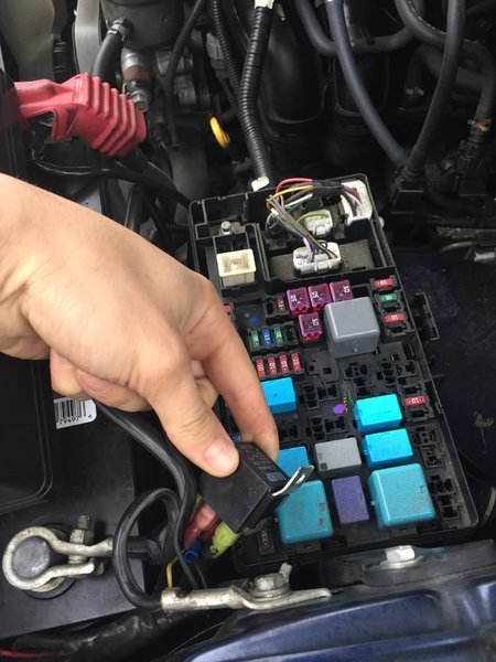

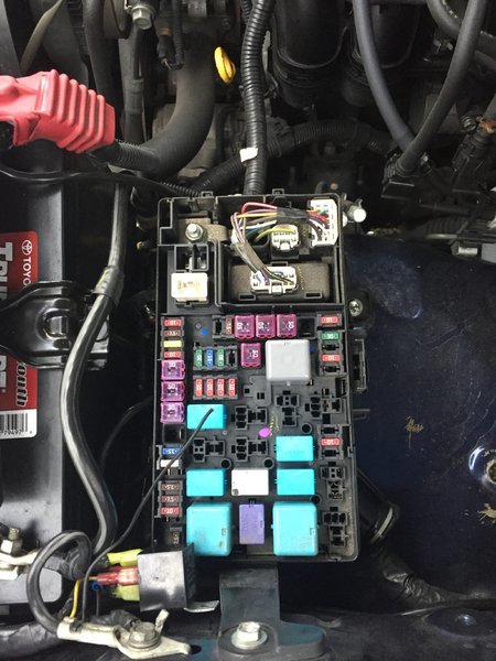

    Can someone explain how to do this mod, I don't have the second small relay box to the main one andcannot find a way to do the mod with my truck.
    2012 4x4 SR5 4 Cylinder Auto. I am so lost
  3. Mar 22, 2017 at 1:06 PM
    #123
    Bravisimo
    Bravisimo So many mods, very little money.
    Nov 17, 2014
    #142575
    665
    Joe
    Santa Clarita, CA
    2014 Tacoma PreRunner SR5 DCLB
    Tint, headlights wrapped & rear lights smoked, power outlet mod., grill & rear bumper wrapped, Falken A/T 3W,
    Got any pics?
  4. Mar 22, 2017 at 8:15 PM
    #124
    NickNickNick
    NickNickNick Member
    Nov 16, 2016
    #202595
    23
    Nick
    2012 Blue Ext Cab 4x4

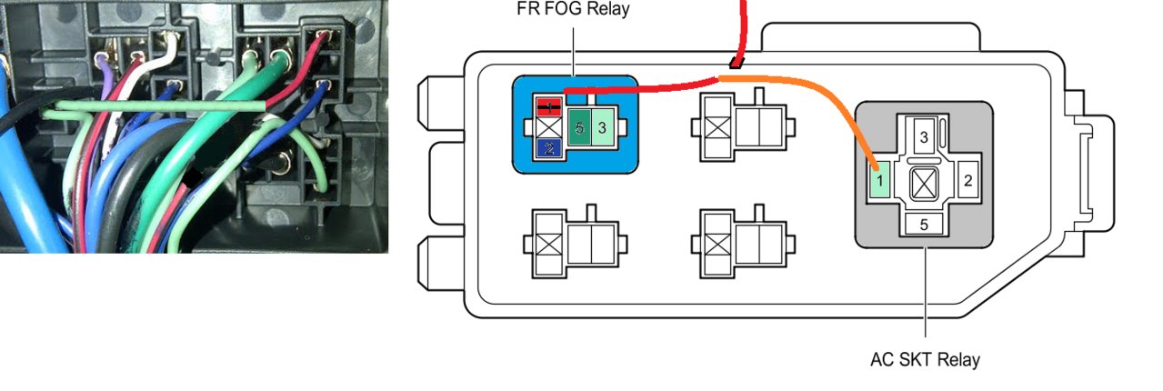

    I would like to direct this question to munkeeboi or anyone who has a 2014 with this relay configuration. I have a 2014 double cab and my relays are in the same location as the ones in your post from 11/17/2011, about the 2012 Tacoma. Can you elaborate for me exactly how to make these connections to the slots that you have circled in green, in the photo please.
  11. Oct 29, 2020 at 3:29 PM
    #131
    caribe makaira
    caribe makaira Well-Known Member
    Feb 13, 2011
    #51121
    11,817
    Caribbean, Puerto Rico
    05 PreRunner TRD Offroad AutoTrans
    Hood Struts, My version Fogs always ON, Map & Overhead Light Mod,
    Remove the Aux relay box from the main relay & fuse box.
    Remove bottom cover.
    Cut the red with black stripe. Tape and secure the harness side. Crimp a small male terminal to a short length of wire on one side and a union crimp on the cut red with black stripe wire.
    Wedge the small male terminal into slot 1 of the Accessory SKT Relay. Secure in place with tape.
    Test, then close it back up.
    If you have the seat heater relay then no need to add an additional length of wire.
