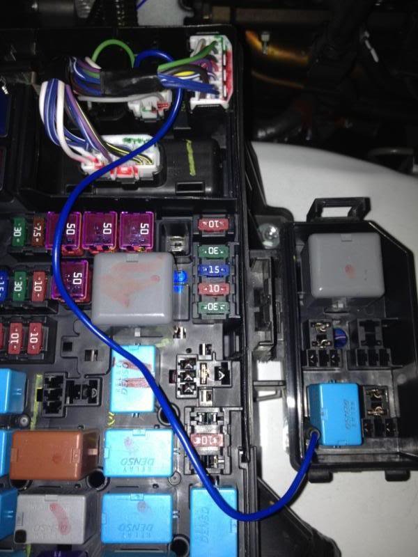

    I like this version of MB's for the 2012's fog light on with parking/low beam/high beam...
    Reminder that Tab # 1 is at bottom left corner of the FR FOG RELAY--
    See attached thumbnails--OLY

    Caribe makaira thought of even a cleaner way to wire it up for 2012 tacos.
    There is no need to run the wire out of the small fuse box where the fog relay is since there are already 2 slots that are wired to ign power. They are the #2 slot (circled in green) and turn on/off with the ignition so you don't drain your battery. Suggested you use an inline fuse (1A will do) for extra protection.
    So instead of running it to the Tail light relay in the large fuse box. just plug it into one of the available slots near the fog relay
