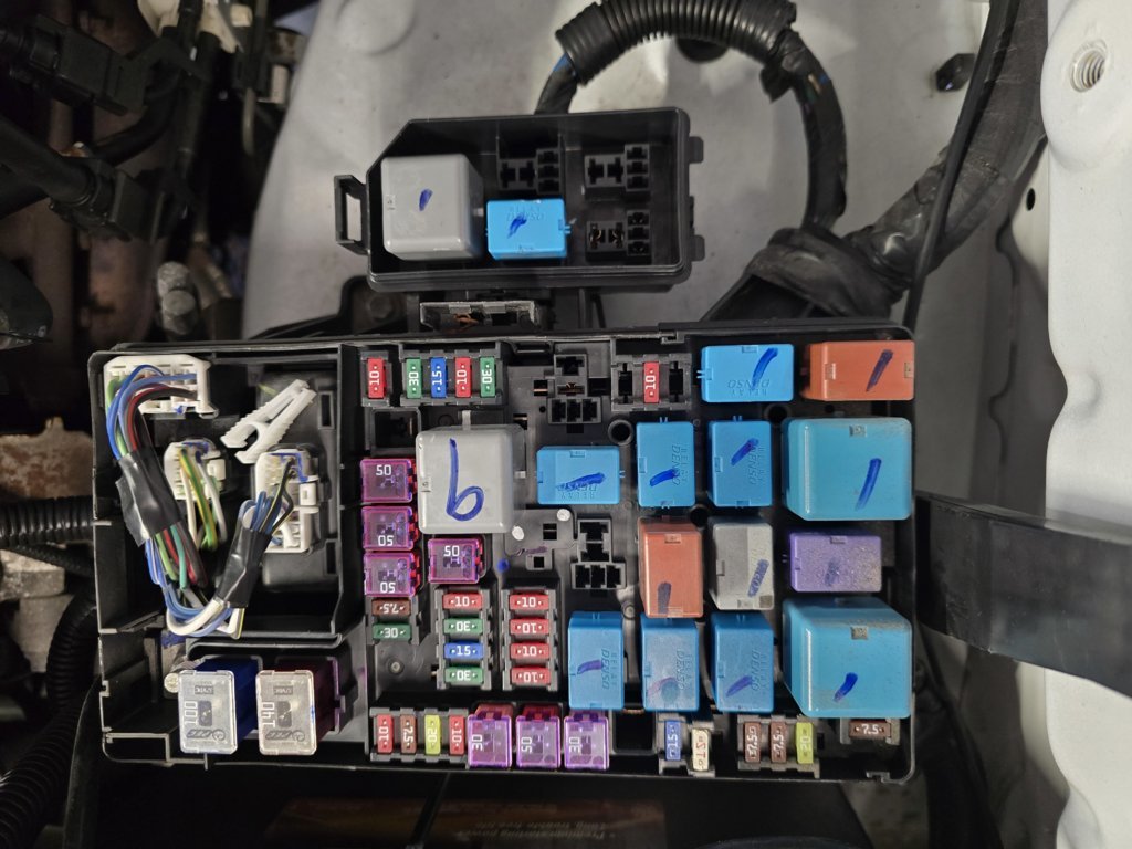

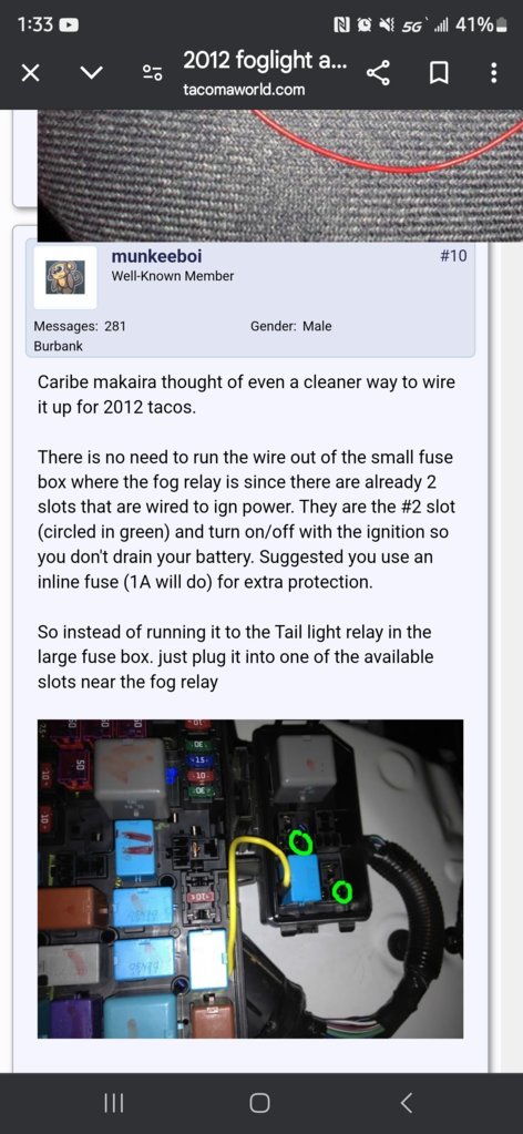

    Bringing this back from the dead in 2025. I have a 2014 TRD sport I'm looking to do this to.
    So far I've been able to connect a wire to the fog light relay with a female 16 guage female connector and run the raw wire to the bottom right terminal of the air pump relay. Shown in picture with green circle.
    Has anyone had any issues with this? I don't have any other options with using the small fuse box. I don't have any other wiring that runs into the empty terminals.
    I've read some people have their fogs kick on randomly? I really DO NOT want to cut any harness wires as I may sell this truck eventually down the line.
    Also added a picture of my current truck fuse box options.
    Thanks for any help
