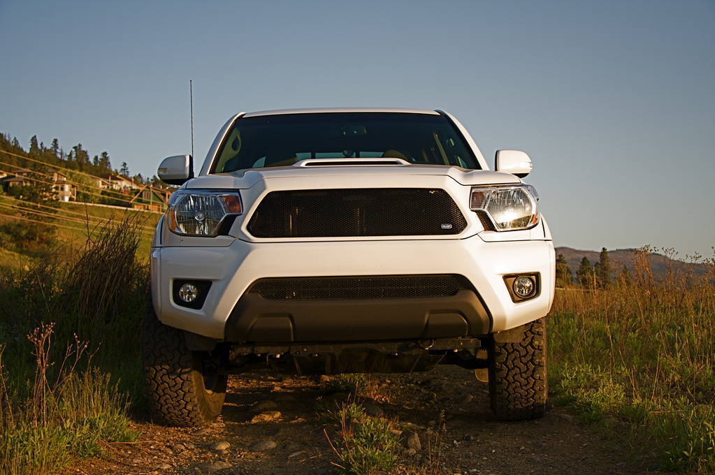

    Well, I suggest you go for it, here's upper and lower :)
    I'll upload more pics, with a write up and install tips soon!
    this shows how much room I left in the corner for install, I'd leave a tiny bit more of the black on the corner if I did this again...
    stock grille cut up, very easy with the 2012
    when you are taking the stock grille off, there are tabs in all these little slots you see on the top of the bumper, you just have to wiggle them out..
    other than that, paint everything behind the grille black while you have it off, including the rad and rad supports..

    looks sweet man. my old username was tacoman355 and my other truck was real similar to your 1st gen now we have identical 2nd gens, lol. Good taste :thumbsup:

    nice truck rab the grill crafts look sweet on there!

    rab, it looks great. cant wait to get mine.

    Thats a lot of money (>$350) for a grill that you have to install and cut open your old grill yourself. But it definately looks great!
