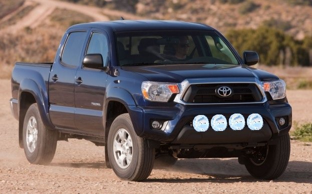

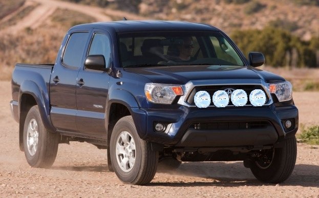

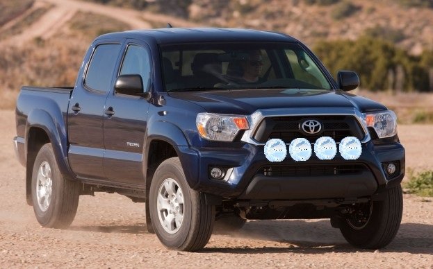

    Hey everyone,
    I am in the middle of developing a light bar designed to fit the 2012 Tacoma's. I have come up with a few ideas and am trying to nail down the final placement of the lights.
    What I am designing will have tabs for 4 Hella 700 style lights. While my photoshop skills suck (I used paint), I am hoping you can get the idea of what I am looking for here. I didn't even attempt to draw the light bar itself, just pasted some lights on for the visual. Please let me know what placement you like best so I can start making these for the 2012 community.
    My thoughts and pictures:
    - Tall - Obstructs air flow to the grill, not that these trucks have cooling issues.
    - Middle - This is where most are set from other companies. The lights still obstruct the upper grill just a little bit in this spot.
    - Low - I have never seen a light bar this low. The obvious issue is them hanging a little low, but I don't think they are in any more danger than the other two, still hanging off the front, and there is no obstruction of the upper grill, and wires are easily hidden here.

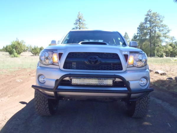

    Like this:

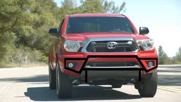

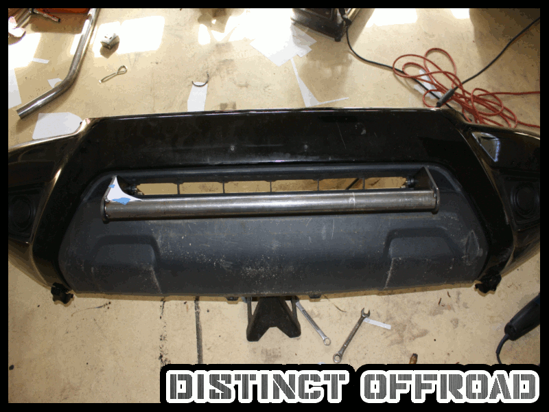

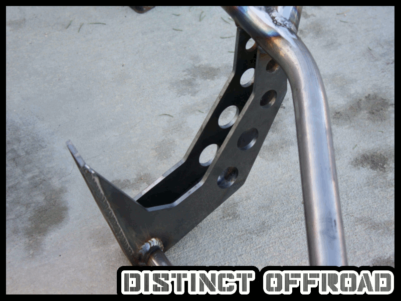

    What up guys. Thanks for such a great response so far. So it looks like most like them low or maybe middle. I have been working on an idea that will allow for you guys to choose either. It would go through the lower grill and then from there it can be placed one direction for middle lights, or flipped over for lower lights. I could only weld tabs on for one direction, but could offer both options. The only bummer with this design is that the lower grill is a little on the skinny side, so I am still toying with how I think it will look.
    The other option is to go for a lower only design, and have the mounts come up from below the bumper. This will allow for a wider bar that will actually match the edges of the black center piece. Both designs will allow for four lights, but the second is a little more flexible as far as types of lights because of the added space.

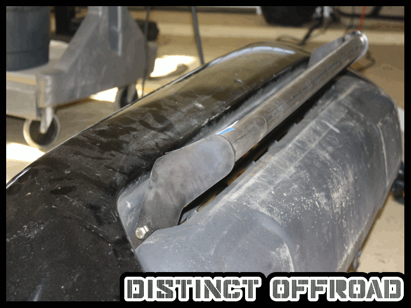

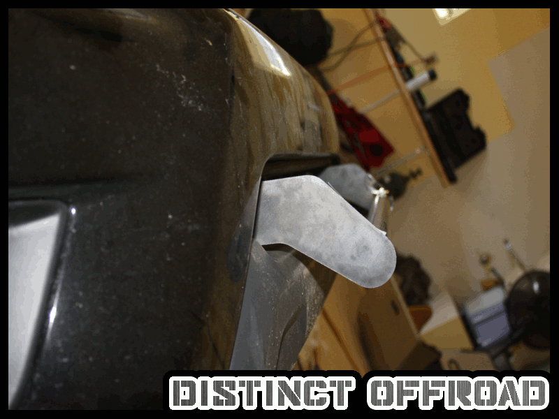

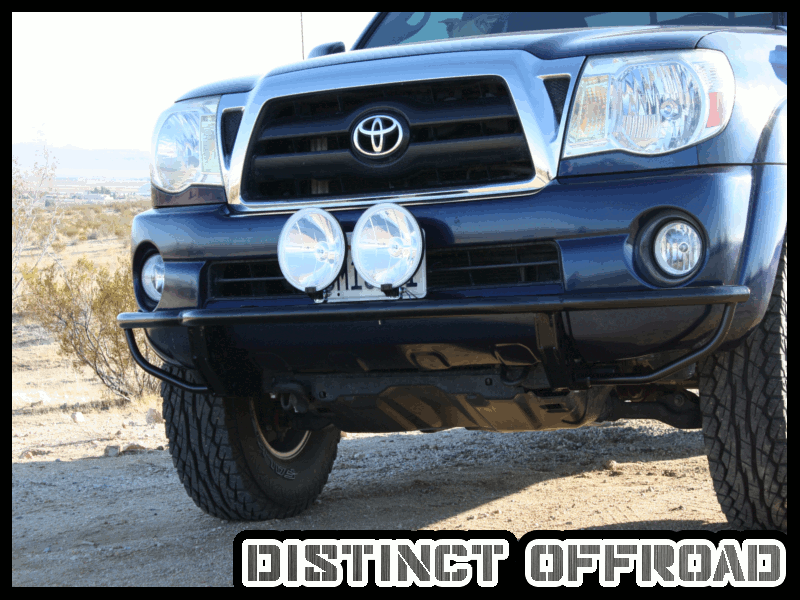

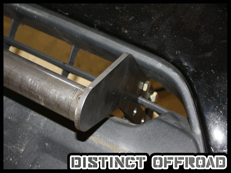

    Let me know what you guys think. Here are a few pictures of my 05-11 ones, would be similar but lower if it wen't through the lower grill. Also a picture for Desert Rat, I make those bumpers as well, and was thinking of doing a modified version for the lower only light bar I described above. Thanks guys!!!
    - Would be like this, but pointing downward for the lower light mounting like discussed above.
    - My Bumper design, and the mounts that I would use, not such a crazy one though, would only be one plate, not boxed like the bumper one.
