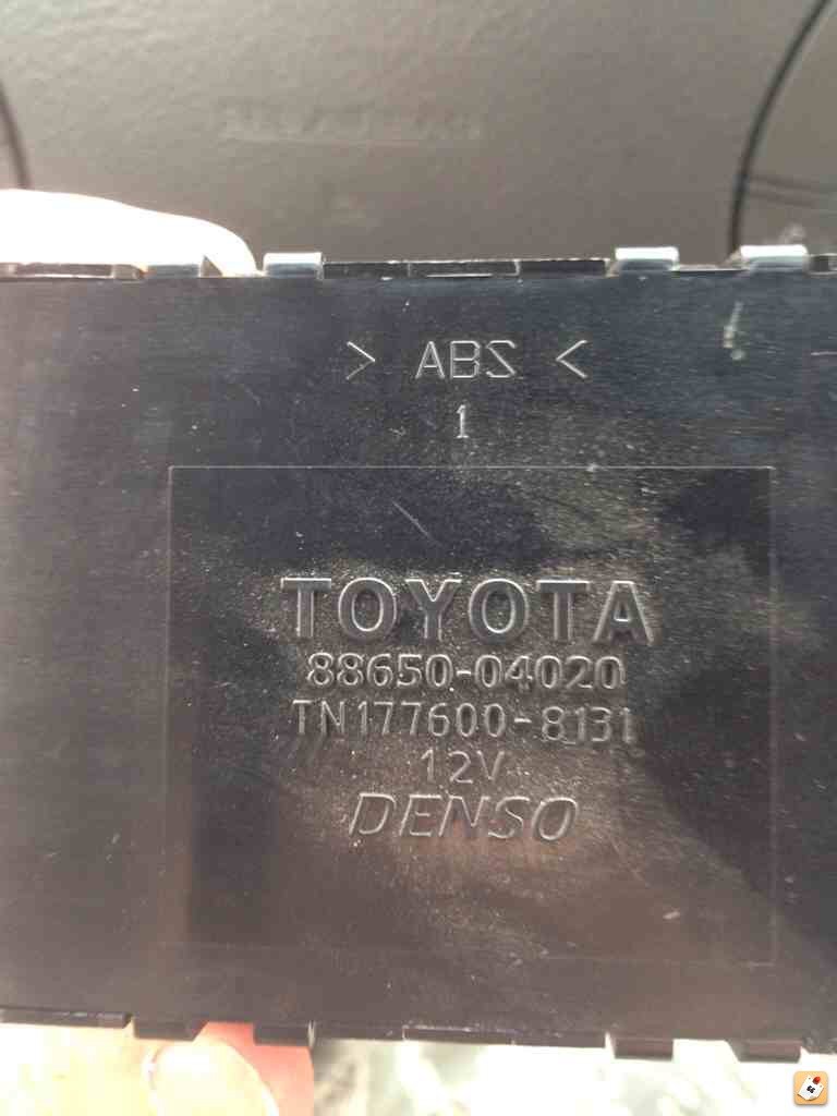

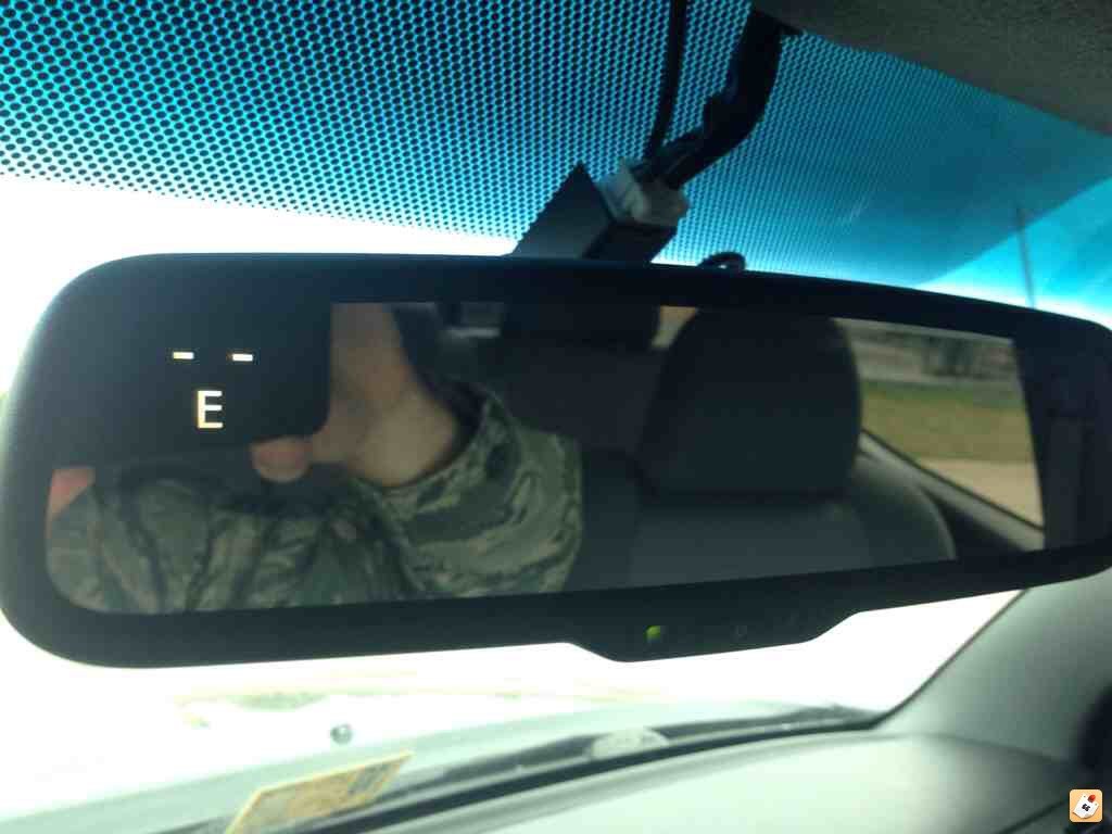

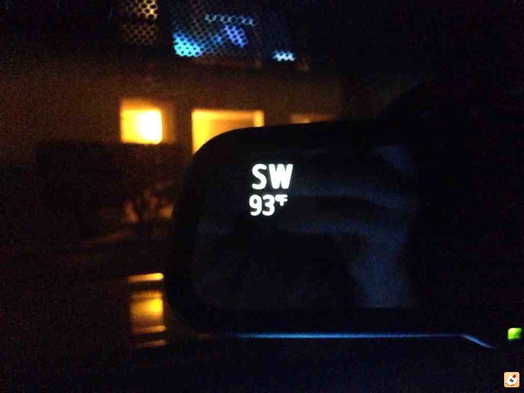

    It's definitely the signal it's receiving. I froze the temp sensor in an ice cube tray and the temp readout worked. See below. The display went back to dashes around 124°F.
    Also if I remove the sensor and temp install it directly to the AC amp (bypassing whatever wires are between the engine compartment and AC amp) the results do not change
    The AC amp I have is 88650-04020. Pictures below.

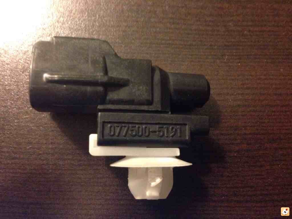

    And here is the thermistor:

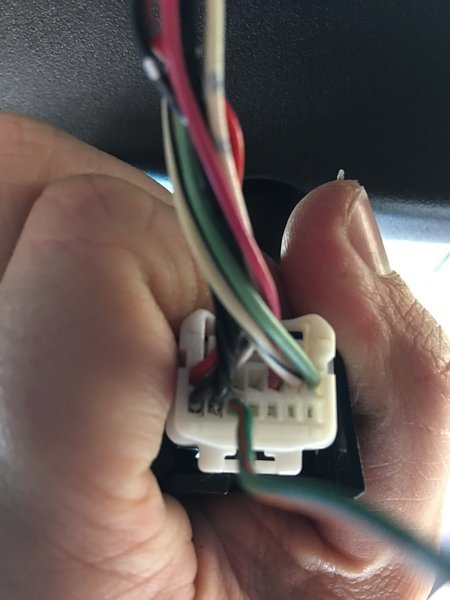

    image.jpg Ok so I have an 09 v6 access cab and can't get my temp readout to work and I'm about over this project. I have a gentex 957 with 3.3" screen temp and compass display. Hooked it up everything works but the temp display, just getting the 2 dashes. Bought the extra pin and ran a wire from the yellow overhead display and plugged it up and still just the 2 dashes. The green with red trace on the very bottom is the one I added
