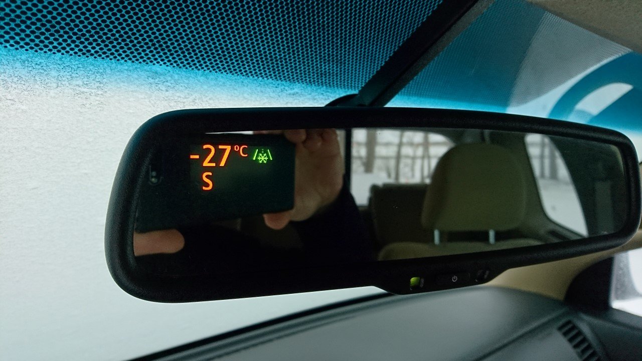

    I have a gentex 957 (back up display, compass, temp) I'd like to put in my 2011 which has overhead compass/temp and back up cam display in mirror. In my headliner they compass and temp appear to be spliced and/or routed from my mirror wire bundle. I've been told that I should be plug and play for compass but temp will be more complicated to use the factory sensor on the front. Is this possibly the procedure to get that working?

    I found another picture I had of the mirror on cloud storage (first pic).
    Note that the black square in the mirror is actually a reflection of my cell phone and not a characteristic of the mirror. The display has mirror glass all the way through so it looks seamless. It's not like in those "cut out" displays like in the 2nd photo.
    Let me know if you have any other questions on this.

    Great thanks, yup it's the same mirror as me. Thanks any pics of the adapter? Or you still in saskie?

    The adapter is stuck up behind headliner so I don't want to pull it out.
    All the adapter is, is a molex type connector with some wires coming out of it. Plug and play type unit.
