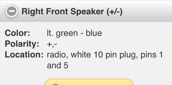

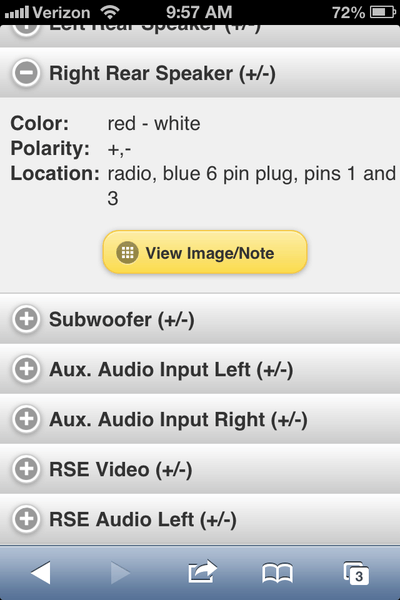

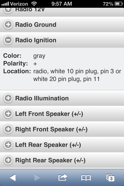

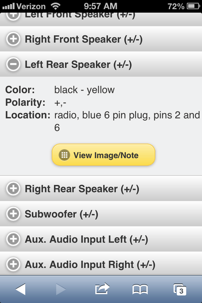

    Can anyone confirm what wires to tap into for installing a http://www.kicker.com/hideaway Kicker Hideaway sub with a factory head unit in my 12 access cab offroad no entune. I've got my wires routed to the back of the hu. Need to know which wire to use for my remote turn on and which wires are the appropriate speaker wires. I think I've got the speaker wires isolated but would love to confirm this if anyone has any experience. Thanks.

    maybe this will help.. found it online.. its for 2012 stanard audio system (non jbl)

    here this is what i used for my 13' when i did my sub install but i used the sound ordnance b-8pt, the chart is 100% correct

    That's what I was looking for, plain and simple. Thanks a million.
