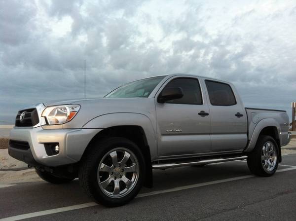

    i started with a 2012 TSS edition prerunner double cab. came stock with 20" rims an 265/50 toyo proxes stII.

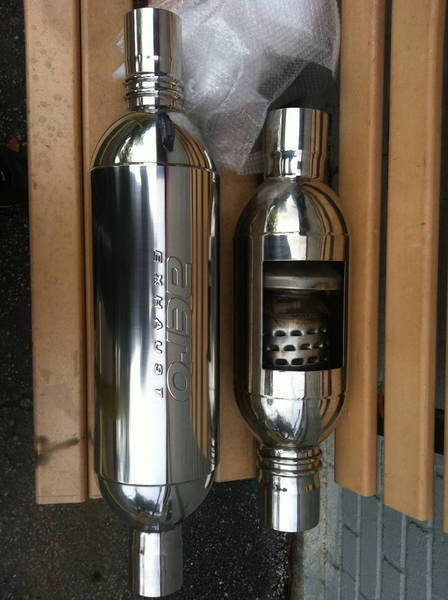

    also during that time, i added this aero 2525xl with resonators. love it!

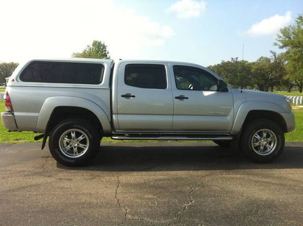

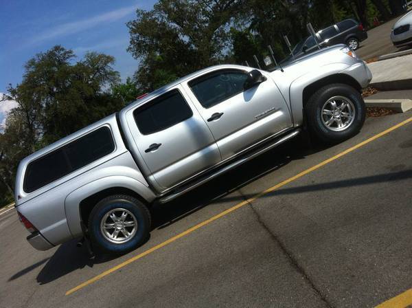

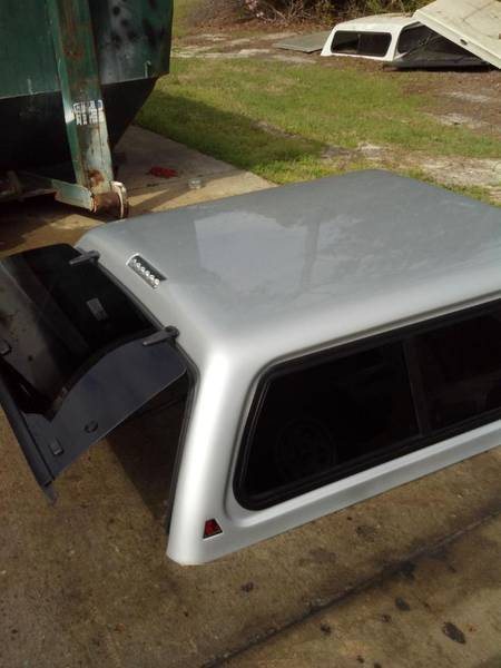

    i found this leer topper/shell on craigslist, had to drive from biloxi to valdosta ga. to get it, but the $500 price was irresistible. good opportunity for first roadtrip

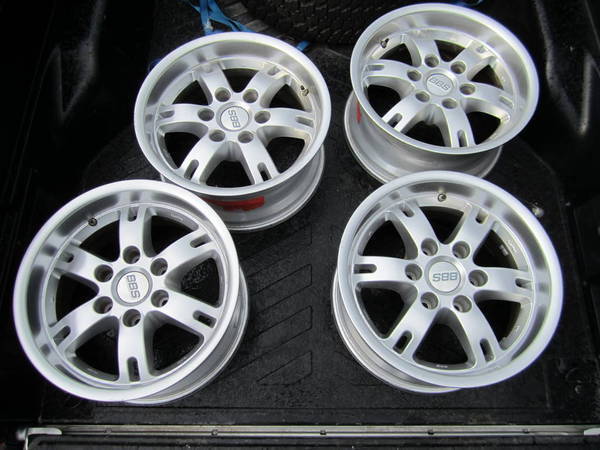

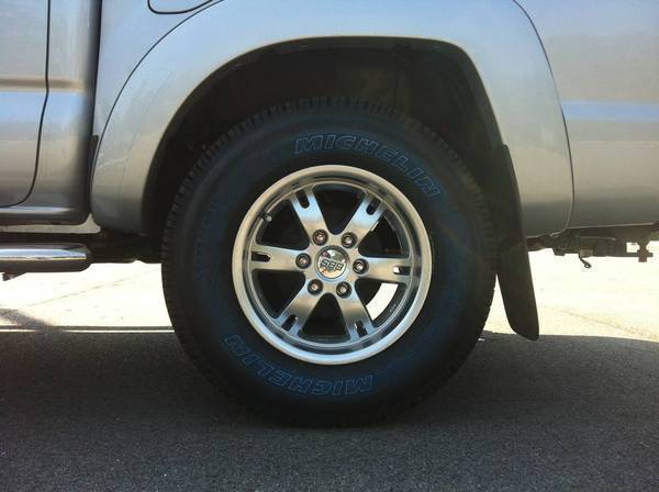

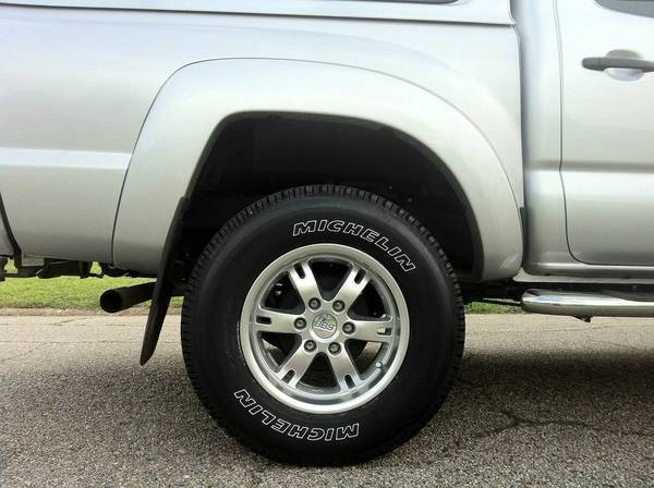

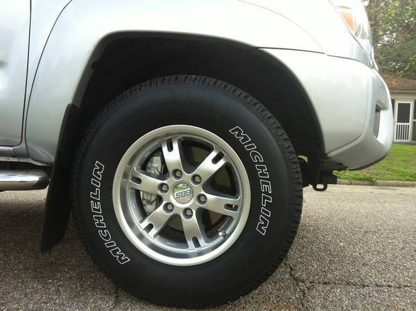

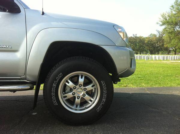

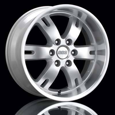

    found these 17x8 fj wheels on ebay for $688 shipped. they have a +5 offset and 4.76 backspace. bought a set of michelin 265/70 17 at 2. installed on 30mar12. with no lift, this combo rubs slightly, mostly when backing up.
    pic stolen form google

    [​IMG] front no lift
    rear no lift
    side no lift

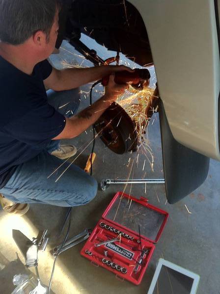

    my son and i installed the aal today, and will do the fronts tomorrow. i'm planning on setting them at 1.75"
    i was amazed at the difference in hieght that the tires gave me. after adding the aal, i was astounded. it is so high in the back. it reminds me of my 2007 tundra a lot. pics tomorrow

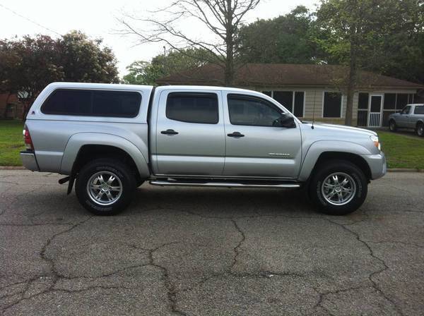

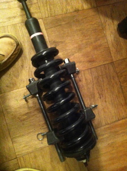

    i expect the rear end to settle a bit more, but its ok with me, i like the rake. not gonna go with 2.5. glad i didn't go with .85 though/
    no rubbing at all.
    loaner spring com presser from autozone
