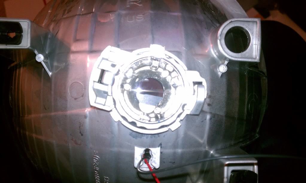

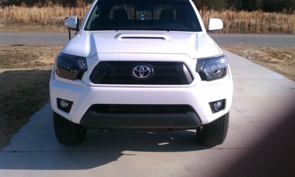

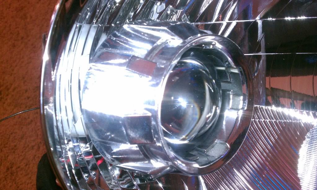

    I just received my new mini D2S retrofit kit for my 2012 tacoma. I was told that you need to modify the adaptor because it doesnt allow the projector to be level. I was wondering if someone has taking on this task with there 2012 can give me some guidance. Here are some pics and as you can tell the first pic in the middle of the light you can see the top of the projector line is not level. Is this what I need to correct? Also is the shroud suppose to sit flush with the reflector or is there suppose to be a gap like in pics two? Thanks everyone

    There is a gap with mine...looks off but if you don't want it you need to do an FXR style install.
    The notch or step is supposed to be there...however the rotation is off...several ways to do this...easiest is to shave the little notch in the alignment washer and rotate it to the correct spot (test fit your headlight)...then make sure it doesn't move...glue it and then it won't go anywhere...easiest way.

    Where did you glue it so it wont rotate?

    I used epoxy all around the adapter plate and first nut...don't forget to feed the wires through before you glue it like I almost did lol.

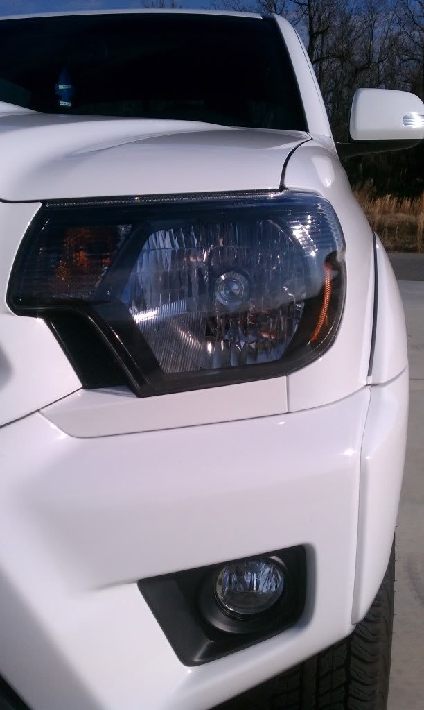

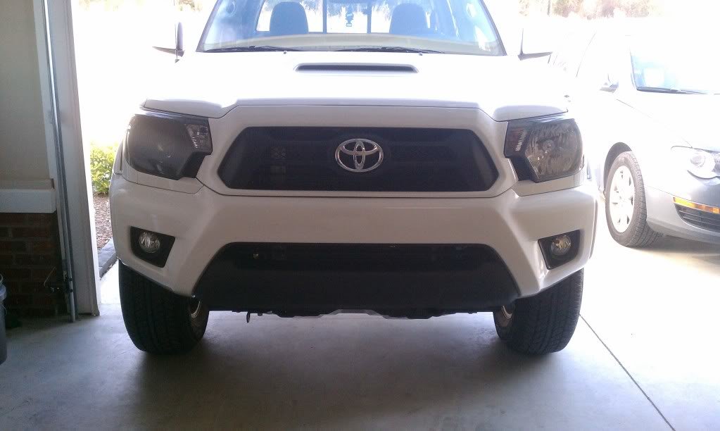

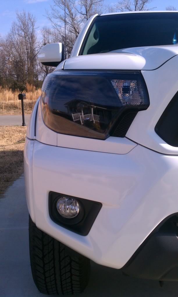

    Need some help! Which one all black and chrome reflector/shroud?

    i'm in the same predicament!!!! i was thinking of just painting the shroud... both look good though, haha! the black looks mean!

    I like the chrome with black surround

    Way cleaner, more depth. All black looks worse IMO. (Never thought I'd say that)
