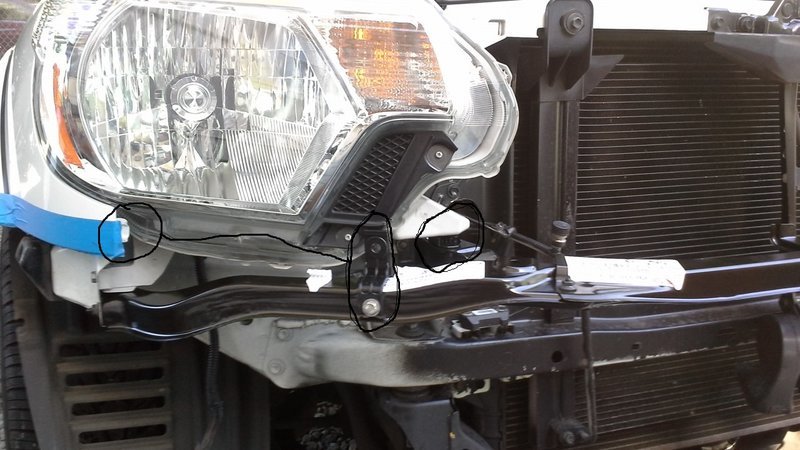

    Pic you can see black clip circled is were bumper filler clips into . Circled part on fender is were other side of bumper filler mounts. Other circle part is were bottom of inside of head light mounts.
    better pic
    ARCHIVE and Boomkanani like this.

    Thanks! Makes sense after you pointed out the mounting for the filler and headlights.

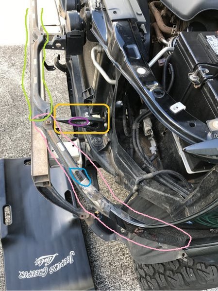

    I ordered everything in the OP. Below is a picture to help explain the parts' location. If you're going aftermarket bumper, the only one you MIGHT be able to avoid ordering is green. I wouldn't recommend it though because it acts as a cross-brace and gives strength for the headlight mounting and the hood lock bracket. My build has some other pictures of my test fit.
    Green is replaced by: 52521-04050 RETAINER, FR BUMPER x1
    Yellow is replaced by: 53273-04030 BRACKET, FR BUMPER A x1
    53274-04030 BRACKET, FR BUMPER A x1
    Pink is replaced by: 52125-04020 EXTENSION, FR BUMPER x1
    52126-04020 EXTENSION, FR BUMPER x1
    Purple: 53271-0B010 BRACKET, HEADLAMP x2
    Blue: 52531-04010 RETAINER, BUMPER FIL x2
    Also need:
    52522-04010 RETAINER, FR BUMPER x2 (little white piece)
    53935-04020 PROTECTOR, FR END PA x2 (clips to fender side of bumper filler)

    Going also need 2-5393504020 bumper filler retainer mounts onto bumper filler and snaps onto fender and 2- 5252204010 upper retainer fastener for headlight bottom mount (# 2 in post 184)

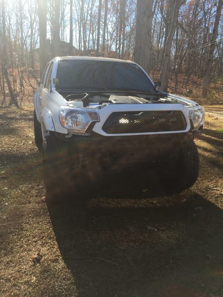

    IMG_5138.jpg I'm about 80% complete on my conversion. I have all the parts just trying to complete my retros and have to have my bumper powdered and a few custom touches:woot: and yes. All the headlight brackets must be used to support the headlights with the 12-15 pelfrey
