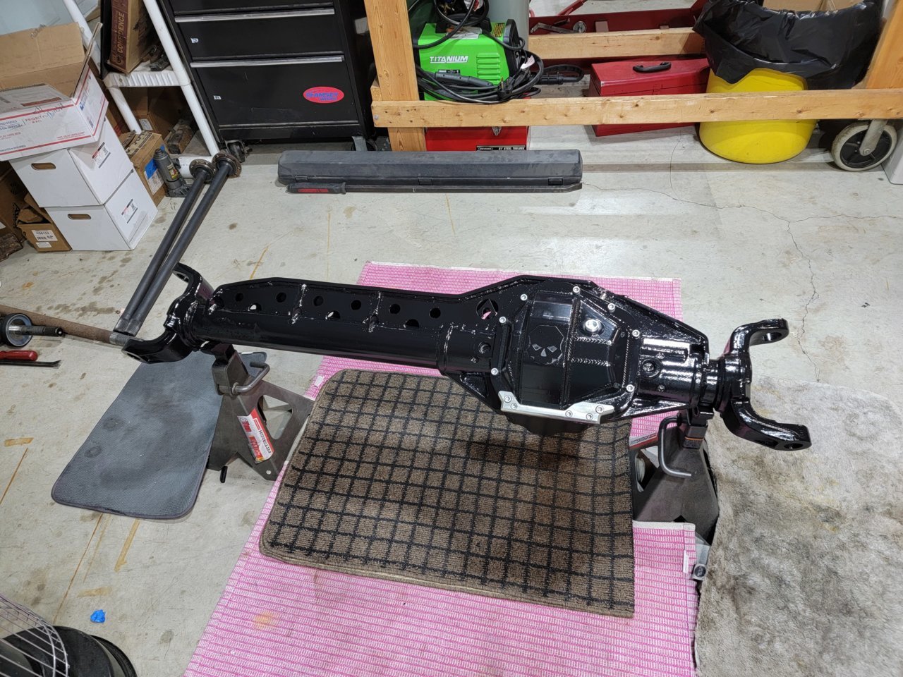

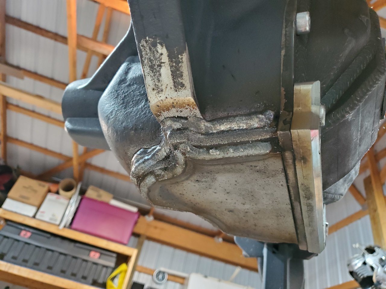

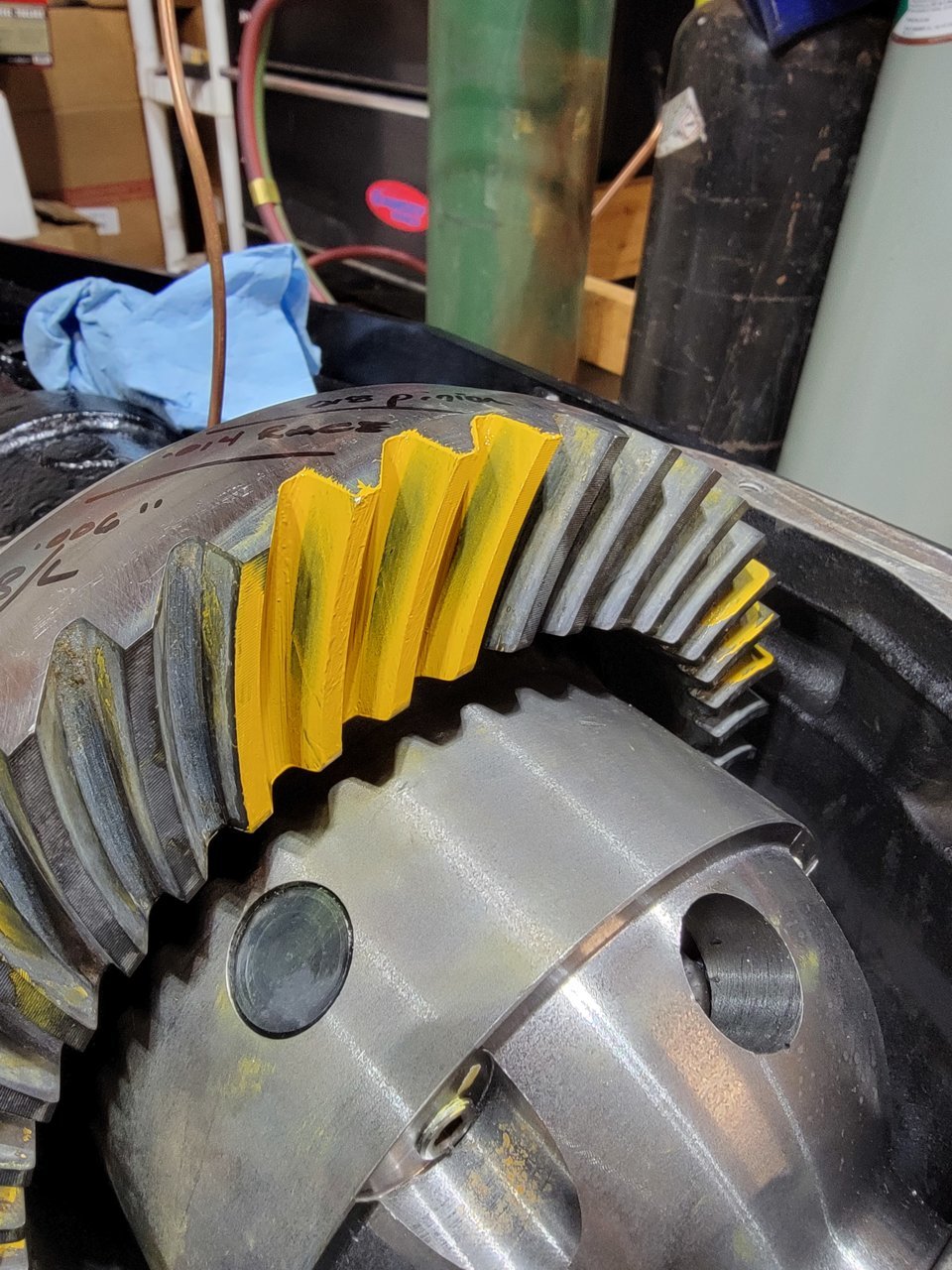

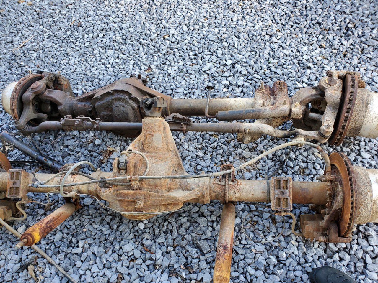

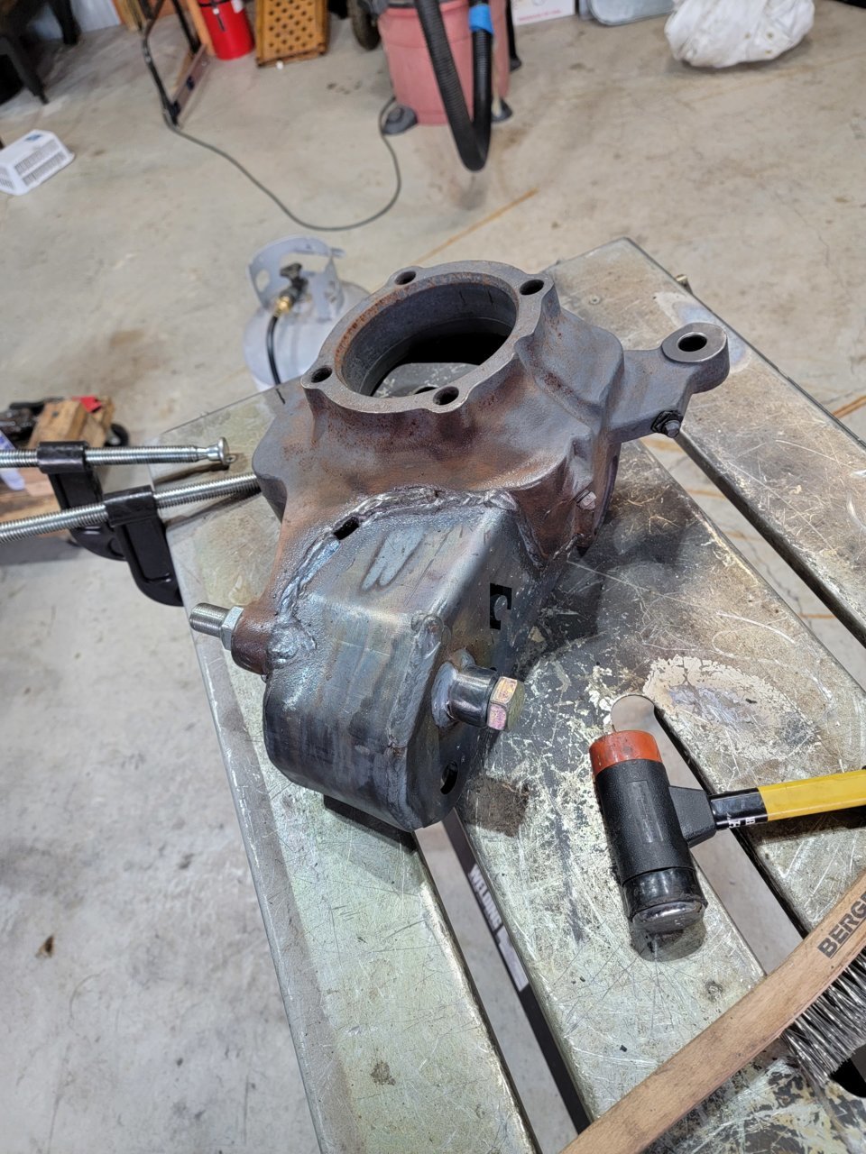

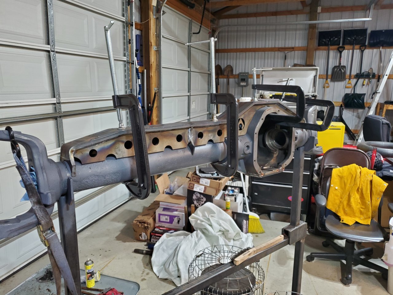

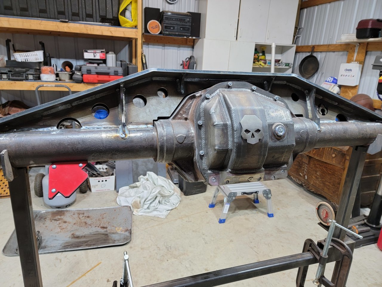

    20201021_101536.jpg 20201021_170924.jpg 20201130_152848.jpg 20201129_161734.jpg 20210501_202426.jpg 20210609_201815.jpg Axles I got for free from a friend. Super nasty, but you cant beat free. I cleaned them up, should have had them sandblasted though. I completely went through these axles and installed 5.38 Yukon gears with ARB airlockers. I have never done gears before so it was very much a learning experience. Youtube definitely saved the day. I shaved both housings with Ballistic Fabrications shave kits. Pre-heat to 400+ and post heat the housings due to them being Ductile iron. I had to shave both ring gears for them to fit the housing due to the shave kits. I made a setup to hold the carrier while I used an angle grinder to shave them while spinning.
    I also welded on some Artec industries High steer arms. Dana 60 knuckles are ductile iron as well, so pre-heat applies as well. I then installed Artec trusses on each axle housing. These axles took a ton of work, but definitely a better option than paying for aftermarket axles as far as $$$ goes.

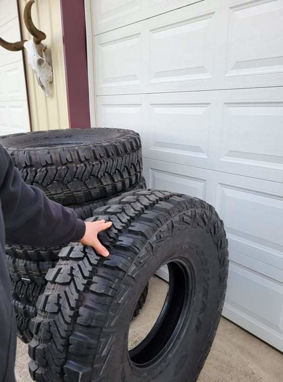

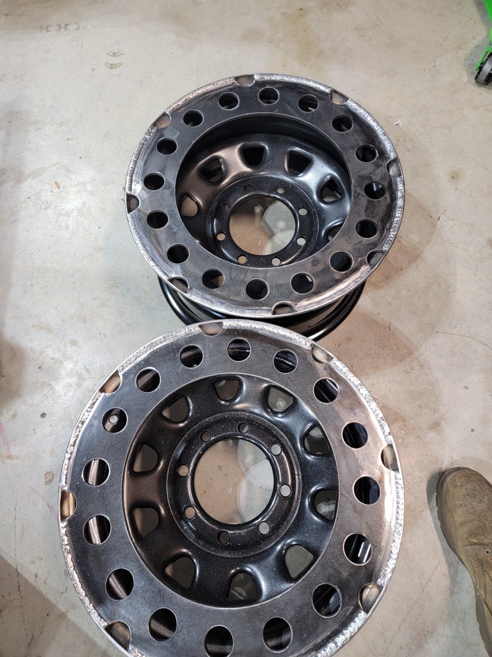

    Axles cleaned up pretty nicely considering they were disgusting. Tires and wheels showed up last week so I started on those a couple days ago. I've completely stripped the front and rear frame rails of all of the old brackets and crossmembers. It's been a grind-a-thon this week. Have a 3m respirator and 36 grit wheels to make life easier.
    The wheels are NOT beadlocks, I am running inner air locks from Coyote. I like doing things a little different. You will see this alot along the way of this build. 20211124_192539.jpg 20210904_202113.jpg received_1348271082261934.jpg 20220227_185526.jpg

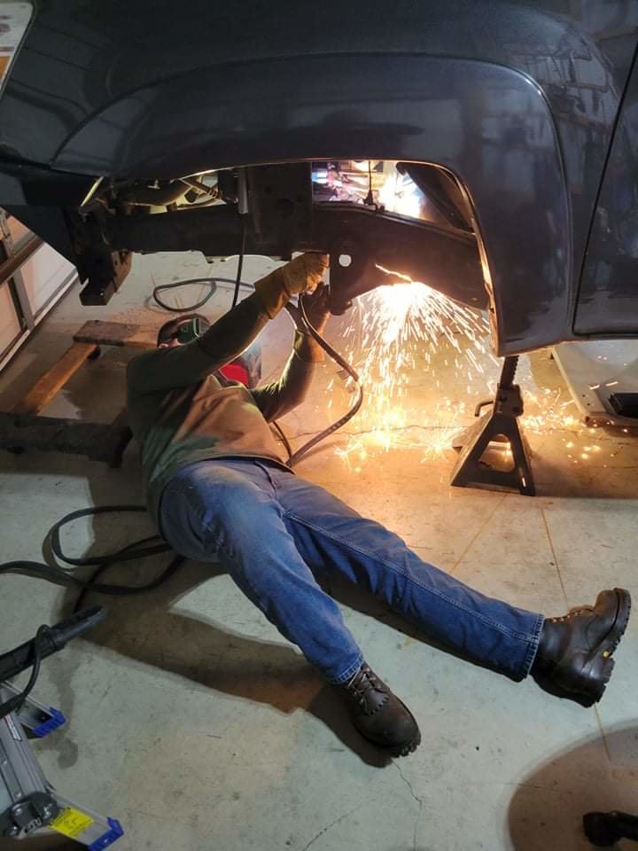

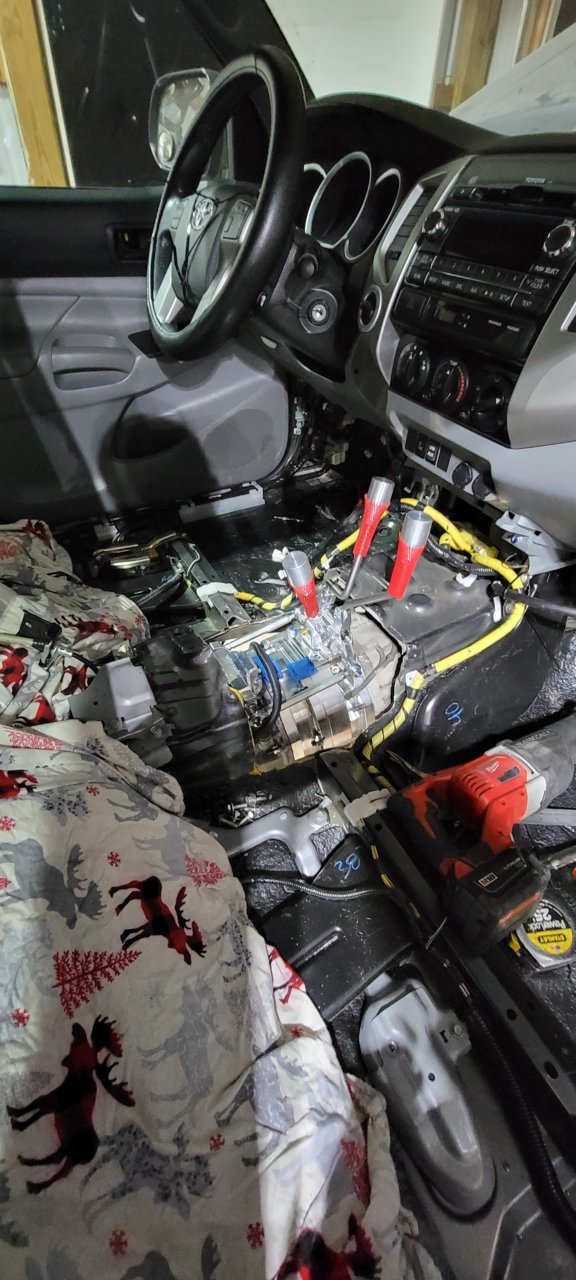

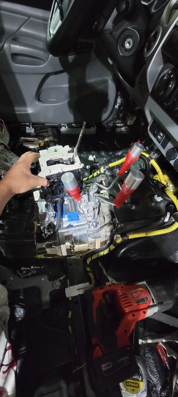

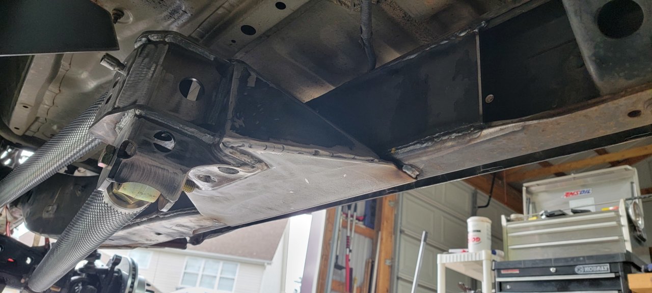

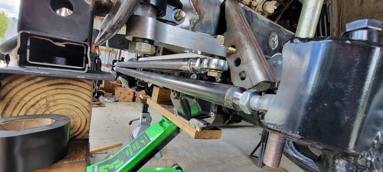

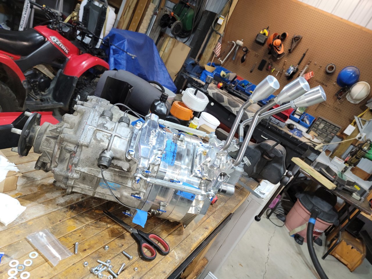

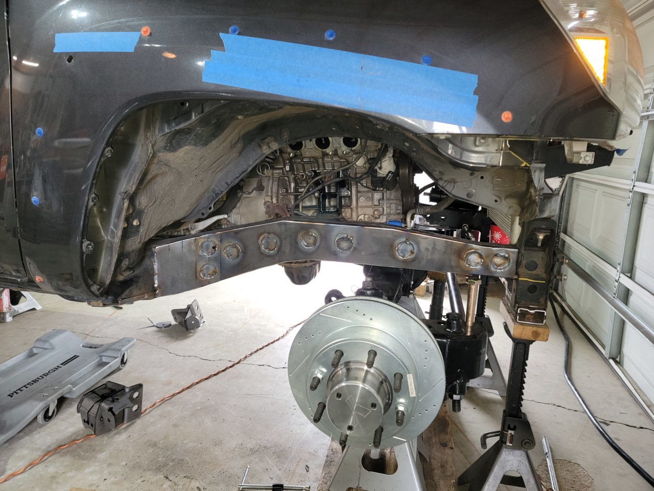

    20220507_124855.jpg 20220602_204219.jpg 20220609_215244.jpg 20220609_215300.jpg 20220611_211420.jpg Ended up getting the front frame plates welded on. I've been spending some time installing frame plates in the areas where the link brackets and transmission/transfer case crossmember are going to be mounted. I've also got the steering gearbox mounted. Links have showed up and I'm getting them mocked into position currently.
    The bad news is that I've gotten my triple shifter kit from Northwest Fab. No fault to them, but it will not work. 1st off, the shifters do not come pre-bent in order for them to come out near my "pen holder slot" like they did they would. I also raised the engine mounts to gain more uptravel, this has changed the height of my transmission slightly. So it looks like my automatic shifter will need to move and I will need to fabricate a custom center console setup.

    Teaser. Was trimming some sheet metal. Working out full bump, and figuring out my link bracket placement. Trying to clear these massive 2.5 inch 7075 lower links.

    I am going to run the NWF ecocrawler and shifter setup, just changes my ideas that it could work with my stock center console.

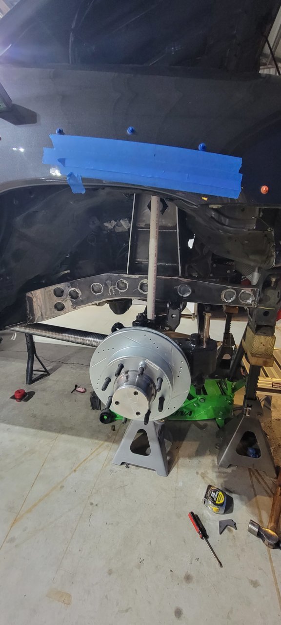

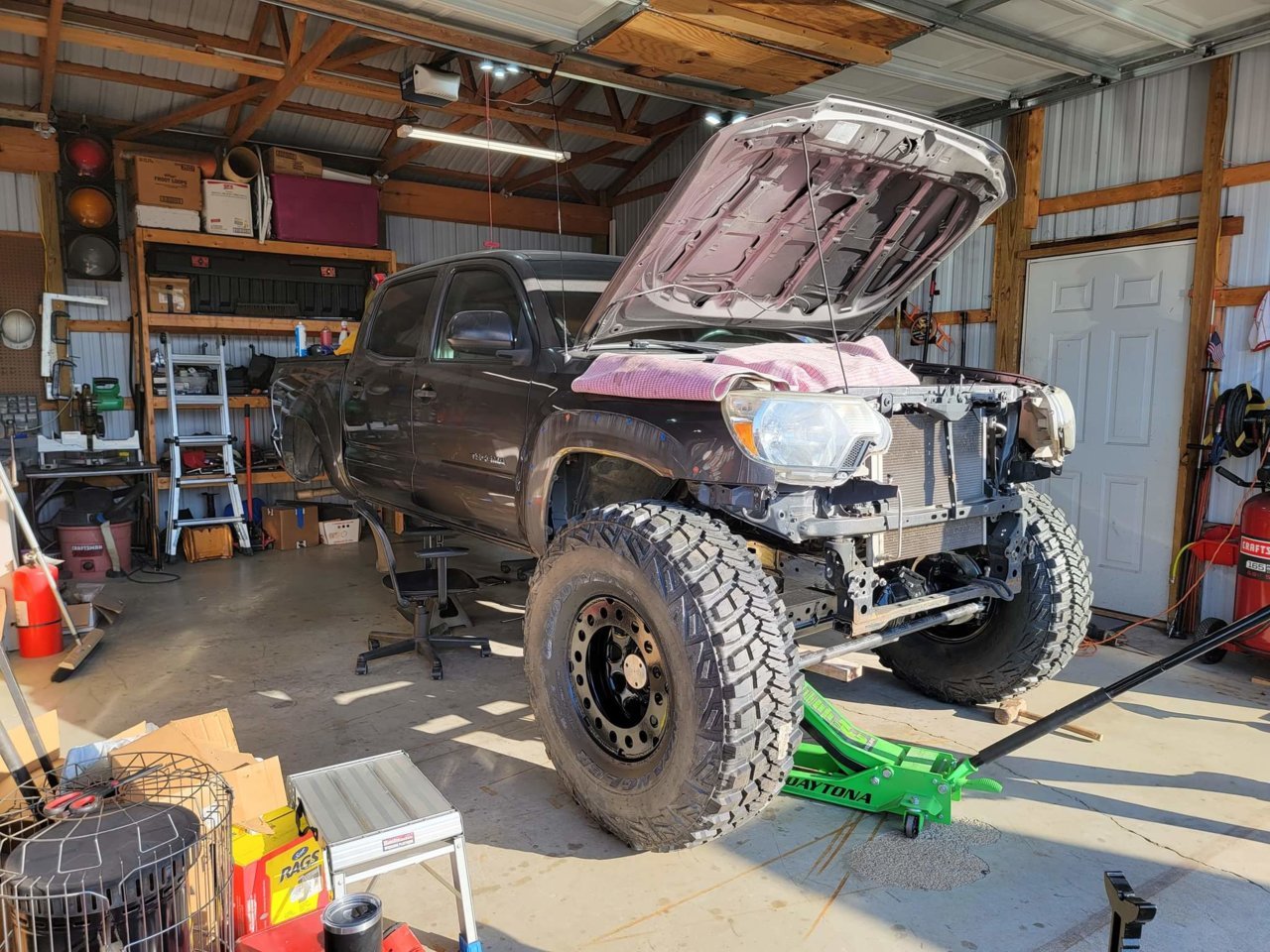

    Front end is mostly in place and figured out. Shock towers, steering, panhard bar ect. Need to mount hydro assist and finalize some stuff up front, then it's on to the rear end!

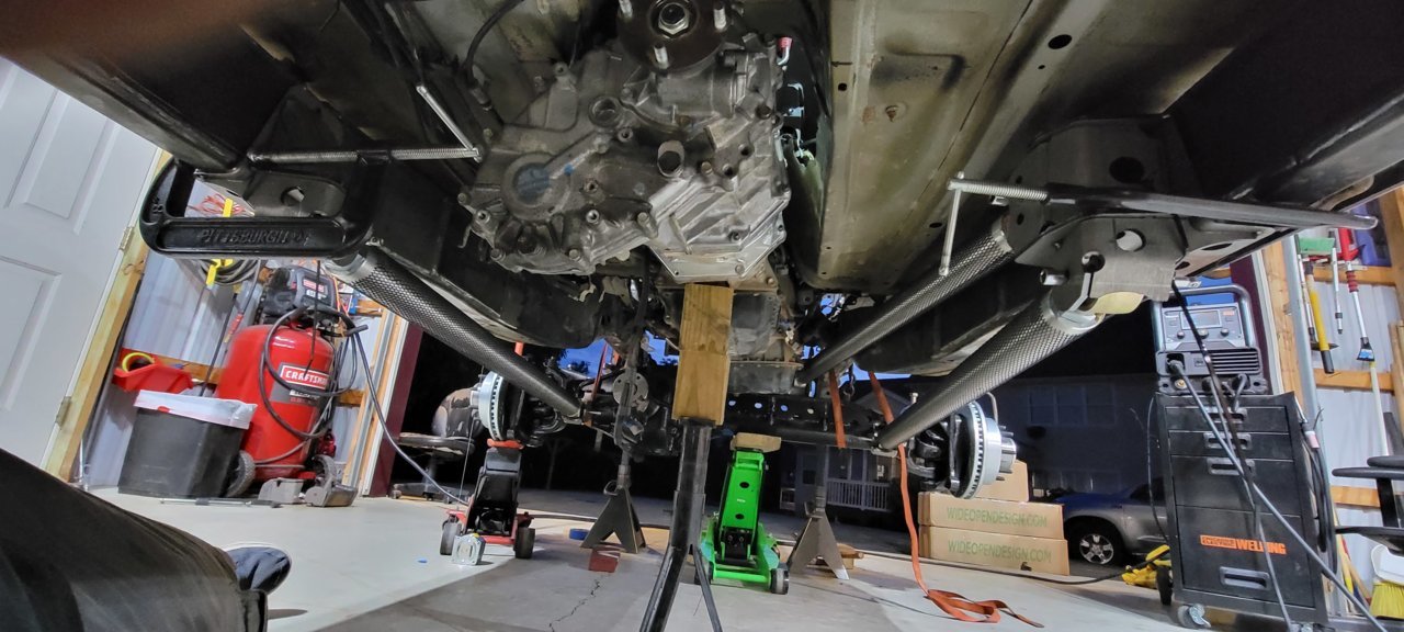

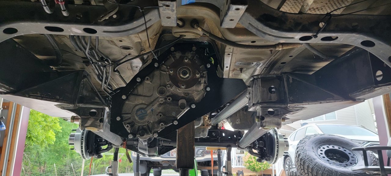

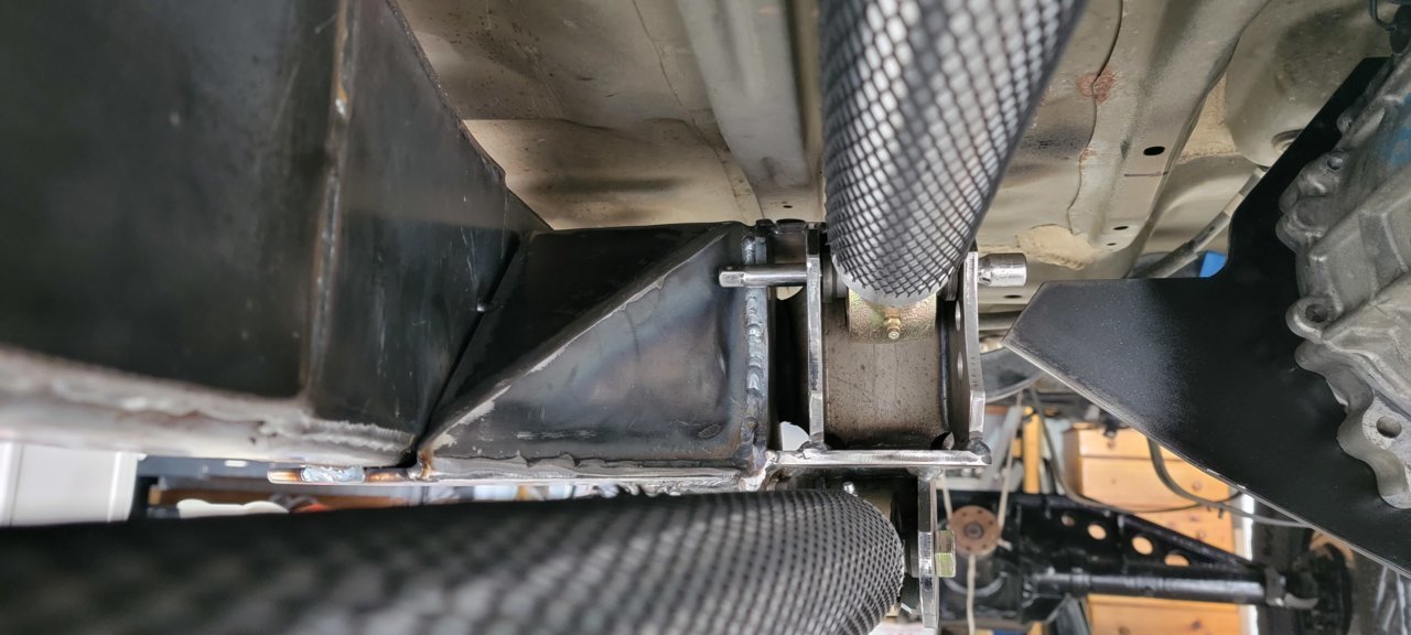

    I didn't post it, but I ended up completely redoing my 3 link frame brackets in order to have my link bars clear my frame.
