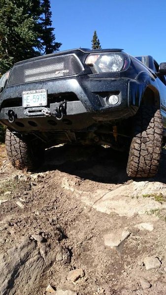

    Review time! I put this bumper, a smittybilt XRC 9500lb winch, OME lift with 886 coils, icon uniball UCA's, and a set of 305/65r17 mickey thompson ATZ P3's on my truck Thursday&Friday last week. I went to a wedding on Saturday, then Sunday morning I hit the trail. I did the Whipsaw trail near Princeton, BC over two days and was pretty impressed with the setup.
    Bumper install was pretty easy. I'm pretty happy with the fit and look. It didn't take any big hits on the trip but looks like it could hold up to the rocks pretty well. I did use the winch a couple times and the bumper didn't fall off, so that's a bonus.
    The OME lift with the 886's is great. I have a synthetic winch line and this bumper is fairly light so I only added about 100lbs to the front end. I also have two 20" light bars and a beefy steel mounting bracket... I would guess these weight about 50lbs total but I have never weighed them. The ride is very comparable to the stock TRD Sport suspension on the road, but waaayyy better offroad. It's fairly stiff with the 886's which makes the ride a bit harsh on washboard or otherwise bumpy dirt roads at speed, but definitely no worse than stock. It's much better on big obstacles and at low speeds. I removed the sway bar and added the UCA's at the same time as the lift so I can't say how it would ride without doing these things but I'm very happy with it. All in all, I've retained almost all the on road usability and drastically increased offroad capability.
    The only drawback to my new setup is due to the tires. They are much heavier and a little larger diameter than stock which has made a big impact on power and fuel consumption. They're also much noisier than stock (obviously), but quieter than most MT's and more comparable to an AT. I'm very happy with them in both on and offroad traction though. Don't take this as a negative review, they're an amazing tire. It's just the same trade off as going to any larger, more aggressive tire.

    Very nice. You have Dakars in the back? How's the stance (rake) with the 886s? Considering the same suspension myself, I don't mind stiff but don't want the front higher than rear.

    Obviously your bumper is defective as I designed these to fall off if the winch is used...for liability reasons of course. You need to return it to us immediately. :D

    I have the TSB leaf and a 1.5" deaver AAL I got with the kit from toytec. Front sits 1/2" lower than the rear. I am expecting the front to come down a little as it gets broken in too.

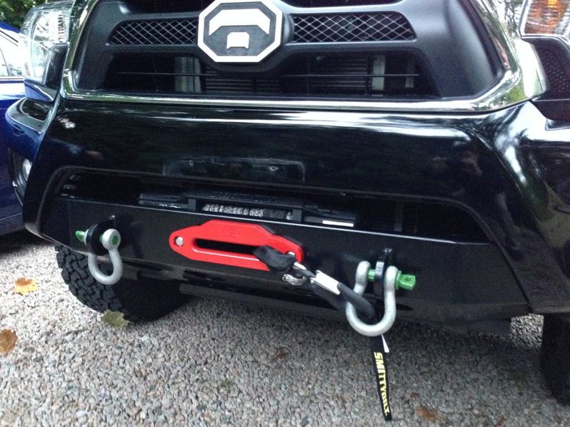

    Finally got installed and wanted to post up. Light was fading, so I'll update later when I get better pics.

    About stinkin' time... looks good! Send me some high res pics.

    Hell yea! Another smitty!!!
    Looks good.
