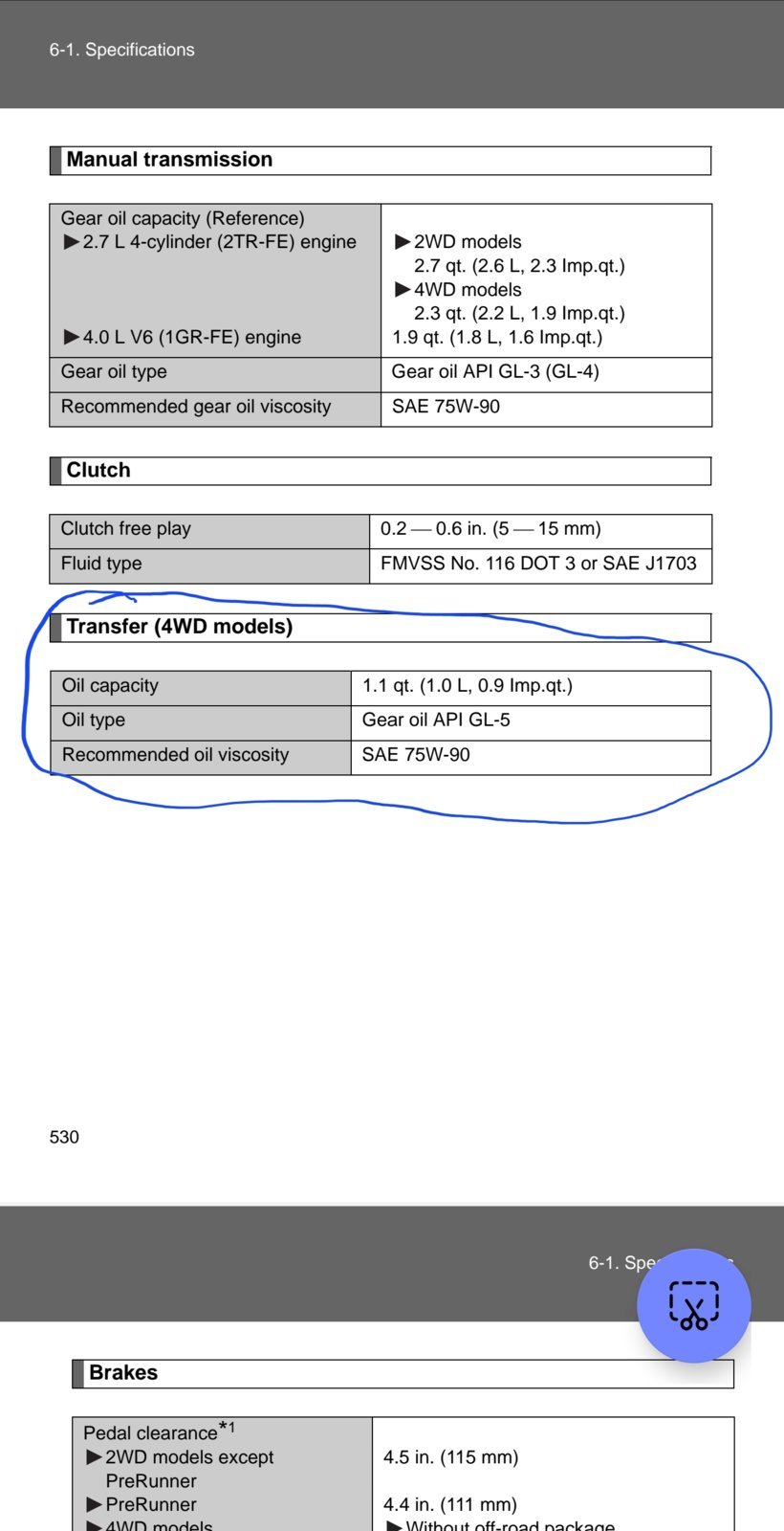

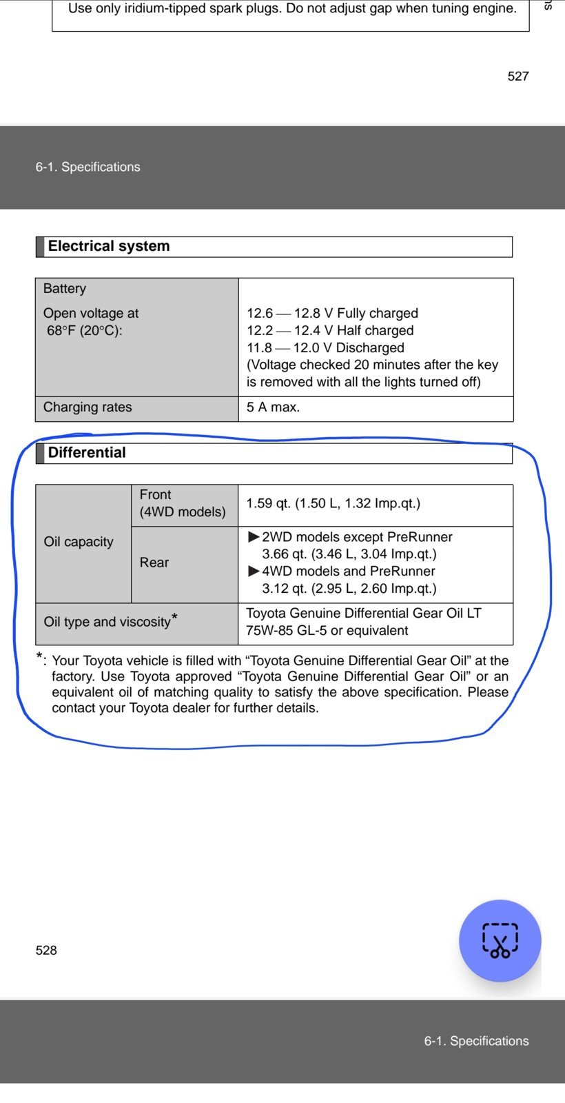

    These trucks call for 75w85 for the diffs and 75w90 for the t case. However, I used redline since they were the only brand I know of to offer 75w85. It's basically a weight toyota designed so it's hard to find brands that make it. I did that just to use what it calls for, but really, you don't have to do that. Diffs aren't picky like your engine and transmission. I would go to your local parts store and get Mobil 1 75w90 and use it for everything. The rear axle holds roughly 3 quarts. The front diff holds 1.6 I believe. And the t case holds 1.1. So, get 7 quarts.

    I drive a 15, here's my manual and what it says.
    isahdm[OP] likes this.

    ah yeah thats right, there will be a little left over after the tcase/front diff... so put 3 and the leftover in the rear axle.

    These call for 75w85 for the diffs, but lots of people just use 75w90. It's a lot easier to get ahold of and it works just fine.
