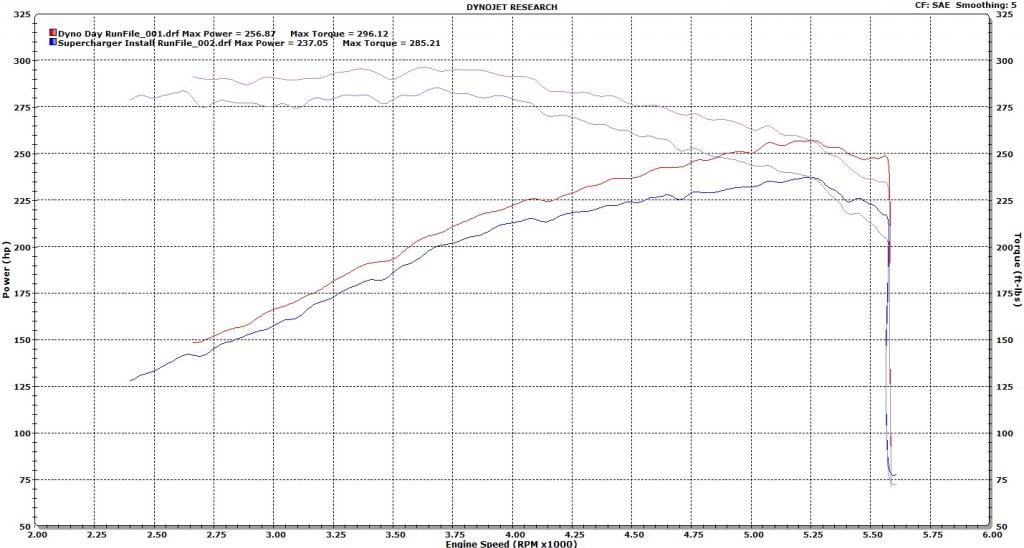

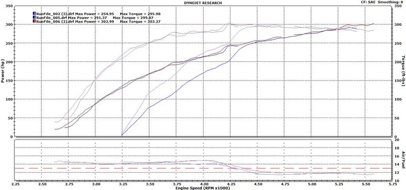

    So I think I figured out how to post this thing. It looks like I am missing the first run. I thought I had a run at 310 whp. I asked them to resend the files. I have to say I am a little disappointed. Looks like I am getting the urd y-pipe for sure. With my fuel ratio's do you guys think I should use the unichip option or am I okay to wait for URD's ucon ems to have plug and play?

    Numbers look good. But i wouldve thaught you would be closer to the 340hp range with your upgrades... But still good power output. The y-pipe will help free up some ponies in the mid-upper RPM range.

    Right now, your AFR's look good. High 11's. A bit strange that if they went WOT, just like everytime you do a dyno pull, that it took so long for the AFR's to drop down to the 11's, but either way, it will be just fine.
    And this is considering that you also have a smaller than stock pulley. What psi are you running now? I do not remember.
    Also, are you running the FPR mod or no?
    URD Y-Pipe will make a noticeable difference. By the end of the pull on Lucario Runner's 4Runner, he was 30+ hp higher with it over the stock Y-pipe. And his is N/A.

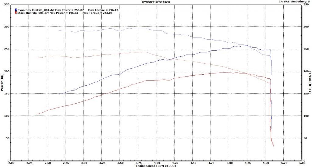

    He is actually inline with another member on here who has a '12 Taco. That guy's mods are less, and his power output is respectively less as well.
    So seeing that guy's dyno and now JarHead's dyno, it is easy to see the improvements gained by JarHead's additional mods.
    Purely speculation, but I think the EGR system on the '12+ models, is also hurting power a little.
    ***EDIT***
    It was Commanderwiggin's '12 dyno. In this link. > http://www.tacomaworld.com/forum/pe...o-after-install-vs-dyno-after-some-miles.html
    ^^^ His Base.
    ^^^His dyno right after install, then 2K Kilometers after install.
