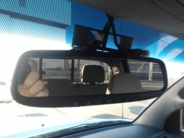

    OK guys, got a few shots of the install this morning. First up, the front view of just the mount... You can see it's a bit wonky.

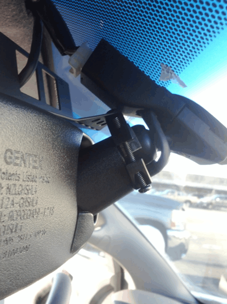

    Here's a closer look at the mounting collar. It's hard to tell, but it's just too narrow to fit around the widest part of the stalk.

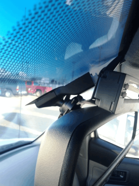

    I thought I'd post this angle so you can see what I meant about not getting the plastic shield back in behind there.

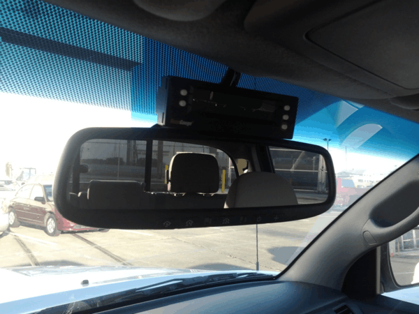

    Anyway, here's the final result, as viewed from the pilot's chair. Not too bad.
    Hope that makes things clearer.
