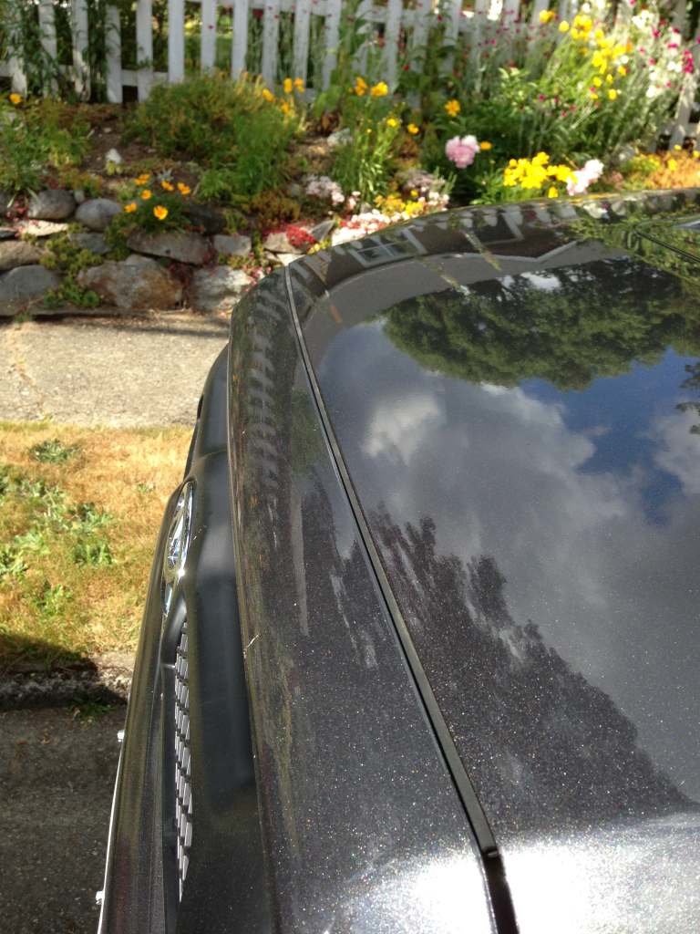

    I'm curious about what kind of gap you guys have between your hood and grill. I wonder if your hoods are aligned further back then mine; and hence not pinching the gasket tight enough. You can see the gap that I have on mine. It's just a thought.

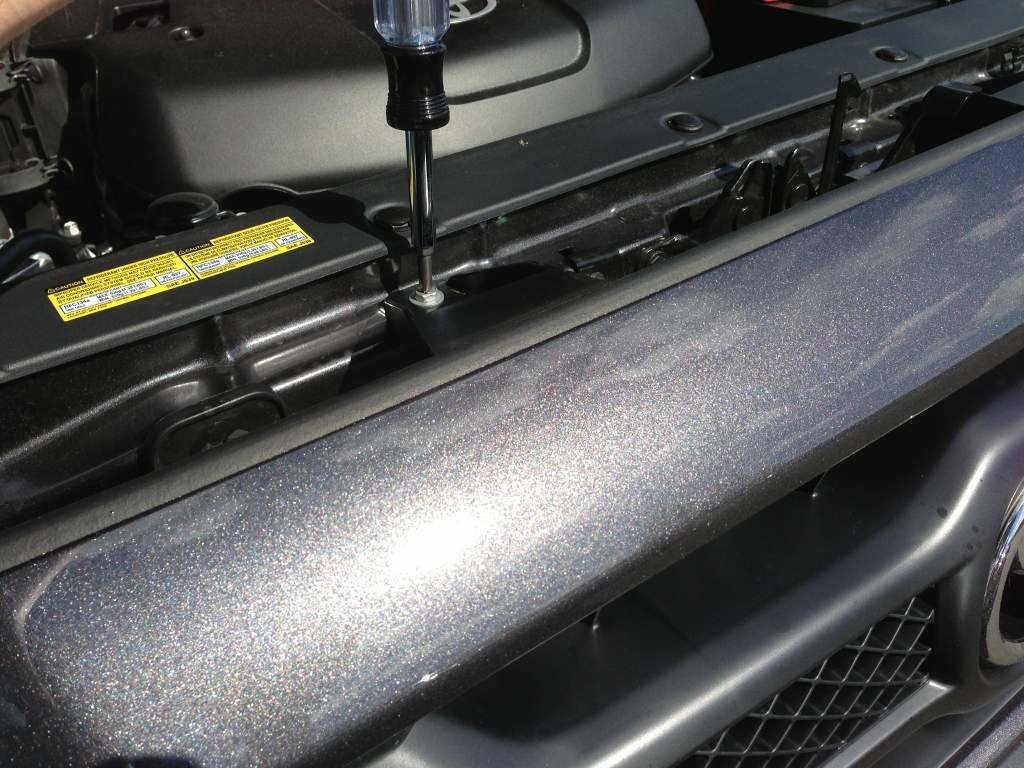

    I need to fix mine!! Mine whistles like crazy and it super loud at 70mph.. :(
    not even the stereo can drown it out..
    Im going to realign my grill, its off just alittle.. Then Im going to put 1/4" tubing inside the weather stripping.. Im think i may use a rubber or pvc/vinyl hose instead of the poly one.. Isn't the poly one really stiff??

    I had the whistle on my 2013 DC starting around 40mph. Thank you to the guys that posted about the 1/4" poly tubing fix in the rubber seal between the grill and hood! This worked! It only cost me .69 at Lowes! My kind of fix!

    I have a 2103 Tacoma and had the same problem. They replaced the windshield in accordance with the SB and I still had the whistle over 45 MPH. I knew it wasn't the windshield after I drove it home from the dealership with the tape still on the windshield.
    Then I saw this post. I went to WalMart, got some fishtank pump tubing, silicone spray, sprayed it into the seal at the center of the hood between the hood and grill and slid the tube in. Total fix was about $8.00.
    I fixed it right in the WalMart parking lot! It took me about 5 minutes. YOU WILL NEED LUBRICANT TO FIX IT! I RECOMMEND THE WD40 SILICON!
    I went to the dealership and showed the maintenance manager. HE LOVED THE FIX!
