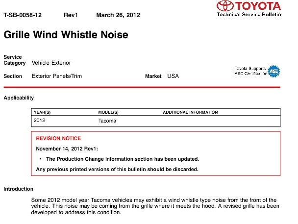

    My '13 was making the same sound. I took it in and they said there was a TSB for the 2012 model for the grill and replaced the whole grill on mine. No more whistling on mine.

    Do you have te TSB#?

    f549f6e0819da523444a8b8f841c3864_zps4f03_0778a6451d61219cdc0a06152548319fda7702fd.jpg
