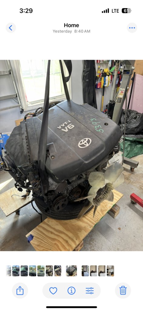

    Found a 2013 motor, this is where the fun begins!
