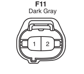

    One of those threads suggested testing this connector. Anyone tell me where this is?
    https://www.tacomaworld.com/media/fuel-pump-test.658155/
    (here is other thread: https://www.tacomaworld.com/threads/fuel-delivery-issues-2013-v6.661519/page-2)

    I saw that the connector with pin 8 is located there, and I will certainly be going to check that out. But there was also a 2 pin connector shown recommending to put 12V power to it to directly power the pump for a few seconds to see if that is the issue. Just not sure where that one is.

    I just read through that myself it seems to sound like the fuel pump harness itself, the 2 pin connector. Might be thats located somewhere outside the fuel tank I would assume.
