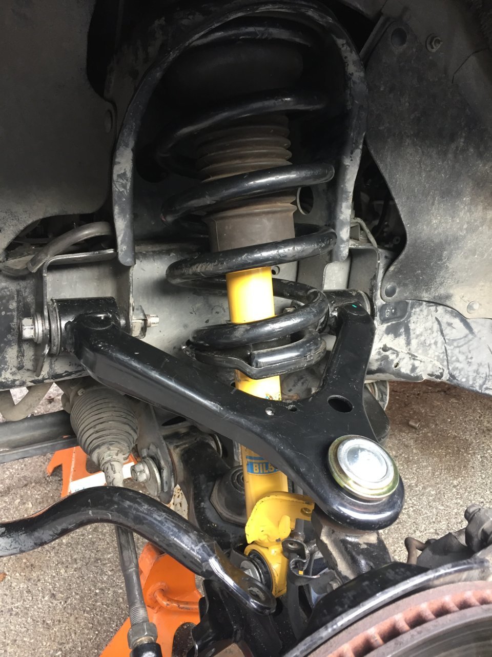

    Hello!
    Does anyone on here have a 2wd 4 cyl Tacoma? I am trying to replace the shocks but the control arm was hitting the coil. Can someone send me a picture of what theirs looks like to make sure I did it right?

    Disconnect the balljoint at the spindle, jack the spindle up some to raise uca an strut should come out as lca swings down given you took off the nuts on top. Also may wanna take swaybar off that will help the process.
