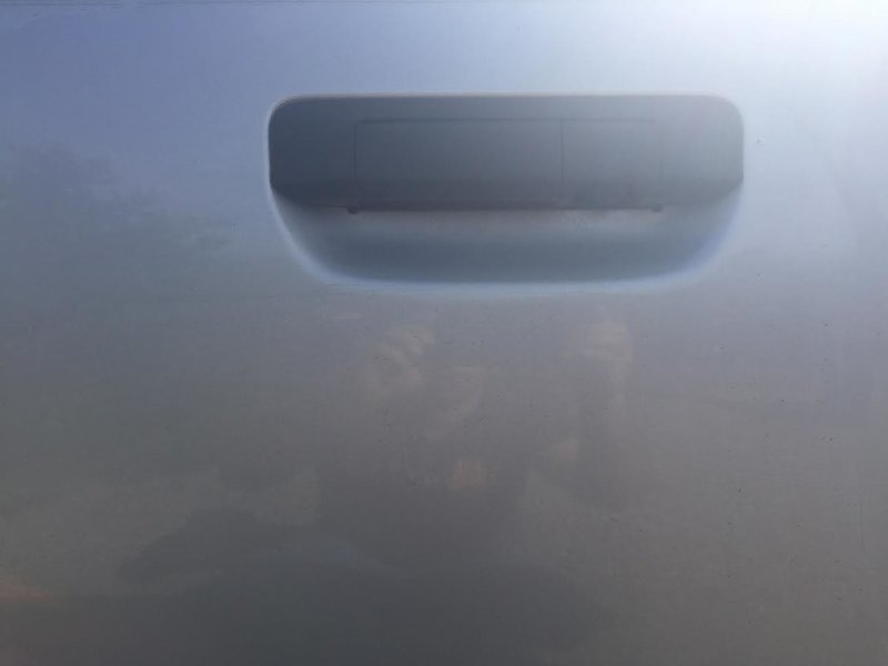

    Can you get a picture of the camera mounted? curious to see fit

    Plenty of wire, I think I looped the extra cable twice inside the tailgate. Ill have to get a picture later. It looks like a factory install which to me was what I was going for. :) The camera is slightly recessed in the tailgate handle so you don't really see it unless you bend down and look for it.
    The only thing that is slightly off is the image displayed is slightly shifted to one side. you can see it in the radio image i loaded previously. I think this is because the camera is mounted slightly off center in the tailgate handle. By design the mount location is not in the center of the tailgate. :notsure:
