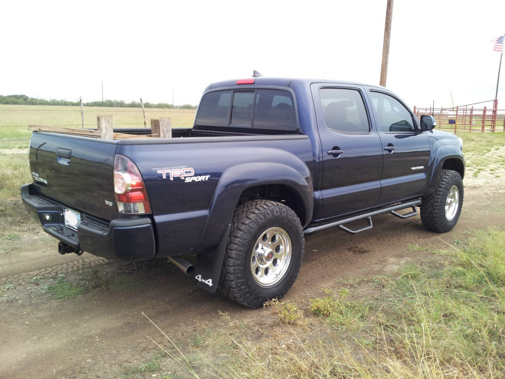

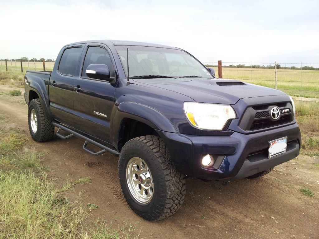

    265/75/16 mounted on 16x8.5 rubbed even with the front mudflaps removed when I turned all the way and hit a slight bump (like turning into my driveway). These tires are the same size diameter as your 265/70/17.
    I now have 5100s set at 1.75 in the front...4 factory leafs in the rear. And no rubbing and it rides much better than stock.

    Ive seen a couple pics of your truck. Let me make sure i have this right, you have 8.5" wide rims with 265/75/16 and bilstein 5100 up front set at 1.75"? It looks taller than that maybe its the pic angle. Nice looking tacoma.

    i just did the 1.75" 5100 deal with tsb and I couldnt be happier...
    im currently looking for rims... they really set this lift apart from how it sits now with stock offroad rims...
    nice looking truck man!
