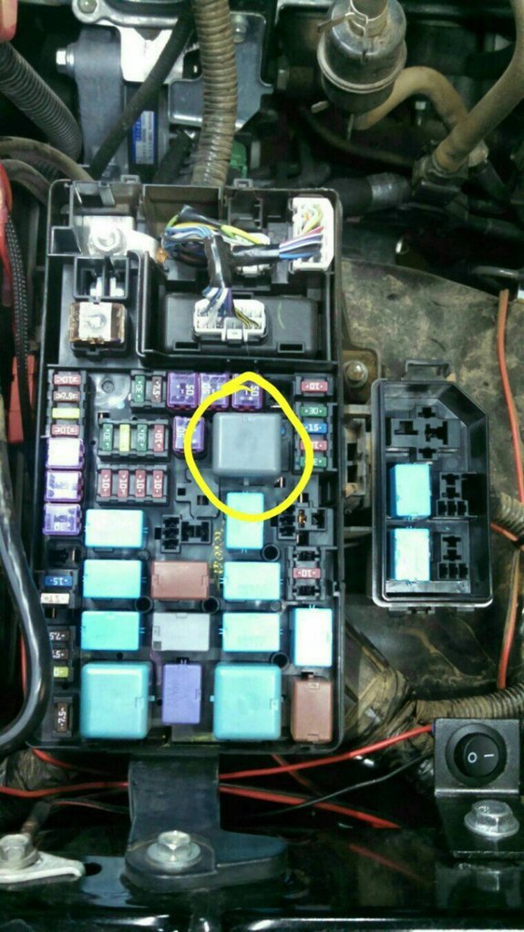

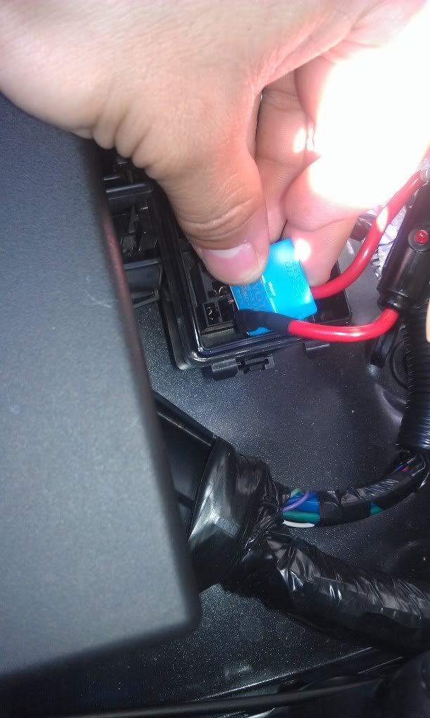

    So I don't have the relay where you would tie into. Any one care to help me out with this mod
    60cc2032-03d2-48dc-9d44-199b29f93810_zps_77d582a9b1c08c9f007cd33e705fe8063dc63761.jpg
  11. Jun 28, 2014 at 6:58 PM
    #91
    V5ioV
    V5ioV [OP] My drinking team has a wheeling problem
    Sep 22, 2012
    #87502
    8,244
    V5ioV
    Out n 'bout
    '13 Pewp Water Slut
    King 2.5 Rem Resi Ext Travel w/comp adj w/700# springs, TC Uni-Ball UCAs, ARB/OME Dakar Leaf Springs w/ King 2.5 Rem Resi w/comp adj and custm eyelets, Stealth Custom Series F-5 Wheels wrapped on: 285/75/16 Fierce Attitudes, BORA 2.25 wheel spacers, GOODRIDGE extended Brake lines, Triple-6" Double Row LED Light Bars behind lower grill, ATFL MOD, TRD Ball Type Shift Knob, Husky WeatherBeater Floor Liners, 60'' HiLift Xtreme, 4xInnovations Bolt-On Sliders w/Kickout, Spring Hanger Skid, Custom BlackPipe Fabs CMC and custom FYL Bed Rack, CVT Mt. Shasta RTT, Trasharoo, 4xInnovations HiLift Bedside Mounts, 4xInnovations Front Skid Plate, TOYWERX Ghost Raptor thin-lip Satoshi Grill, RedLine Hood Struts, 4xInnovations Transmission Skid and T-Case Skid Plates, Wheelers Rear SuperBumps Bump Stops, All-Pro Off Road U-Bolt Flip Kit, UltraGauge, ARB OBA, Pelfreybilt HC rear Bumper, Rotopax system (Single Mounting Plate and Bed Rail Mounting Plate both with LOX handles.
    Good to hear!!
    can you post a pic of what these boxes look like on the 12' and up SR5s please and we try to figure it out

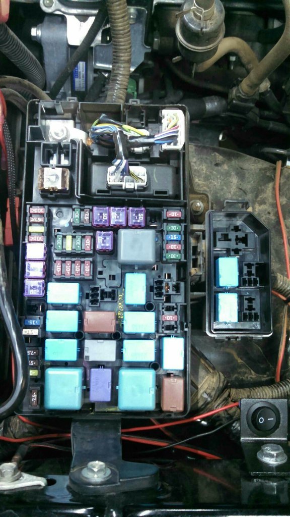

    Here you go

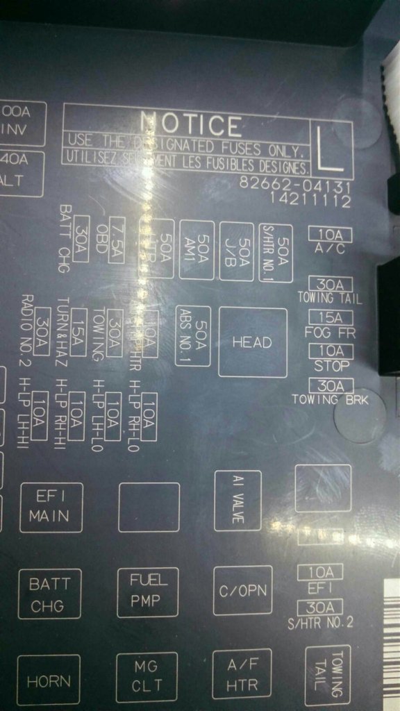

    Could you look in the cap and tell me what this one is? You might have to tap into the mail fuse box...
  14. Jun 28, 2014 at 7:11 PM
    #94
    tacodane
    tacodane The Slow But Getting Somewhere Build
    May 25, 2013
    #104898
    4,902
    Dane
    2013 Tacoma Prerunner SR5
    Led Interior Lights AFE CAI Stage II, Aero Turbine 2525 Muffler Snugtop Cab-Hi shell TRS Retrofitted Headlights

    #87502
    8,244
    V5ioV
    Out n 'bout
    '13 Pewp Water Slut
    i dont see AC SKT relay on yours…. you could tap to something else (+) that preferably does not stay on even after you kill the ignition!

    Would it he possible to tap into the efi 10a fuse?
    from some reading i did you dont have the relay i used because that relay is for the bed outlets….

    You probably can... but not sure if it's recommended... I would feel more comfortable using the horn relay for power...
