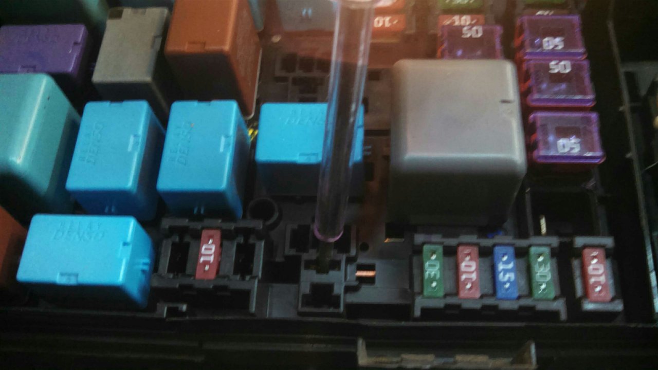

    For the horn relay what tab do I tap into

    I'll take a look tom in day light...
    Do you have some type of probe or tester.... i just figure the horn will work but it wont turn the fogs off when turn the car off.

    I can get use to turning them off. Like something you check for fuses?

    use the EFI MAIN relay,

    Do you thiink I can tap where the tester is?

    Is that the EFI Main and Is it (+) with ignition in and dead with ignition off

    There is no name for that spot and its hot with ignition off
    Edit. Got the efi relay and found the tab I need to tap

    if its hot with Ignition Off you have to make sure you turn off the fogs… I like that mine will always shut off with Ignition Off

    Found the efi relay and the tab that's hot with ignition on. hopefully this works will be giving it a shot today
    Is there a specific wire that's needed to do this or would 22g wire work?

    I used 18g. To be safe I would use larger than a 22g. Someone please correct me if I'm wrong.

    What question was that? Maybe you should use a bigger wire than 22g. I just checked and I used 18g wire. Does any one have a wiring diagram of the fog light mod?
