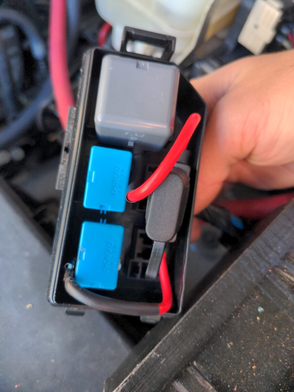

    Anyone have problems with your fog lights turning on randomly after you shut the truck off? I did this mod about a year ago and kept having problems with it. I don’t think I did this exact wiring route but something very similar. Just wondering if I redo it like this if I’ll have any problems.

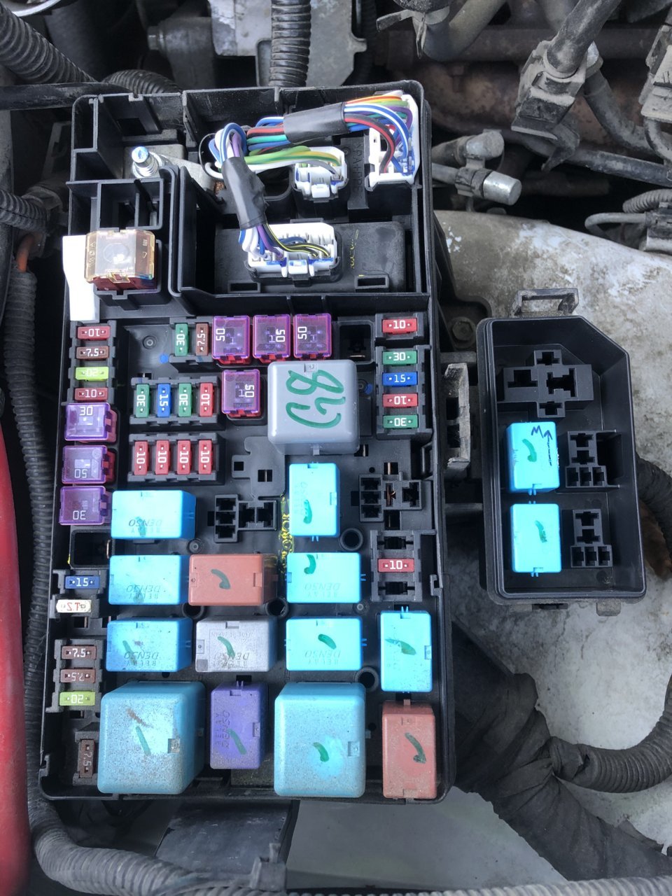

    I don’t have the grey relay box, where are people getting their ignition power supply from?

    Thanks! I actually went off of the washer fluid pump from inside the cab with a add a fuse. I’m not a big fan of slicing into oem wiring. Mine can be ripped out and returned to stock in 5 minutes.
