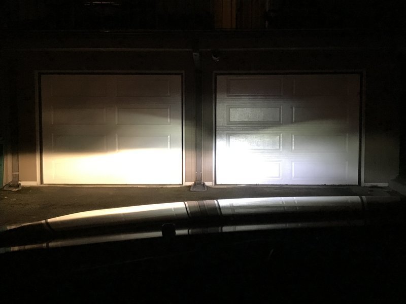

    Those are beyond awful. They have terrible output and massive glare with no cut offs at all and a disaster of a beam pattern while also not projecting as far as stock.
    Halogen left vs Opt7 right
    The glare/light above the horizon on the halogen side is actually from the Opt7 led as it has no pattern control or focus.
    lynyrd3 and Too Stroked like this.

    I've had mine for a few years and I love them. They are nice and bright and I get great beam pattern. I go out to the desert a lot and they are great for dark night driving.

    Do you get flashed a lot? I have a hell of a time with glare driving at night and those types of bulbs with no pattern cut off just kill me.
