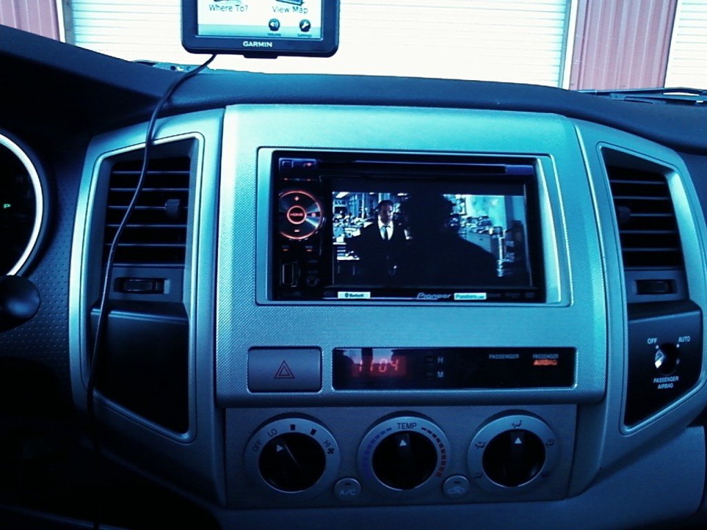

    I called Crutchfield (800)555-8211. I did not talk to a sales person, I went to tech support. Told them what I wanted and they made the recommendation to go with the Pioneer AVH-2400-BT. I got the wiring harness that worked with steering wheel controls. Use CAUTION. Make sure that you get the trim kit #12095821G and not the 120998214G. The difference is in the trim plate and the angle of the mounting brackets. I solder and heat shrink my connections, but using any type of friction connector will probably work OK. Crutchfield does not charge tax, shipping and will include the mounting kit for FREE. They also offer free return shipping and a 90 day return/exchange policy. The aVH-2400 will also let you hook up a back up camera if you want one. I bought the bypass relay for $10 bucks http://www.ebay.com/itm/Pioneer-Parking-Brake-Auto-Override-Bypass-AVH-P1400DVD-AVH-P2400BT-AVH-P3400BH-/150749090410 and wired it in as I installed the unit. My phone paired up perfectly. I installed the microphone to the left of the overhead console and it does not interfere with the sun visor or mirror. It has good sound resolution as well. The only thing this unit does not have is that it will not "speak" or write out a text message for you (I got spoiled in my 2011 Mustang), but you will get an alert that you have a text message by a tone. You will need to parking break bypass to use the onscreen phone dial pad. This unit will also play movies downloaded from the internet, MP-3s from a flash drive, and allow you to customize your background. Here is a photo I took while watching Green Hornet. Oh, this unit is $300, delivered. The only thing extra you have to provide is the wire connectors.
    Note the trim kit

    P.S. This unit also has an "auto" dim feature (orange wire with white stripe on the harness), so what when you turn on your headlights, the main part of the screen dims (great for night driving), unlike the Pioneer FH-X700BT. I have factory speakers and the movies play in a more like HD sound. I highly recommend this unit for price, ease of installation and the entertainment experience.....but you have to get the parking break bypass (not through Crutchfield) or you will be limited as to what features work.
