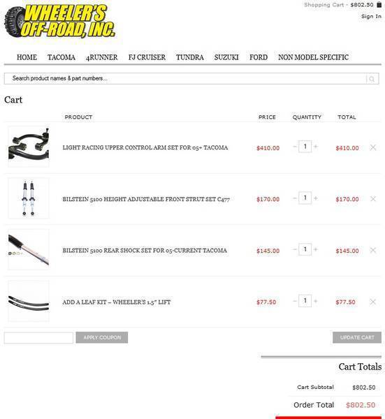

    Bilstien 5100's with a AAL and LR UCA's and call it a day.

    I'd say this is a pretty good start. As for my budget, I'd love to keep it under $1000 installed as I still need to get tires and I have a few more things I'd like to get.

    Thanks for the Wheelersoffroad link. I like the input y'all gave. I guess one more question. Since geekhouse23 said he is replacing the AAL with a new leaf kit, what are your opinions on the OME complete suspension kit offered on the wheelersoffroad site? Are the Nitro shocks better or worse than the Bilstein's? I like the build SoCalTaco65 provided, but the info about the AALs is sort of what I've been hearing lately. I guess the difference between the OME kit and SoCal's is the addition of the UCRs.
