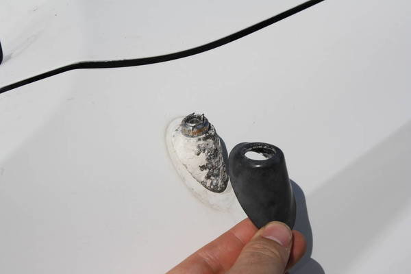

    The corrosion starts and is primarily under the black cover of the antenna base.

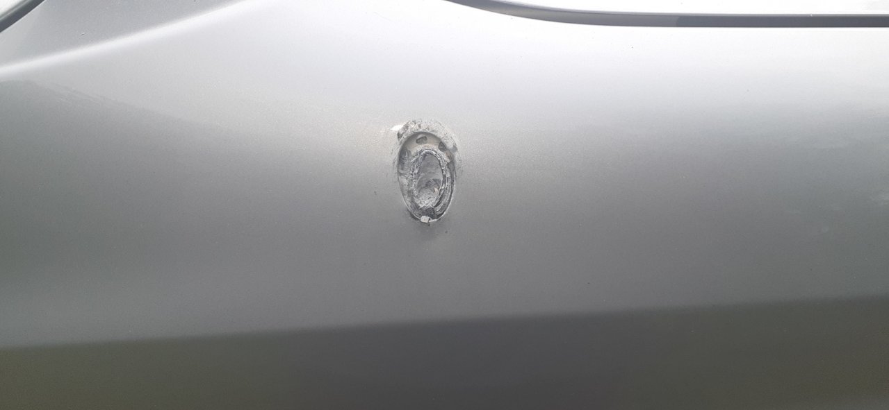

    so i am going to try and fix this today. i have the day off.
    im hoping i get get the castle nut off with vice grips. i dont want to get the drill out around my hood.
    i have all the parts im just waiting on the fender liner clips. i was just going to break them off and replace with new ones.
    do i need the clips to hold the liner on or are there bolts that hold it on until my clips come in.

    so i started working on this but im going to need the clips. they arent coming in until saturday.
    i did manage to get the castle nut and bezel off. used a 3/8 drill bit. then went a size bigger and went slow at an angle and it all broke off

    A new radio will still have the antenna plugged into it.
    OP has a bad antenna base mount. A new radio will still result in only 2 stations unless the base is fixed.
