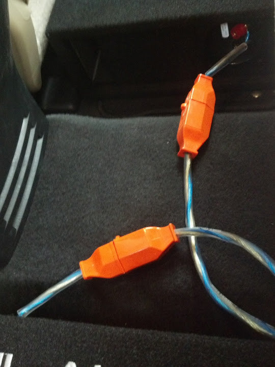

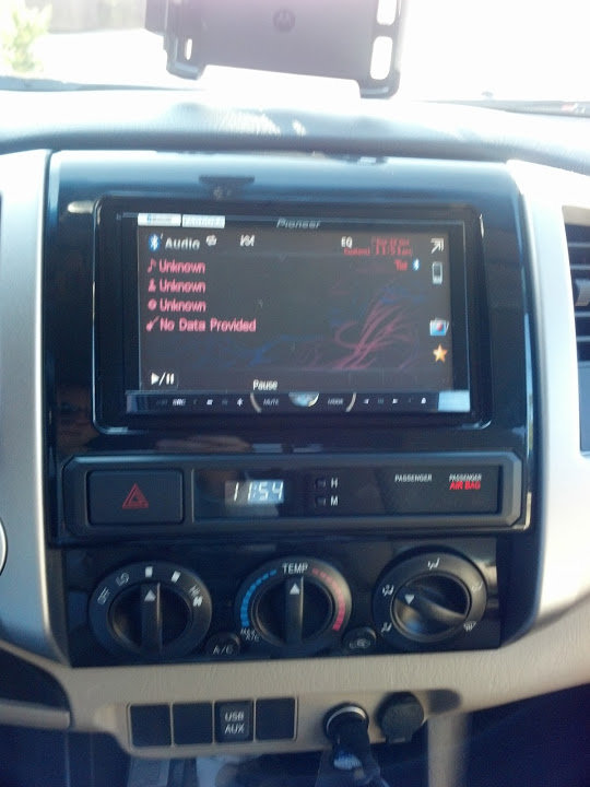

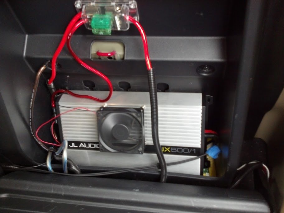

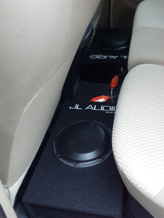

    Well, you can do a lot of things, but this would be my recommendation. Here is my story and recommendation.
    I bought a 2012 tacoma with the new style radio, not touch screen entune or jbl. I decided it was defiantly ready for a speaker upgrade. I bought all polk audio 1001 tweeters, db690 6x9 for front, and db 650 6.5 for rear. I tested it out and got a wicked high hiss coming from the speakers. The sensitivity of the new tweeters and speakers brought out the poor quality of the factory radio. Drove me nuts. I bought 40ft of high quality 8 strand audio cable. I cut it in half to have 2 runs of 20 ft to the back behind the rear seats. I bought a Alpine F300 4 channel amp and mounted it behind the rear seats and ran power from the battery. I pulled the radio and cut the speaker wires coming out of the radio and connected one 20ft strand of speaker wires to the radio. That fed back to the amp. The output of the amp went to the other 20ft strand back to the radio and tied into the wires going to the speakers. Tested that out and still had hiss, but was much louder and all the power i needed. It was until i couldn't stand the hiss anymore i bought a double din kit when it came out by metra and installed a pioneer AVH p4400bh. No hiss and love the sound. Amazing sound. I've added a JL 500/1 and 2 JL CP108 micro subs running at 2ohm for bass. Sounds great. I did remove one 20ft strand that ran back to the amp and used 3 sets of RCA's front, back, sub. I added a pioneer xm tuner under the drivers seat and ran the wires to the radio. Also spliced into the existing xm shark fin antenna wire so i would not have to run a different antenna.
    AVH-P4400BH, steering controls and park brake bypass, Tied into existing backup camera feed.
    Alpine 300 4 channel
    JL audio 500/1
    2012 Metra kit
    XM sat tuner tied to shark fin antenna
    2 DXI690 polk front
    2 DB1001 polk tweets front
    2 DB650 polk Rear
    2 JL audio CP108 micro subs with easy connect plugs for easy removal
