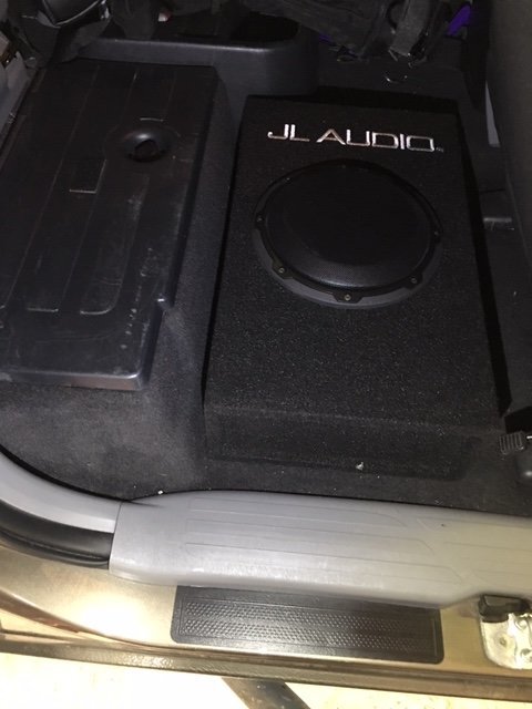

    This is what I'm going with. I wanted something that could be removed and I wanted it to fit in the rear footwells. This way I can put a platform in the rear but still move things around if I want. It's a perfect fit. I'll run 2 of these.
