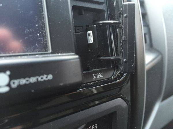

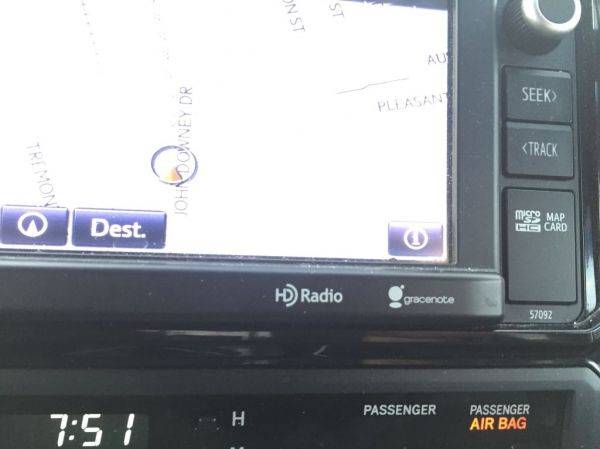

    Correct. There will be a card on the lower right.

    Where would I see this memory card slot? The pictures I have seen in this thread look just like mine, but I have not seen a memory card slot. Nice truck by the way, I have the exact same even the same colour but mine is an 07. Is yours a manual tranny?

    Bottom right

    Ahhhh! OK thanks for the info. I guess I do not have a nav unit. Happy New Year!

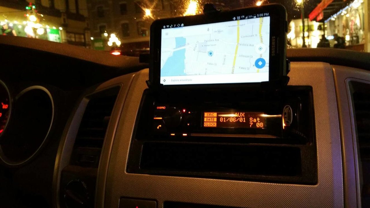

    Yah this is my current setup, so I have all the above covered. I drilled a ballmount through the top of the bezel and mounted a slipgrip for my Note 3 in an Otterbox.
    I just hate the stupid single DIN fit kit. It rattles and looks like a cheap piece of chinese plastic crap. My XM is mounted seperate in my console. This setup works great when in the backcountry using Backcountry Navigator and Topos.

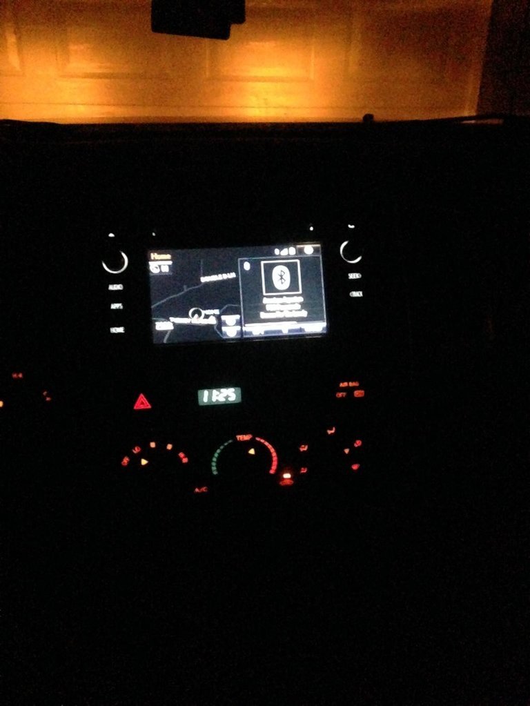

    5BFAA059-06FF-42DA-8AE2-A273E6233C5A_zps_fa18df1c56e82cb2d1dfbb15600b5ad50652e464.jpg
