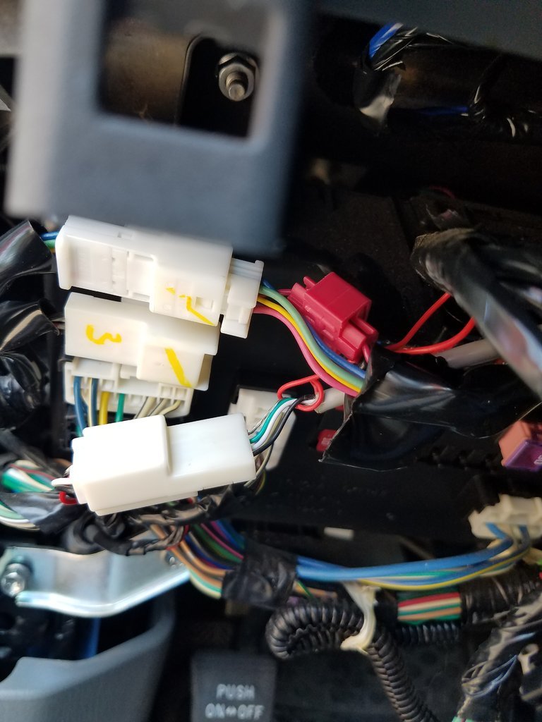

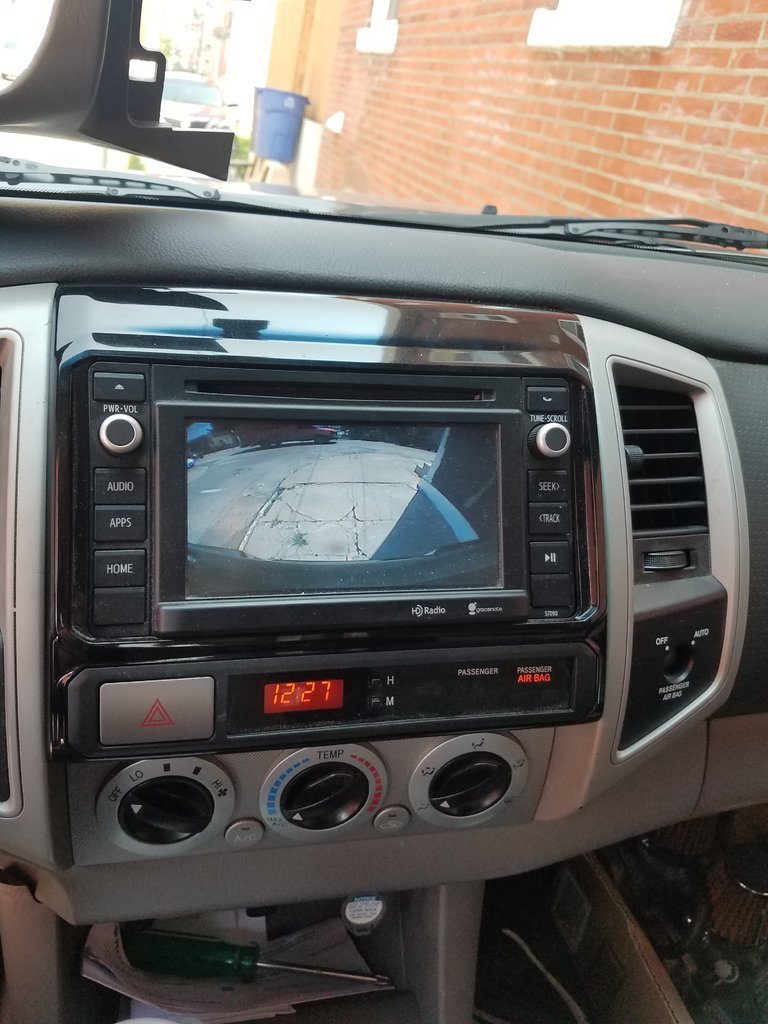

    So I actually bought the camera source harness but it was for up to 2013 trucks. The plug on the radio end of the harness would not fit into the radio. All I had to do was cut off the locking tab and make sure the plug was positioned all the way to the one side of the radio. It was towards the passenger side of the truck IIRC. Routed the harness thru the dash to the fuse box by the drivers left knee. That side of the harness plugged right into the camera plug. the 5th wire in the harness is the reverse trigger. I actually figured out the reverse trigger this morning by doing exactly what @hx989 had said. It took some probing but I found it. On my truck it was the plug of wires right next to the camera one. I'll upload a picture later. but yeah I started searching around and found your thread @klavender1 that was what really kinda pushed me to finally get this entire thing done with. its been bugging me for a while. too many small-ish projects going on! at least now one is checked off the list.

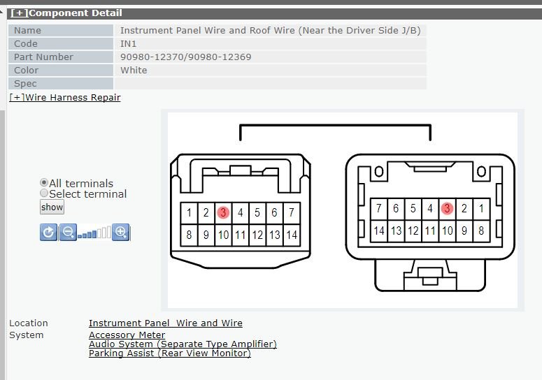

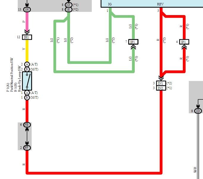

    Was this camera done on an auto or manual truck? I do not have a reverse signal at pin 11 on plug IN1.

    I have an auto. I have access to Toyota TIS at work. I can look Monday to see if I can find the reverse signal for a manual.

    mine is a 2009 auto. in the 2nd pic, you can see where the connections were made by the fuse box. the bottom connector (in the 2 connector stand-off package thing) is the camera wiring. this plugged right into the camera source harness. the harness had a "loose" wire that needed to pick up the reverse trigger signal. for mine, it was in the connector above the camera one. I forget exactly which wire, but I just probed around with my meter while the truck was in park and reverse to see which one had voltage in R. I think it was a red wire right next to a purple wire. on the radio side of the harness, I had to insert the reverse trigger wire into the plug next to the camera plug port. Unfortunately I didn't take a picture of this. it was tricky because the wire is so bendy. I found out the hard way that there's a locking mechanism on the plugs that when lifted and unlocked will allow the wire to seat fully. then snap it back down and lock it up! I had tried pushing the pin in the plug with a small flathead screwdriver. in doing so, I tore up the insulation on the wire, but a little tape fixed that right up!

    I think Ive read only autos have a 12v signal there, you havet o source it else were in a manual
    Thanks I only had a little bit of time to dick with it before my hockey game tonight. Im gonna tear it back apart and start probing stuff Sunday if I get time.

    For the 2011, use pin 3 instead of pin 11 for your reverse signal. It's the same connector I used for the reverse signal. The connector is right above the camera feed connector. And it's a red wire.

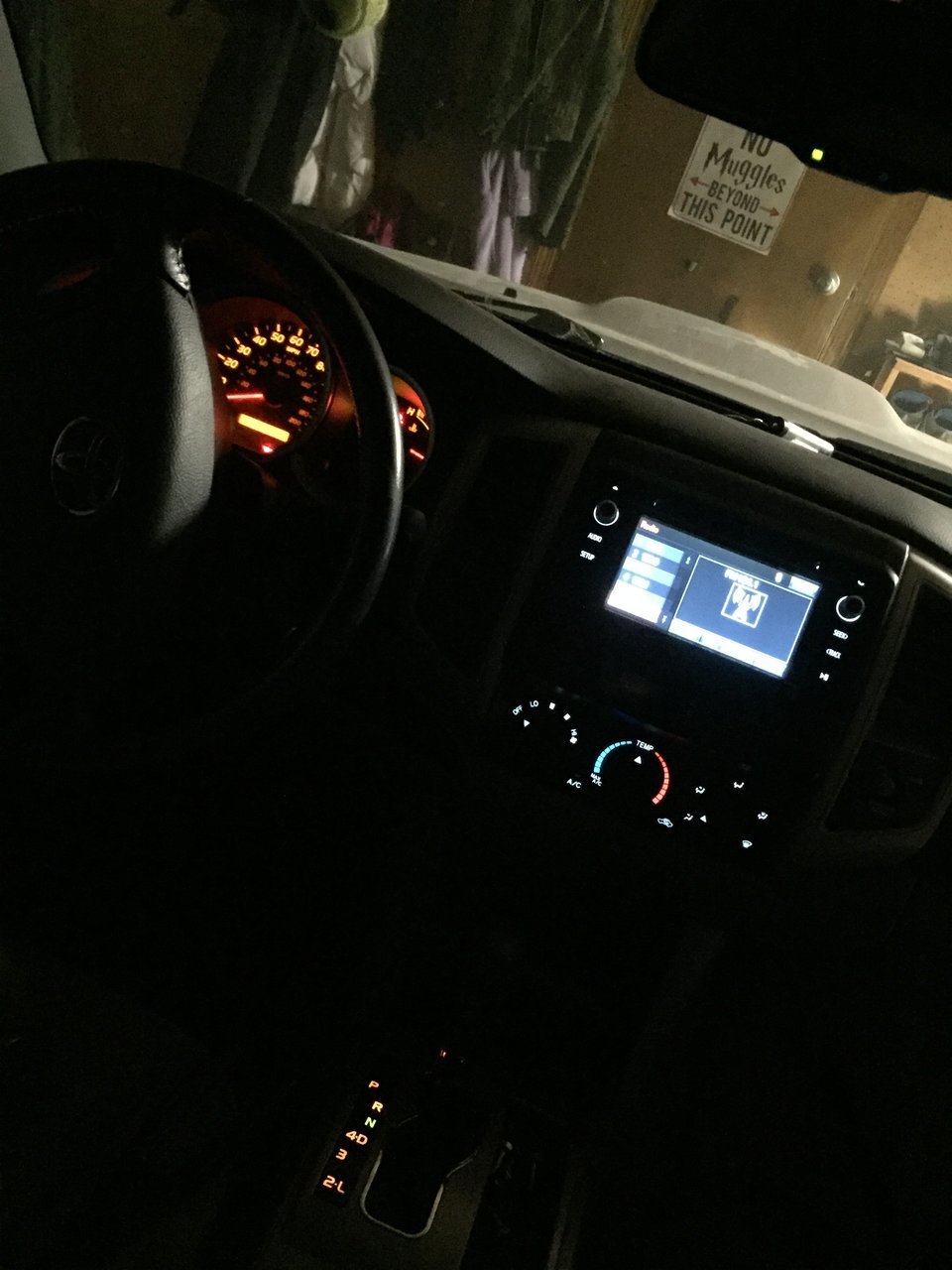

    This thread helped me out a ton! Thanks! Here is my setup
