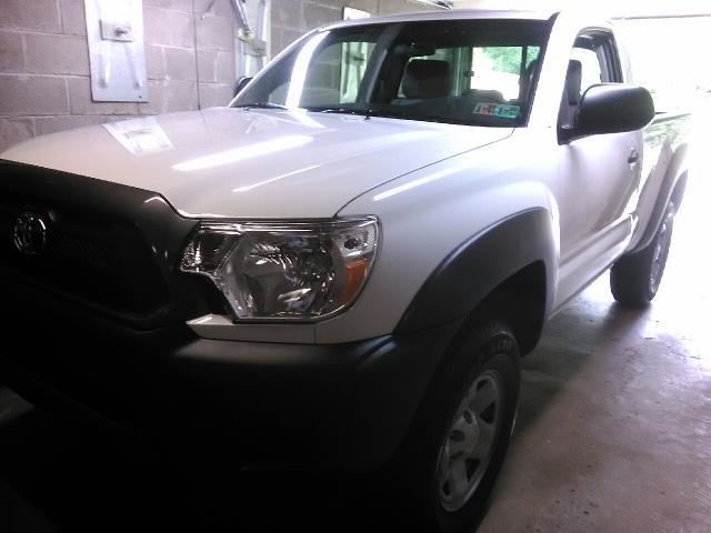

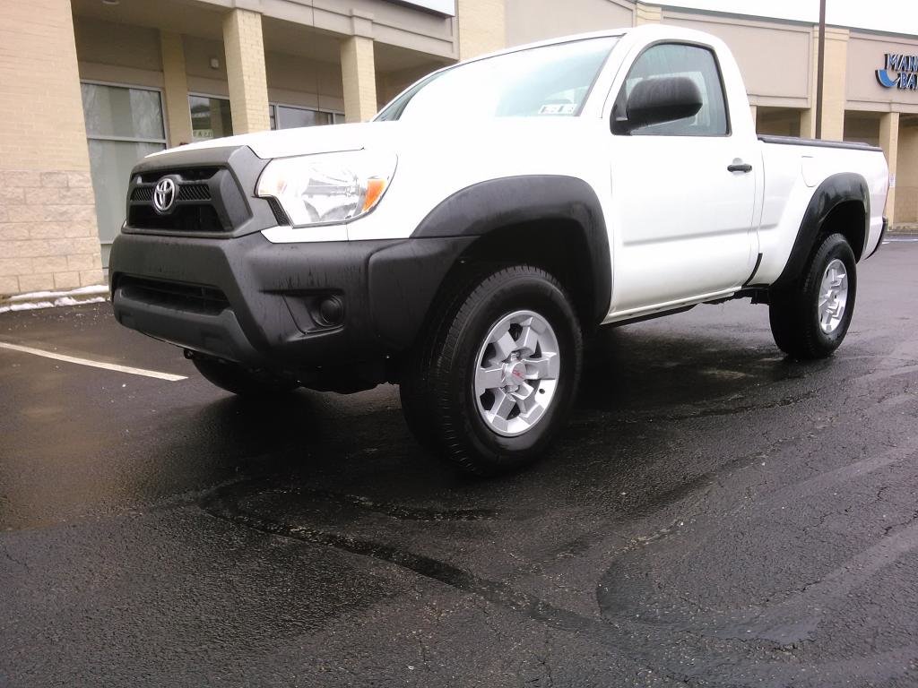

    2014 Regular Cab / 4WD / 5 spd
    Purchased new in June 2014
    Only modifications are:
    -Level 8 MK6 16x8 0 offset gunmetal wheels
    -Michelin Defender LTX M/S 245/75/16 tires
    -TRD center caps

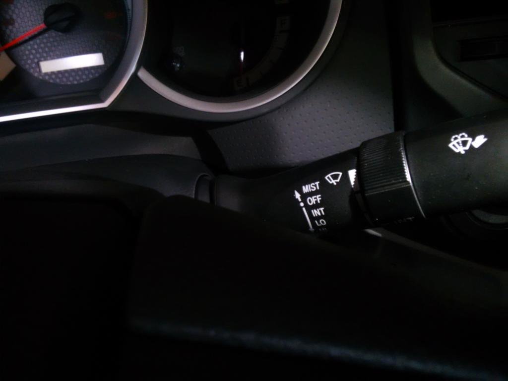

    -Intermediate wiper stalk

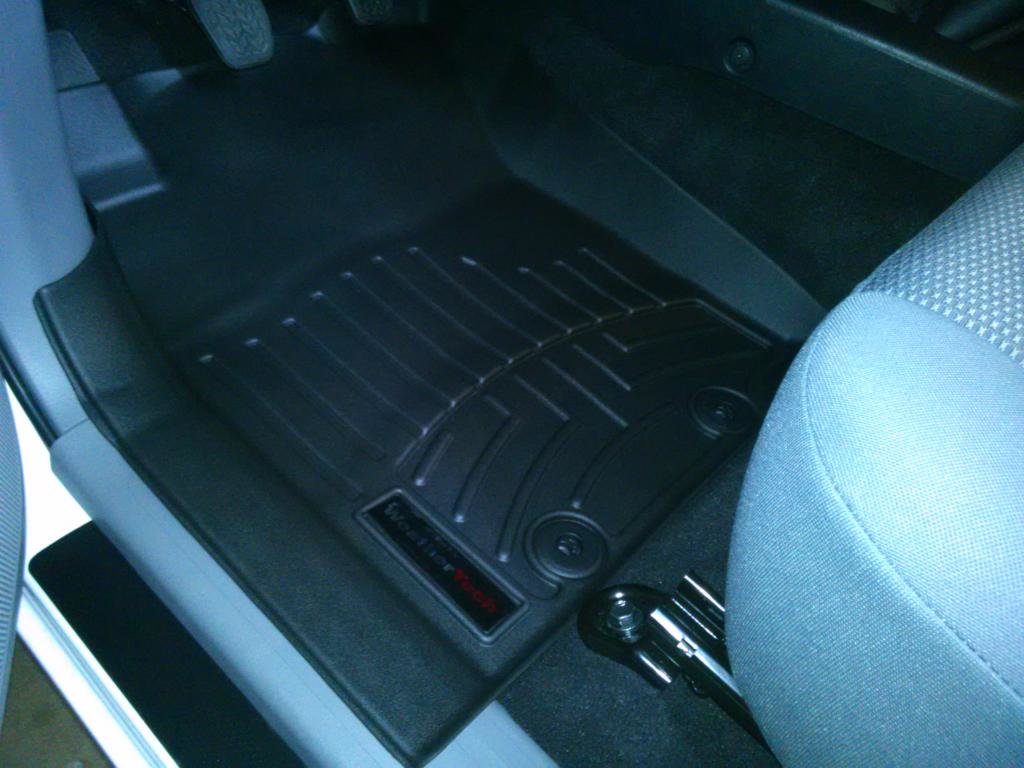

    -Weathertech floor liners
    -Access LiteRider tonneau cover

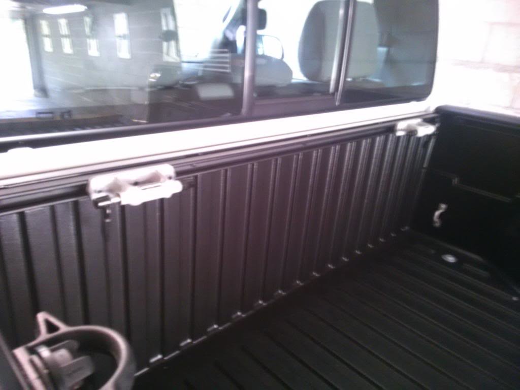

    -RockyMounts bike mounts
    -TPMS sensors in 10" wheel/tire
    -Over-axle exhaust chop
    New in June 2014 (removed mud flaps upon arriving home)
    Added TRD FJ wheels within 200 mi.
    Added Access cover in Fall 2014
    Added intermediate wiper stalk in Summer 2014
    Added WeatherTechs in Fall 2014
    Added bike mounts day of truck purchase
    Added Michelin LTX M/S 2's Winter 2014/2015KIMG1420_zpsebe507a2_b9920daf94ebdf3fa79b9f72a764a1377c755f1e.jpg
    Chopped the tail pipe Spring 2015

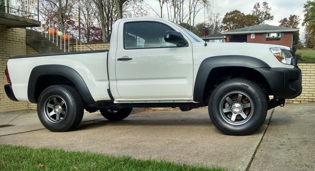

    Current setup Fall 2016
    - Level 8 MK6 16x8 0 offset gunmetal wheels
    - Michelin Defender LTX M/S 245/75/16 tires
    - TRD center caps

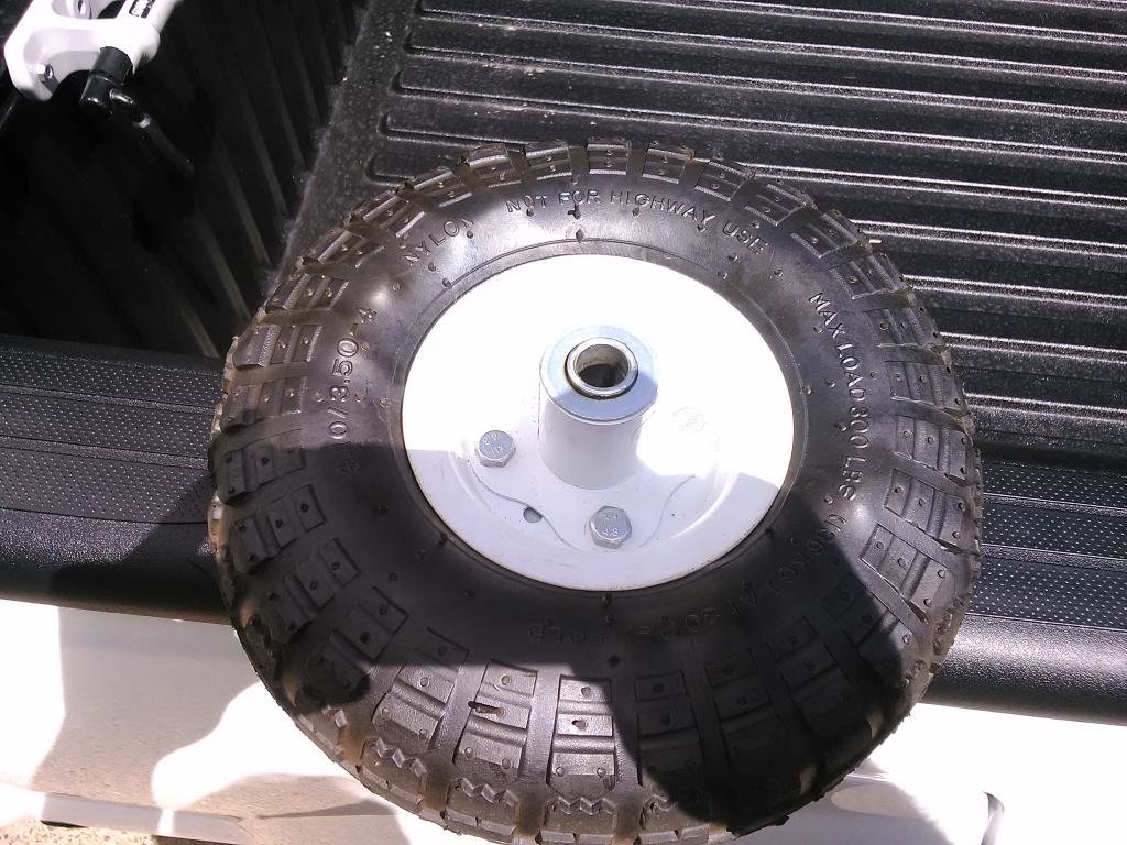

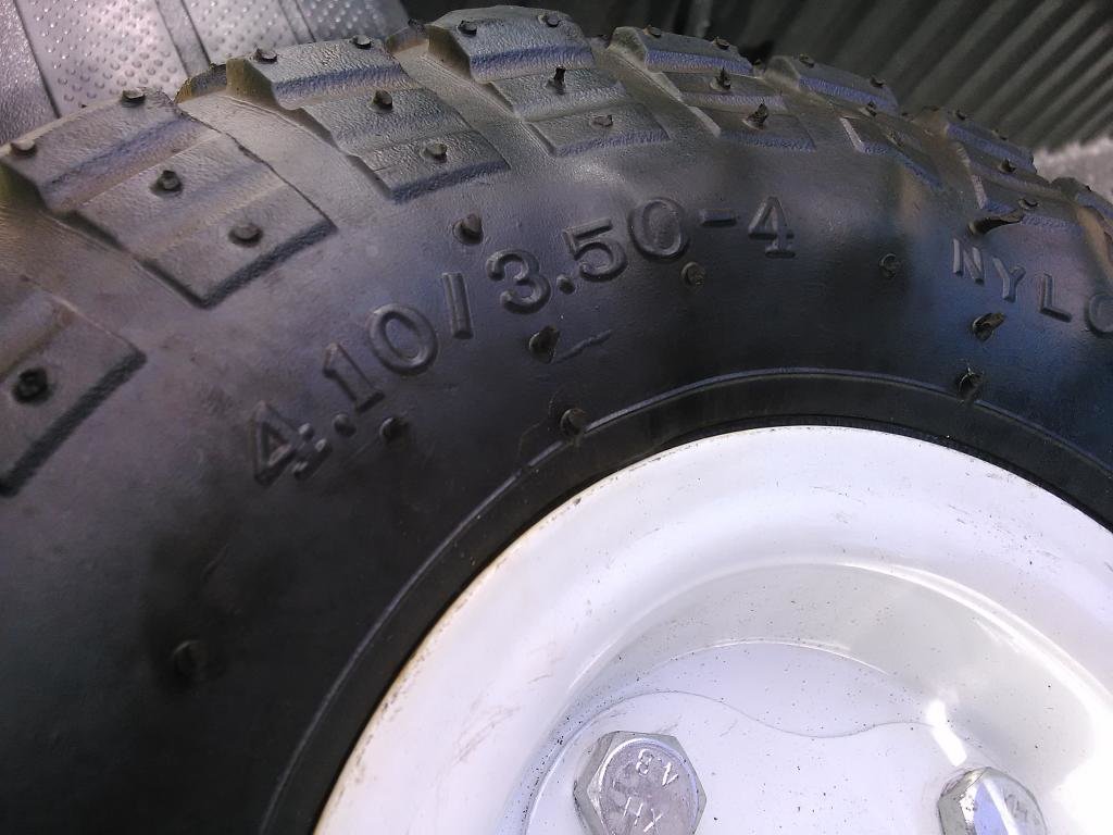

    To remedy your TPMS light issues, from not having the sensors installed... This is a $6 fix in takes 5-10 min.
    Go to Harbor Freight and buy this wheel/tire:
    Haul-Master - 10 in. Pneumatic Tire with White Hub - 30900 Deflate the tire
    Unbolt the (2) halves of the wheel
    Insert the TPMS sensors between tube and the tire's sidewall
    -make sure the sensor side (soft side) is against the tube
    -make sure the casing side (soft side) is against the tire
    Reassemble wheel
    -make sure the sensor isn't touching wheel
    Inflate to desired psi...
    -Place behind or under seat in vehicle
    TPMS light should go off within moments
    -no harm to sensors or vehicle
    I had to do this because I upgraded from my original 16" steel wheels to my 16" TRD FJ Trail Teams wheels... there are seperate TPMS sensors for OEM steel and OEM aluminum wheels. The sensors are attached to the wheel at different angle. Similar issues may arise with aftermarket wheels. This is a way to turn the TPMS light off.

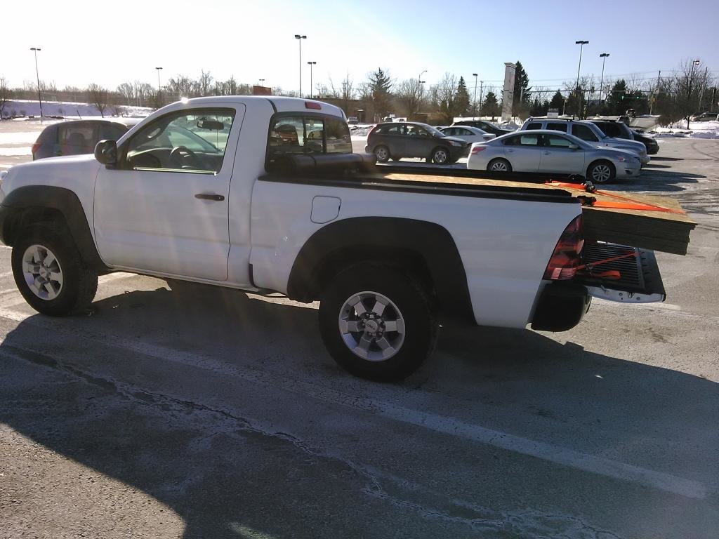

    Did some hauling... (15) 50lb sheets of OSB... -10* degree

    Interesting solution to the TPMS problem!

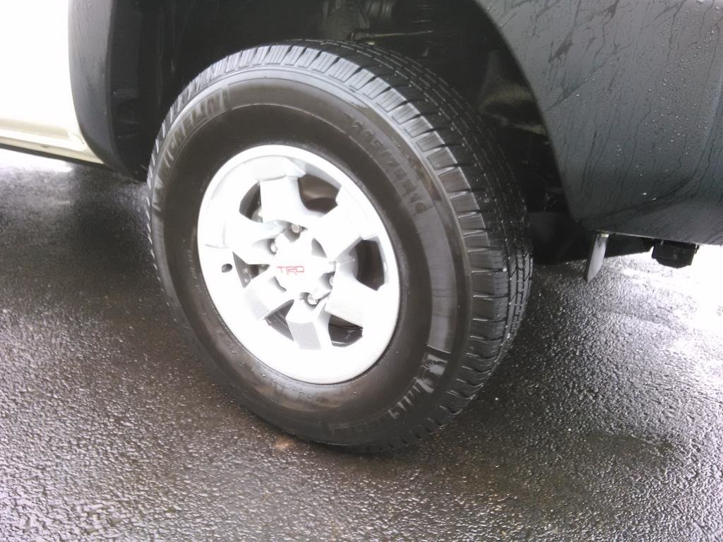

    Picked up some gently used 245/75/16 Michelin LTX M/S2 tires from TW member, OldSkoolArcher (Great guy to work with. Gentlemen) last week. Had them mounted/Road Force balanced yesterday:
    Differences, so far, from 245/75/16 Dunlop AT20:
    -wider tread width
    -subtle noise increase
    -smoother ride (better absorption of bumps, chassis is more settled)
    -increased steering feel (AT20's were nervous feeling)
    -increased traction while accelerating from stop, while turning

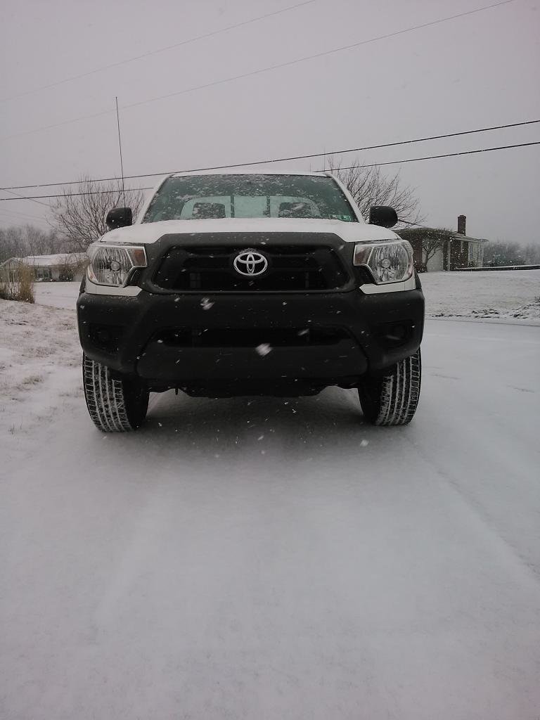

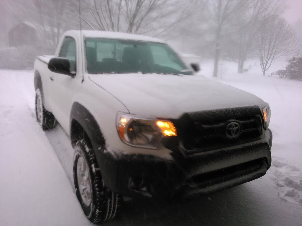

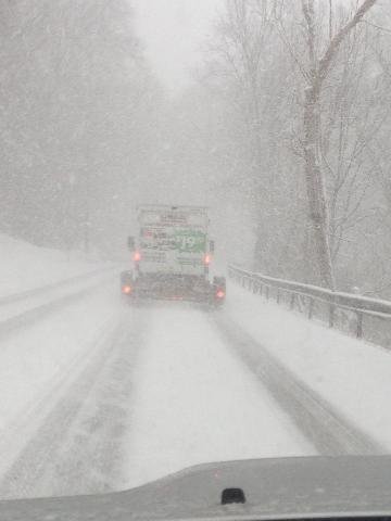

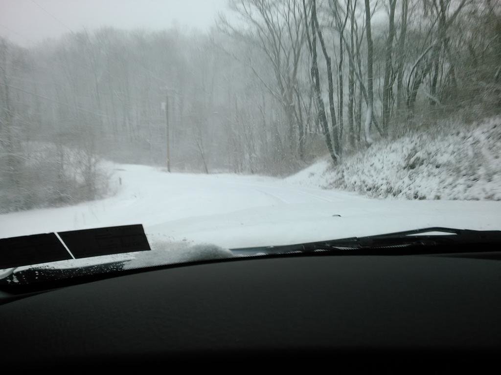

    Some more feedback: Got to use the tires in some light snow this morning on the way to work. Nice predictable handling. Used the Auto LSD on a steep uphill turn, 15 mph, 2nd gear... just dug in and propelled me forward. The Dunlops on that same hill usually needed feathering of the throttle, on/off. The M/S 2's just let the Auto LSD do the work.

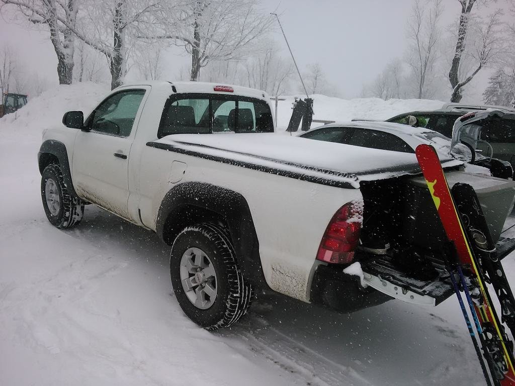

    Good times had to and from the slopes today

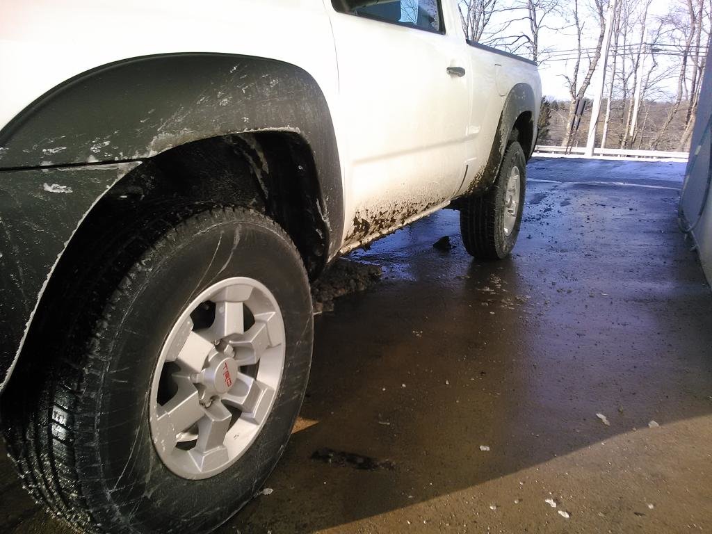

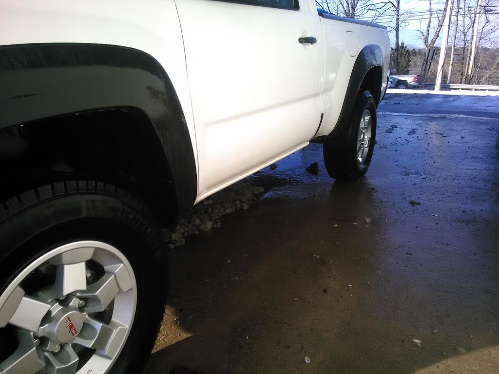

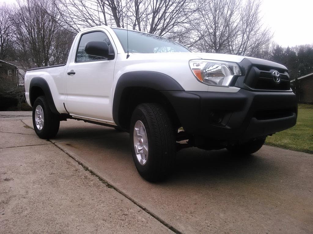

    Before
    After $2 wash

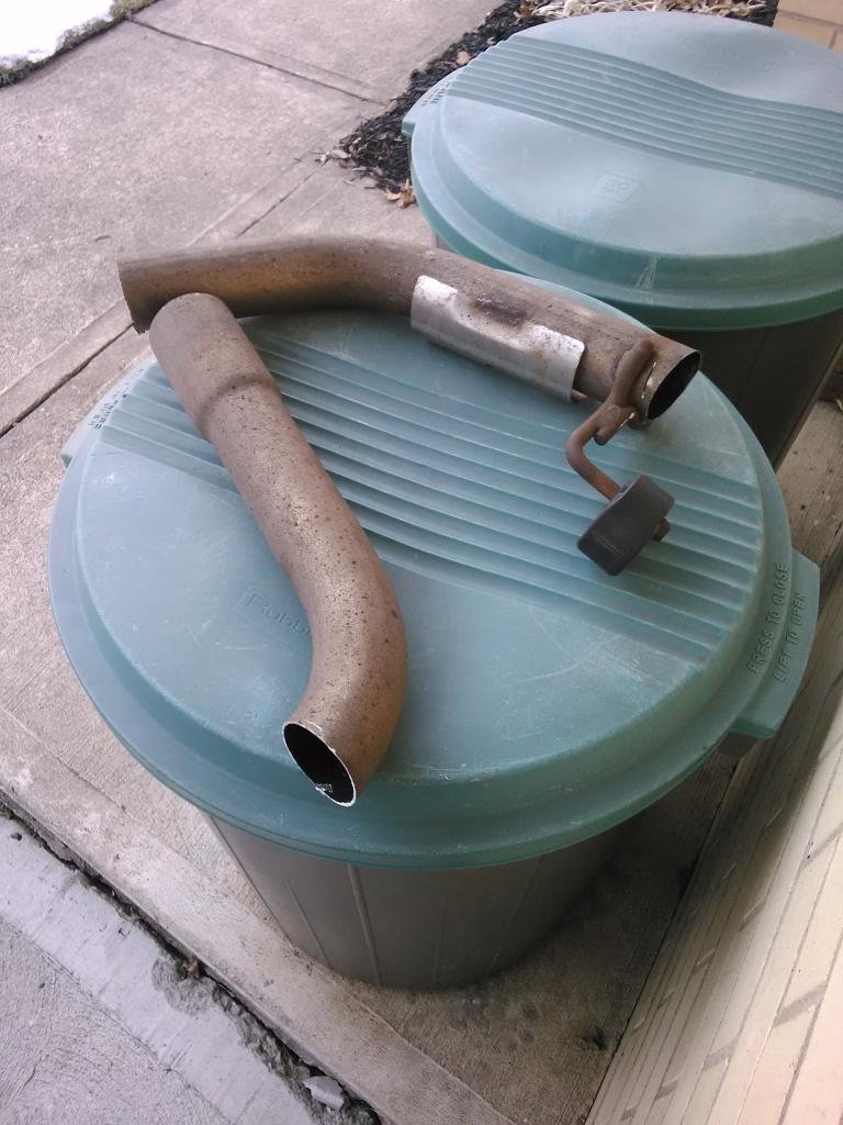

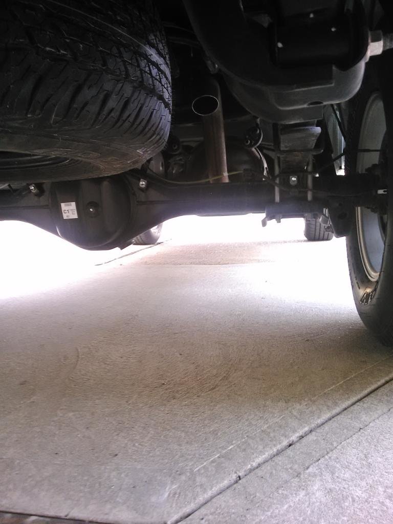

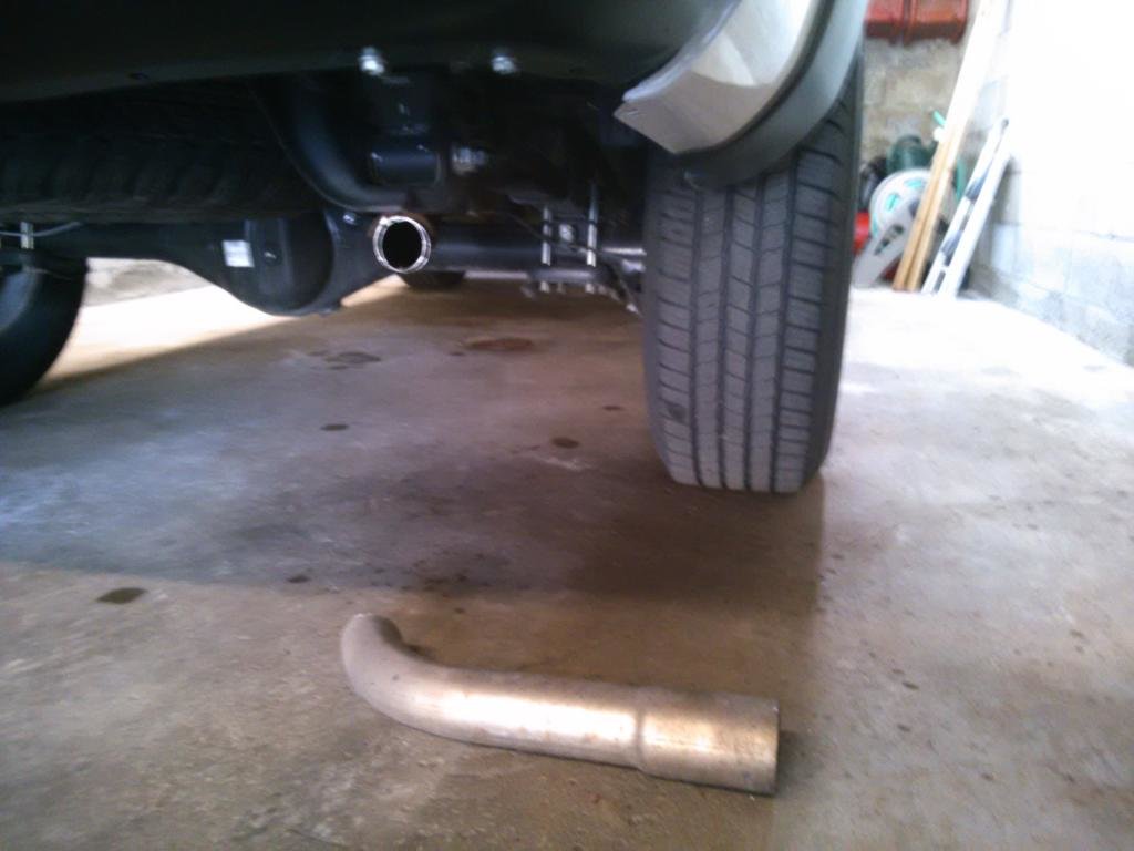

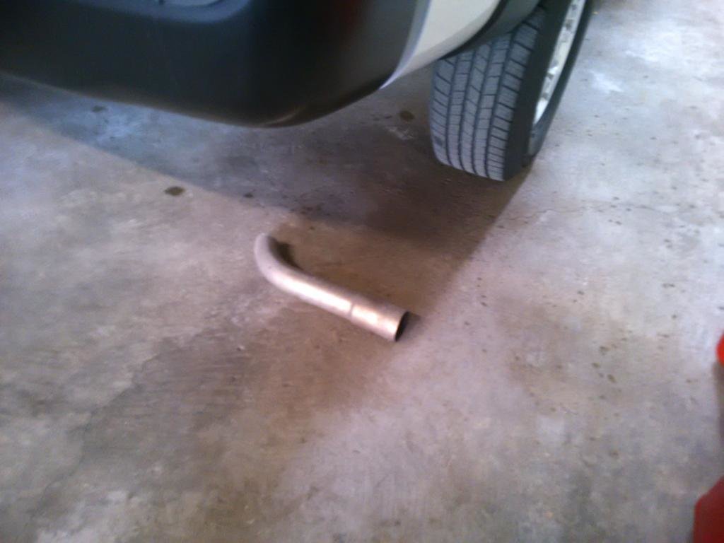

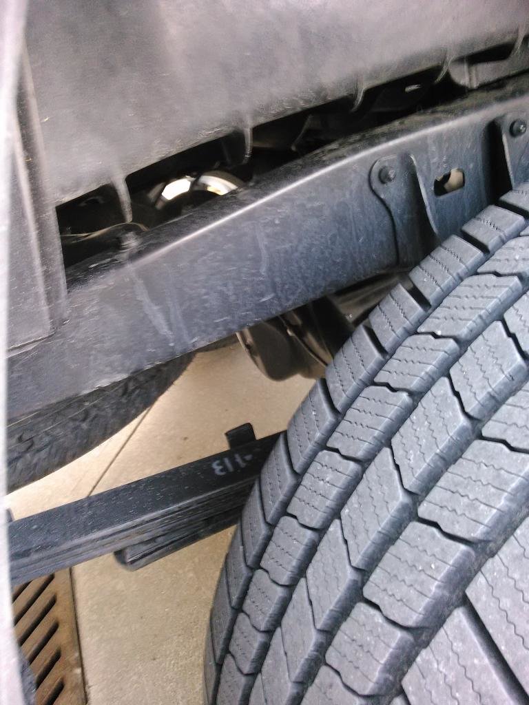

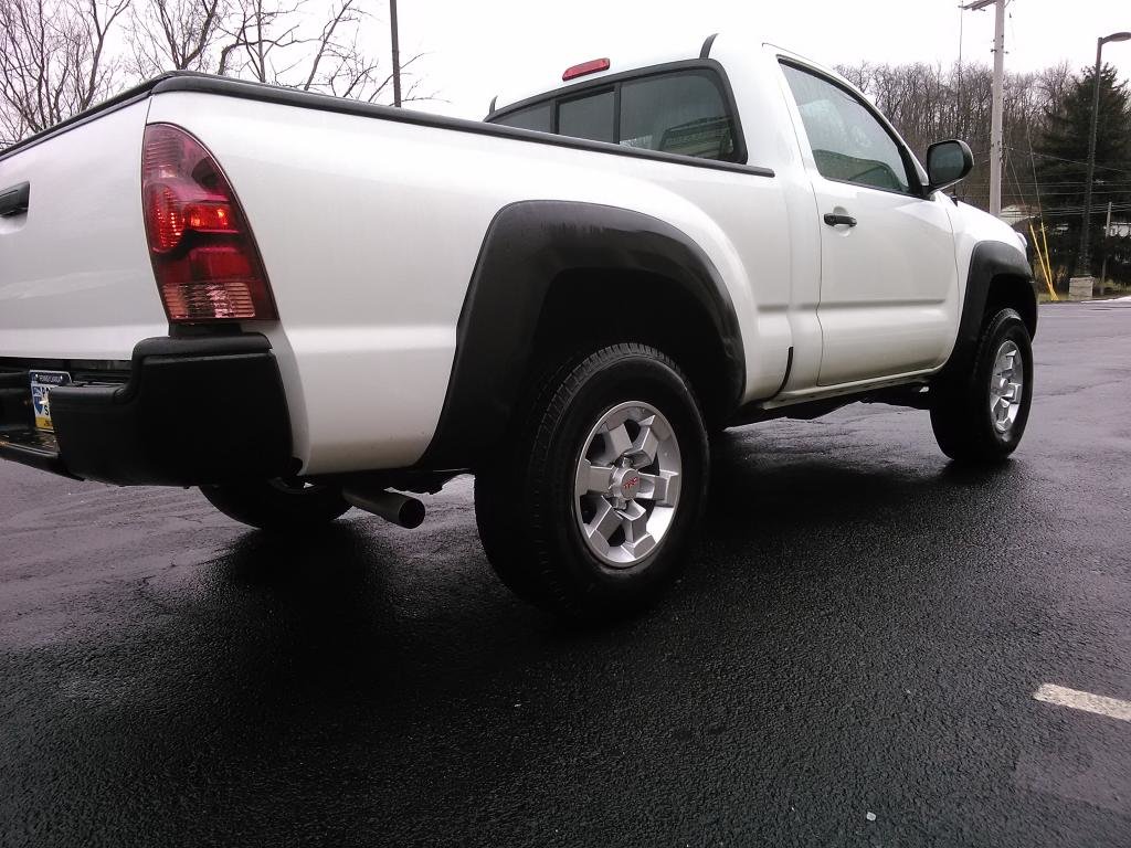

    Cut the tip off last night, at the 1st exhaust flange...
    Then decided it wasn't enough, today... so cut it at the downward slope, over the axle. Can't see it all hanging down at all now

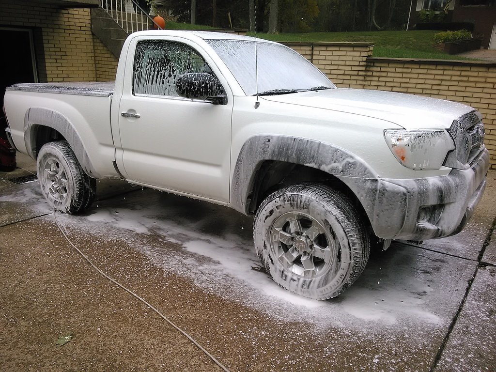

    Tested out the new foam cannon/lance a few weeks ago

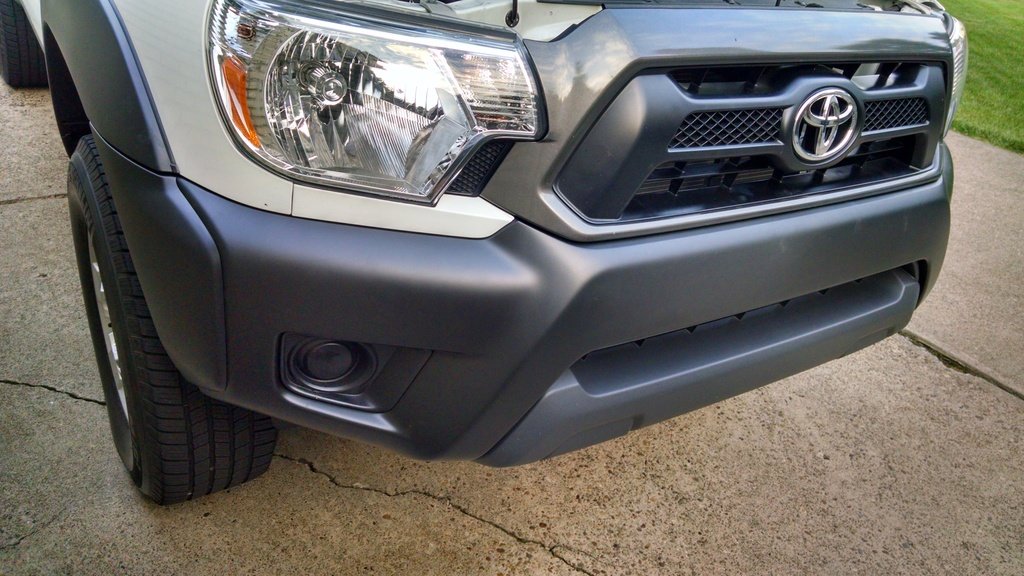

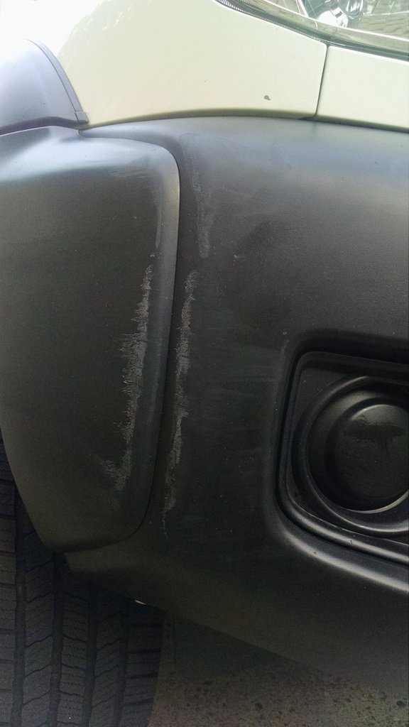

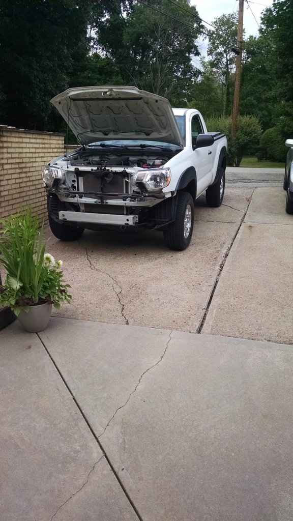

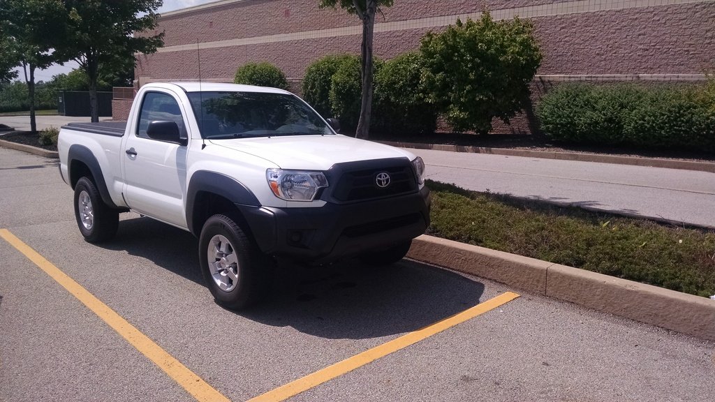

    Was parked here, at grocery store on Sunday.
    Someone did a hit-and-run on me
    Got a new bumper cover and flare extension yesterday from Toyota and installed it
    All is well...
