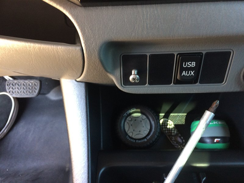

    To remove the switch blanks on the right hand side, I just carfuly screwed a screw into the blank and pulled it out since I'll be putting in a switch. If I ever need to replace the blank , I'll pick one up from the dealer or Bone Yard.
