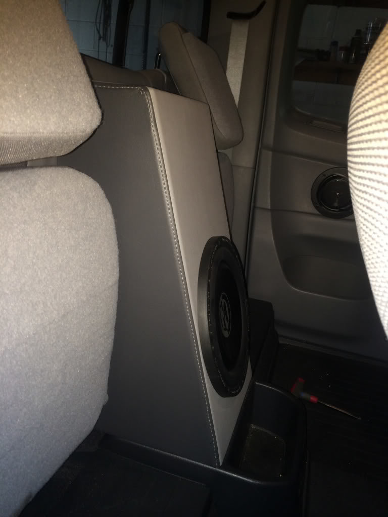

    Next, the speaker box. This took a lot of time to make, I estimate about 20 hours or so, and that's because I had my friend who is a carpenter do the wood working and gluing.
    The first step was taking out the console, cutting out the plastic storage bin, and removing the metal bracket bolted to the floor (save the bolts). I had to have my local car-audio dealer do the cutting of this console. I made 2" and 2.5" blocks, marked all the cuts with liquid paper, and took it down there. They did a fine job.
    After that, I made a cardboard mock-up with all the Amazon boxes I had laying around from getting this gear shipped to me. I used duct tape and did plenty of test fitting to get it right. This gave me the biggest ouside dimensions I could go. I have those measurements on a sheet of paper I lost. When I find it, I will post the external box measurements, as I'm sure there are some other people on this forum that might want to try this :).
    For the fabrication, we used 3/4 MDF, pin nails, and wood glue. The front plate is a bit bigger than the sides of the box, about 1.5" bigger. We had to do a lot of sanding/hacking to get the Alpine sub to fit in the hole. There are 5 big spokes cast into its frame and they go back quite a ways. On the sides I had to shave down a lot to get it to fit in the box. I will post box measurements and cubic feet calculations in the next post.
    All and all I'd have to say it looks and performs great. I bolted the sub box into the frame on 4 corners with plummer's tape and bolts. The Tacoma already had 4 pre-tapped holes. The ones in the back I re-used the metal mounting bracket screws, and in the front, I bought my own bolts and used some unused holes under the drink holder. I think these were holes for the 450 watt 110AC converter, which my pickup does not have. I have a bass box instead :)
    The box is wedge shaped to clear the e-brake cables and follow the contour of the transmission channel between the seats. Here's a pic of the box before I clamped it:
    Here's a pic as we were test-fitting the sides. I cut the top, bottom, and speaker plate (back of the box) to the full sizes, and I subtracted all the 3/4s off the sides:
    Had to turn the sub a bit to get those damn frame castings to fit in the box. Note the R-mark I used as a reference. I had to take off wood with a saw-zall for about a hour to get it to fit. I estimate there's still just a bit under 1/2 of wood left under the thinnest part. Hind-site is 20/20, but maybe using 1/2" MDF might have been better.
    Some pics of the finished install. I did get some glue marks/stains on the visible carpet by the speaker. And I have some wood showing on the top of the speaker plate. But still..it cost me about $120 dollars to make with the sub. The JL stealthbox is $650. I'd like to claim a win here, but I'd have to hear a stealthbox before I could. Maybe my bass sucks and I just don't know it :)
    Here is a pic of the inside of the center console. The box is sloped down about 1/4" at the back of the console by the drink holders. I didn't cut the bottom of the drink holders off, I made the box so it would just clear it.
    I plan to seal up a few channels and holes in the center console soon, but it is not as bad as I thought it would. Even pens don't fall down the sides. The console is almost 3" deep, and still plenty usable. It does vibrate a lot when I have the tunes kicked up...but that is the whole point.
    Finally, here's a pic of the system with the seat tilted so I can make amp adjustments. This isn't as much of a pain as I thought it would be. Eventually when I have the car audio dealer who does the HATs set the crossovers and gains, I'll be able to re-hook that plastic anchor that carries the seat wireing harness and never have to tilt it again.

    Found my sheet I made with my measurements to build the box.
    All the measurements in this graphic are exterior dimensions. You have to subtract off 3/4" of an inch from some pieces to account for the size of the MDF walls. I subtracted it off all measurements for the sides, and I think I did from the top and bottom of the front piece. The Top, bottom, and back pieces are full size. The back piece (the part with the speaker hole cutout in it), has to be full size and glued onto the end of the top,bottom so you can make the sides about 1.5" longer than the main width of the box. The speaker needs the extra wood to make a good seal. For my speaker, an Alpine type-r 8", the cutout diameter was 6 15/16". But the full exterior diameter of the screw holes is 7 5/8". That's about a half inch wider than center console is. No problem as this back piece sticks out of the end of the center console.
    Basically in the center console, you have about 7.25 inches of usable width, and 14.5" of depth. My pickup has a manual shifter, but I think these measurements will be about the same for the automatic based on some 2015s I was looking at today at the dealership today.
    The little red circles in the picture are the speaker cutout and a cutout for the terminal cup. The speaker was 6 15/16", the terminal cup was either 2.75 or 3, I forget which one. Terminal cup was easy to cut with a hole saw. The speaker cutout was harder.
    One more thing, you'll have to bevel cut the bottom and front pieces to make the wedge shaped bottom properly seal.
    The manual for the subwoofer indicates that the ideal sealed box volume is .3 cubic feet. So let's figure out the volume of the interior of this box. Since its wedge-shaped, we'll figure out the volume of the rectangle and then subtract off the triangle that makes the bottom of the box.
    Exterior dimensions are 14.5" long, 8.75" high, and 7.25" wide. For interior dimensions, subtract 1.5" from each measurement, because we have 6 walls of 3/4" MDF that make up this box.
    Volume of a box is Length * Width * Height
    13" long * 5.75" wide * 7.25" high = 542 cubic inches.
    But the box is 2" shorter on the front than the back. So we have to subtract off a triangle that is 2" base and 14.5" high:
    Area of a triangle is 1/2 * base * height.
    14.5" * 2" * .5 = 14.5 cubic inches.
    Now since it's a triangle shaped box, multiple the 'depth' of the box times the area of the triangle. Depth is the width, 5.75"
    14.5" * 5.75" = 83.4 cubic inches
    So, the final volume is 542 - 14.5 = 458.6 cubic inches. That converts to 0.265 cubic feet. That's a decent sized box, but I should put some fill in it to make it 'bigger'. I probably should have went with 1/2" MDF too, the 3/4" seems like it is overkill on this kind of a box. I'll have 300 watts RMS going to it out of my amp, so I would think 1/2" MDF would handle that, right?

    After the glue holding the box together was dry, I glued on the carpet with contact cement. After that dried, I mounted the box in my pickup.
    This was the easiest step of the whole process. I just cut 4 peices of plumbers tape, bolted them to existing pre-tapped bolt holes that were hidden under the center console. I think these holes are there to hold the optional DC to AC inverter.
    The main thing to remeber is to use a wood shim on the front of the box. I think I ended up about a 1/2" thick. You will only know how thick you need after you test fit the box and console over the top of it a few time. Screw the shim it to the bottom front before you mount the box. This shim is there to 'float' the box above the parking brake cables and keep them from getting messed up. Also, it makes things easier for the RCAs and turn on wire that is running to the amp. I didn't put any shims on the back of the box, that is sitting on top of the carpet. I didn't have to cut any carpet out.
    Anchoring the box at all 4 corners with plummer's tape is essential for good bass and no rattles. My coffee thermos and loose change in the cup holders of the center console do rattle around quite a bit when I have this sub cranked up. As does loose things in the door pockets. But I think that's just how it is having a sub in your car, right? :)
    The center console fits over the box like a glove. It doesn't vibrate or make flappy plastic sounds. I'm a believer in carpeting the whole box, it really does help with that sort of thing even though you can't see most of the carpet when it is installed.
    The whole system sounds so good, and I am really happy with how well it turned out. Now next spring when I get my Hybrid Audio speakers for the doors...I will truely have reached the next level for maximum win.
