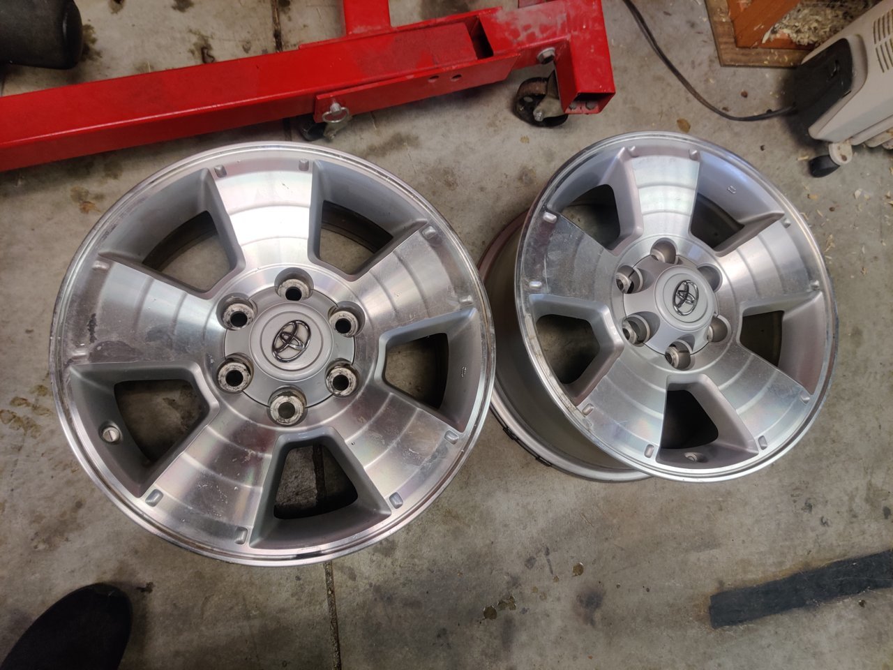

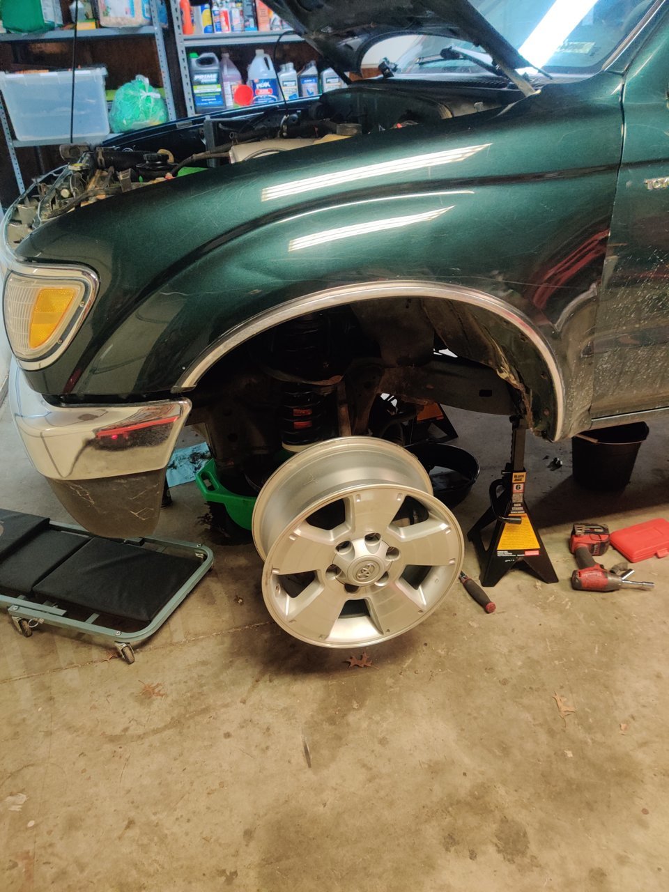

    Hello everyone I'm trying to get some information about running 2014 tacoma wheels on my 1gen taco.. I would like to run all terrain tires but I'm having a issue with choosing the right size because I don't the tire to rub the fenders.. if you have picts that'll be appreciate too..thanks ahead✌️

    Those wheels will work just fine depending on tire size. They have a bit more backspacing than stock (in the 5" range, vs. 4.5") so tires installed on them will have more of a tendency to rub the suspension and frame (without a small spacer).
    As far as tire size and what you need to do from a modification perspective - this page has a lot of info about the various bits that affect rubbing, and how to deal with them.
    What size tires fit my lifted Tacoma?
    In general - up to 32" tires, you won't have to do much. 33" will need a bit of relatively easy work, and 34-35 means cutting and welding.
